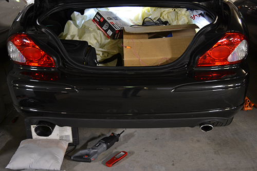

Hi all,
I've just completed this upgrade on my car with a set of Mina Gallery exhausts with oval tips which look the part (a little bit too big for my liking though). I love the mirror polish finish on them including the mufflers and not just the tips. I've even considered whether or not I should keep them polished up everytime I wash the car haha.
Anyway I've only had a few drives with the new exhaust and maybe I have over sensitive hearing because I'm not old and grumpy yet, but the note coming from the exhaust is just a little bit too loud for me. I haven't tested the car on highway speeds but I really hope there is no drone in the cabin. I've even had to resort to putting a movers blanket in my car to absorb some of that long frequency grumble.
Just wondering if anyone else has had the same issues with noise?

YES! Thank you, finally someone understands this! I was made fun of on here for wanting to polish them up all nice again like when I got them hahah! But seriously, they are that pretty. I need to wash my car soon
Anyway I don't think this helps you at all but here is a decent clip of my exhaust, mina mufflers and deleted stock resonator. I feel it is too quiet for my taste haha, but I'm sure I'm in the minority.
https://www.facebook.com/photo.php?v...89514586135549
lancervi50 you could try adding a small resonator, in addition to the stock one to soften the mina's a bit. Just a thought.

I did, especially with the first sports mufflers I had fitted. The Mina Gallery ones are noticeably quieter, however...
Here's a collage, in chronological order, of what I've had. First is original, second is Adamesh, the next 3 are Mina Gallery with different tips. The first Mina Gallery tips were quite alright for me. However, the second tips made the exhaust note noticeably louder. I did some googling and reading, and found out that not only does the shape of the tip matter (makes perfect sense though, think of a trumpet), what makes the most difference in in-cabin noise is how far the tip protrudes beyond the rear bumper.
Originally, those 2nd Mina Gallery tips were flush with the rear valance, and I found them unbearable. When I took them out as much as you see in the pic, it improved things quite a bit, though still not enough for me. The last pair I got from eBay, with intent to see how much a non-megaphone-shaped exhaust tip that sticks out quite a bit affects things. At first that one was very nice, but over time I've gotten more accustomed to it and the quieter noise has started bothering me slightly as well when cruising. I do like the looks though, they are quite small and restrained.
One guy on the UK forum said his new custom exhaust was too loud for him (especially the low-frequency noise, which can probably be described as "boomy"), and the shop added baffles inside the exhaust trim. Just a single baffle per trim, blocking about half of the airflow area in one spot, was enough to make a drastic difference. I'm currently looking into trying different baffles as well as possible the washer mod.

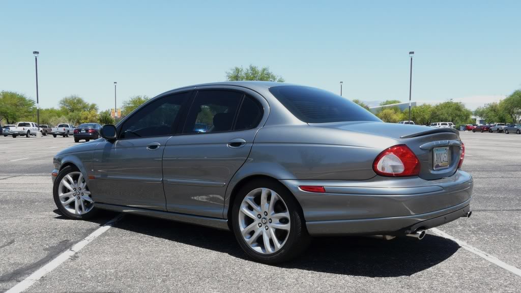

I went simple and spent $250 to cut off the stock mufflers (over engineered, large and heavy Jag mufflers) for light weight MagnaFLows and slightly bigger chrome tips.

Aonsaithya, Justink and Patterson thanks for your suggestions. I also did a bit of research and the consensus with the tip extending out of the bumper seems to be quite true. I'll have to put mine out a bit more and see if there is any difference. If I still can't stand the noise then I might go for the circle mina gallery exhaust tips.
Thanks for the help!

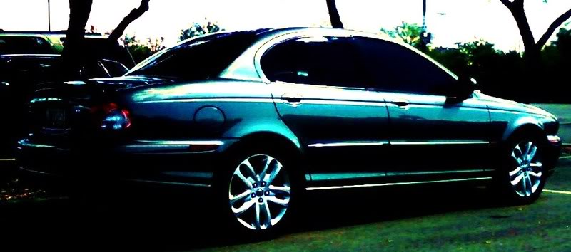

Here's a picture of my car on crack:
Sorry homes, same stroke on the 2.5 and 3.0, bore is larger on the 3.0. Not sure about camshafts.
