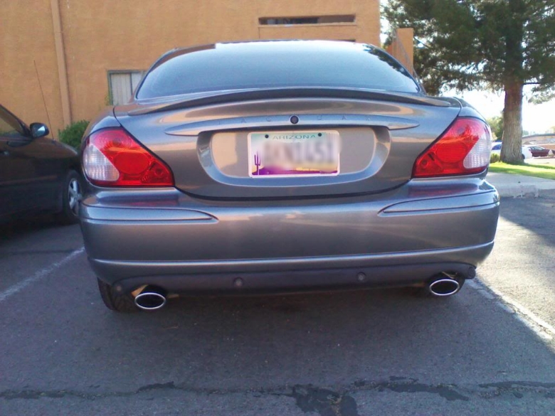

I put MagnaFlows on my X and it sounds great. The sound actually got better with a little age, grew deeper. They were $70 per muffler on Ebay and they are much lighter and smaller than the stock mufflers. I believe the pipe diameter is 2.5" or 6.5cm. Here they are on the car.

Actually I believe the stock pipe is 2 inch. Note that it would seem who ever installed your magnaflows (I'm guessing they had 2.5 inch inlets) also installed step down(up) pipe between the stock pipe and the mufflers. Not that there is anything wrong with that setup.

Justink, you're correct. The stock pipes on the X are 2" and the Magnaflows I bought have 2.5" intake pipe so the muffler shop made up adapters. If anyone is interested the Magnaflows I bought are model 11226. They should be 2 for $150.00. At the same time I replaced the tips with similar style to stock, but larger size.
The Mina and Borlas are on the order of double the cost or more, but they come with the tips, and will probably out last Magnaflows.
