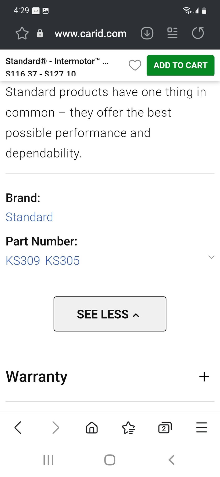

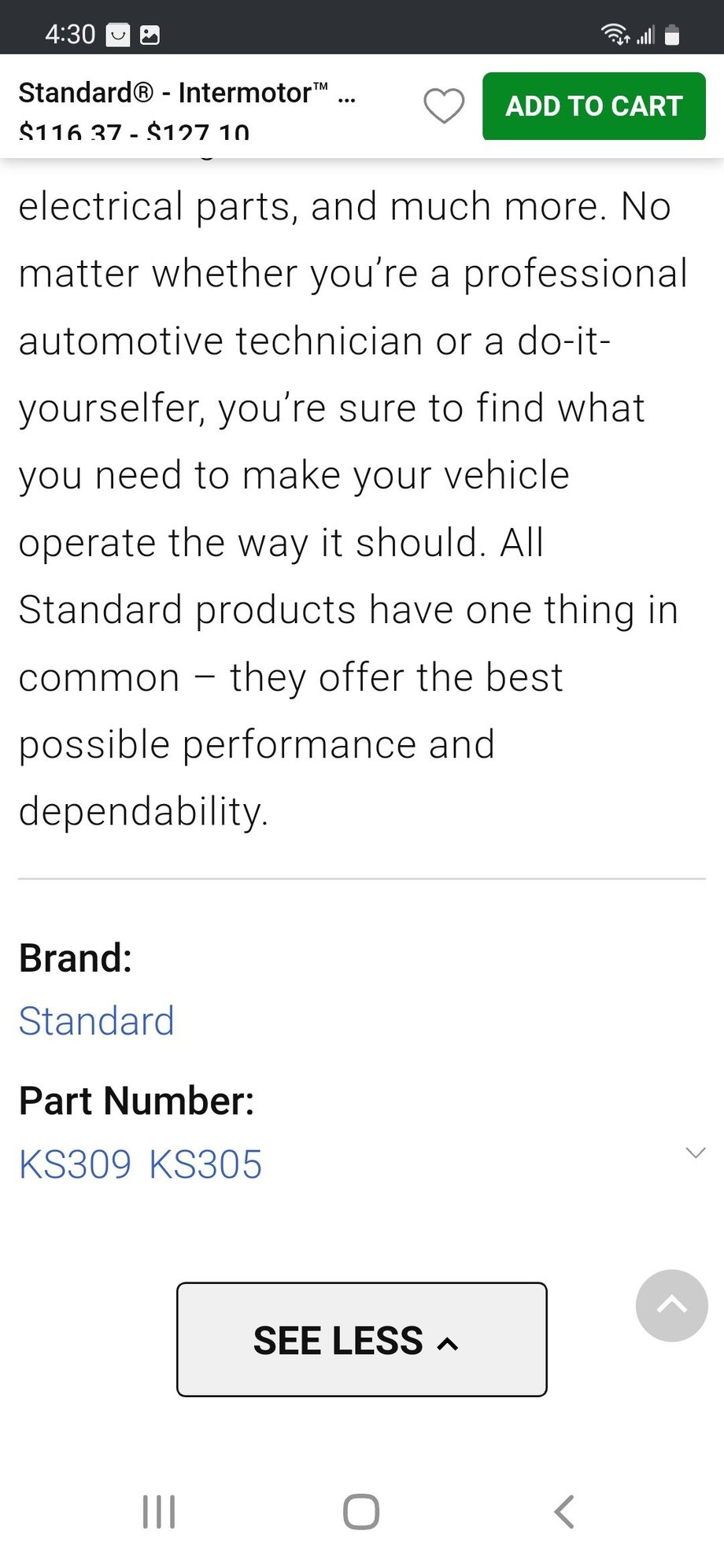

CarID lists the same part numbers for both 2.5 and 3.0
2.5 =
3.0 =
