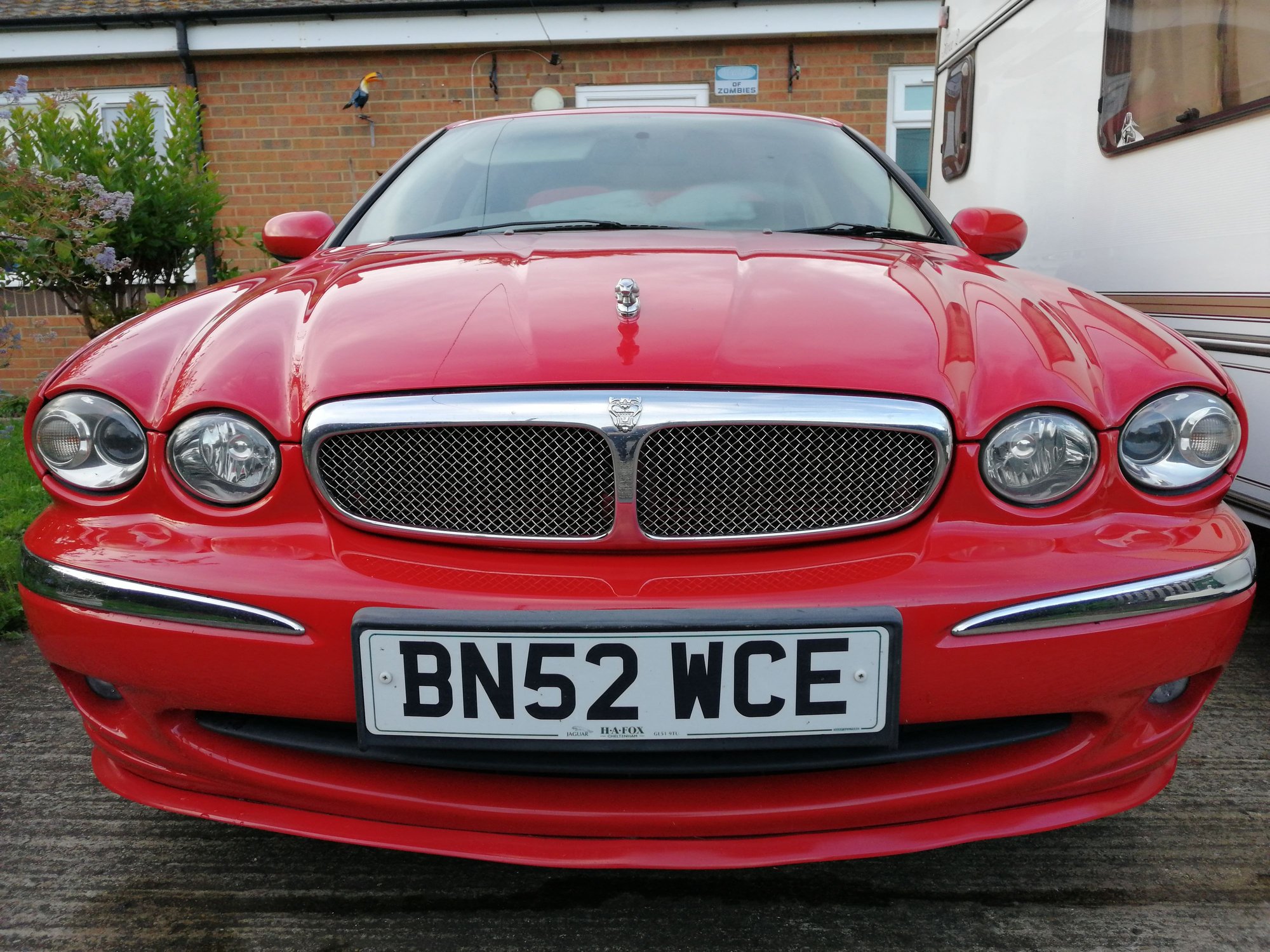

New to this but need some help with my jag when I'm driving I've started getting what feels like engine miss fire the ems light flashes then goes off then drives ok but it starting to do it every day now I have no codes coming up, could it be coil packs I've checked for air leaks and can't find any
How do you check the coil packs with a meter and what pins do I use and what ohms should I be getting also could this be spark plugs
Jaguar x type 2002 2.1 petrol
