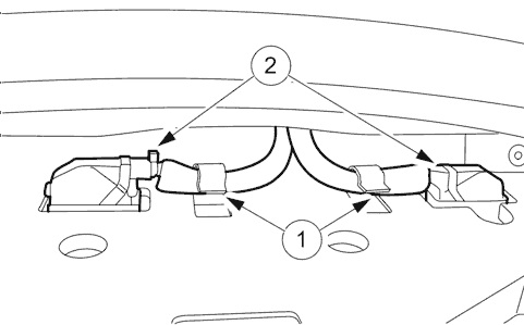

I replied to another of your posts asking whether the Instrument Pack light sequence check was running at startup. From you comment here, it seems it may not be.
This could be due to the two Instrument Pack harness connectors (item 2) not being seated:
The connectors on the back of the Instrument Pack have locking clips to ensure positive connection. Loose or damaged connectors cause many strange faults.
