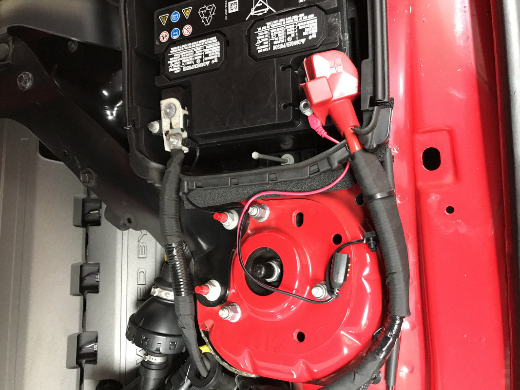

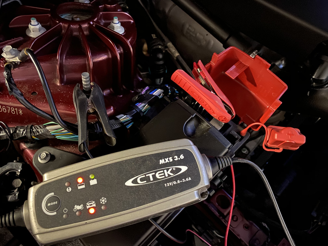

Just add a little visual aid to Doc's post.
This is how I hook a CTEK up to our XE. Positive connected to the remote positive terminal, negative clamped to the shock tower bolt.
For a permanent connection, I have a CTEK adapter fitted to my Mustang, makes it very simple to hook up when needed.

Thanks DB20 that is very informative just what I was looking for and thanks for your photographic work !

Just what seems a dumb question but the pics appear to be from under the hood but my battery is in the boot (trunk)

Yes, but the photos show the positive terminal inside the engine compartment that connect to the battery. So you can charge by couping to this and coupling the negative to any negative point on the car, like an earth.
That spiral looking post shown in the pic is a dedicated negative/earth point for battery charging and it serves no other purpose, so no need to go hunting for any other earth point. I have attached a permanent charger pigtail lead to the engine bay posts in my F-Type and it was a piece of cake attaching it to that post (via a supplied pigtail lead with circular attaching points on the other end), the post simply screws off, you slip the circular attachment around the bottom end then screw it back on.
Permanently attaching the positive end was a little more difficult, I drilled a hole in the positive terminal (soft aluminium so not too taxing) and used a 10 mm washer, bolt and nut to hold it on nice and tight.
I then fed the pigtail end out under the side of the car and tucked it up under the edge of the bonnet/hood in a spot where it doesn't fall out but is easy to flip out when needed. I can now connect my tender/charger in 20 seconds flat without opening anything or even needing to unlock the car!
