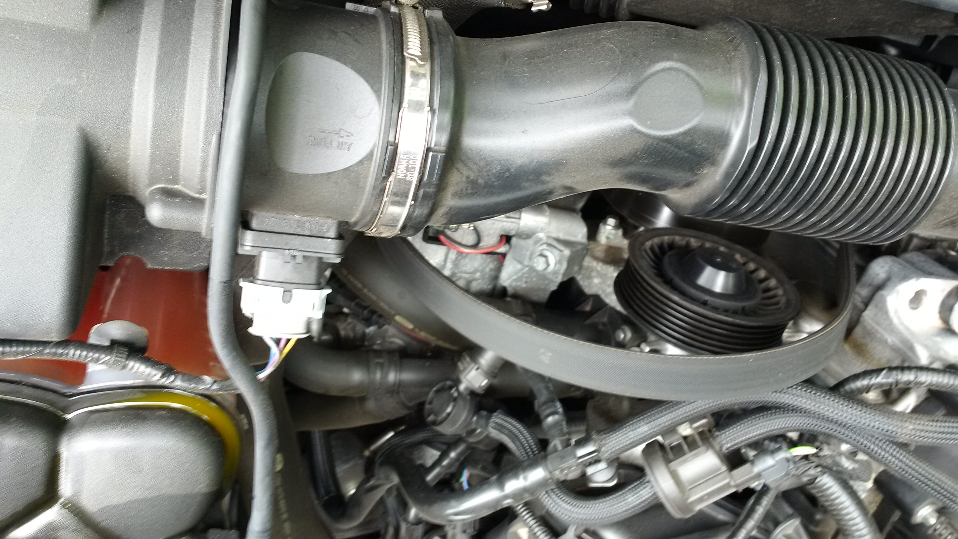

thismorning started as normal - heading into work at 5AM and about half way there -got a Charging system error battery not charging shortly followed by an Engineoverheating warning.
immediately pulled over and shut her down, popped hood,could see no plumes of steam but fans running in fast speed. Let enginecool down and started her back up - all looks normal so start to head out onlyto get both warnings so immediately pulled over and shut her down.

Popthe hood and find that the serpentine belt has freed itself?????? Not sure how or why but for Jaguar service toinvestigate

Pretty weird. If the failed belt was driving your water pump, that could certainly explain the engine overheating right?

alpha - indeed my thoughts as well. funny thing is I drove the hell out of her the past few days while my daughter was in town for Christmas - never had any issues

looks like I will be in the rental through next week - there is a bulletin regarding noise complaints coupled with the charging system issues/belt coming off I experienced so they ordered the associated pulley and will replace when it arrives next week.

finally got the car back Tuesday evening - they replaced belt, pulley and tensioner just to be safe. Also added a tow eye to the tool kit. Drove her home with no issues but left her parked in garage while I'm away for a few days. Their best guess was the belt stretched but could no real cause for the issue. So I will monitor and pray it doesn't happen again!
