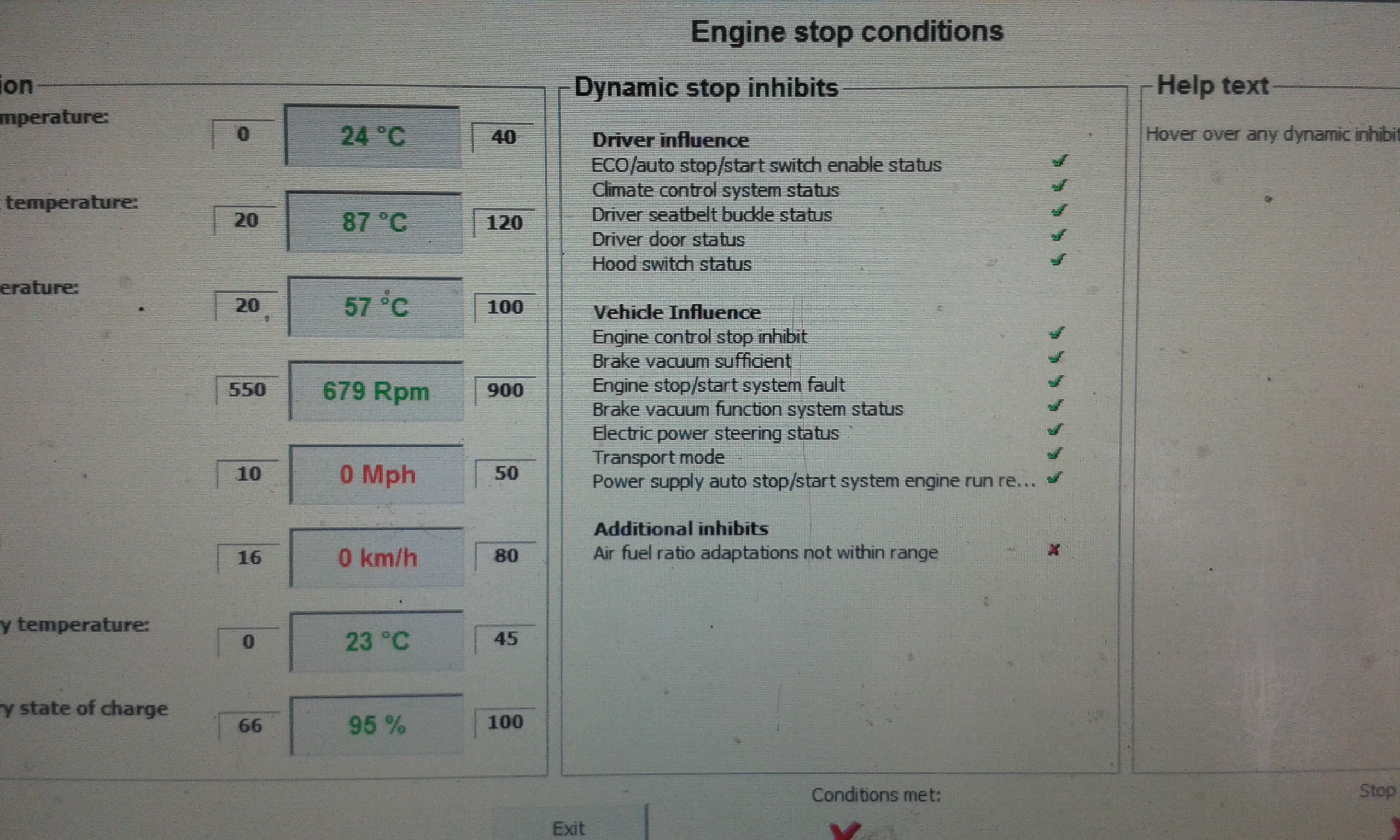

+1 oldpunk - also to add, the battery state of charge must be above certain threshold before it will work as well. Driver's seat belt must be fastened, hood closed, etc. There is a ECO STOP/START health check the dealer can perform to see if it stops working completely. It's designed to keep customer/occupants comfortable if running A/C or Heat, as this will take priority over ECO Stop/Start. See attachment for an example of what items can influence ECO Stop/Start.
As for the screen issues - there have been multiple software updates released to correct many things. This has been on going since release of InControl Touch Pro systems.
Since your vehicle is most likely in warranty - raise these issues with the dealer. I'm not sure about the NAS market, but where I currently live ( Auckland,NZ ) we are not supposed to be doing any software updates as of December 2017, engineers are working on a new update, this may be the same for North America Market.
