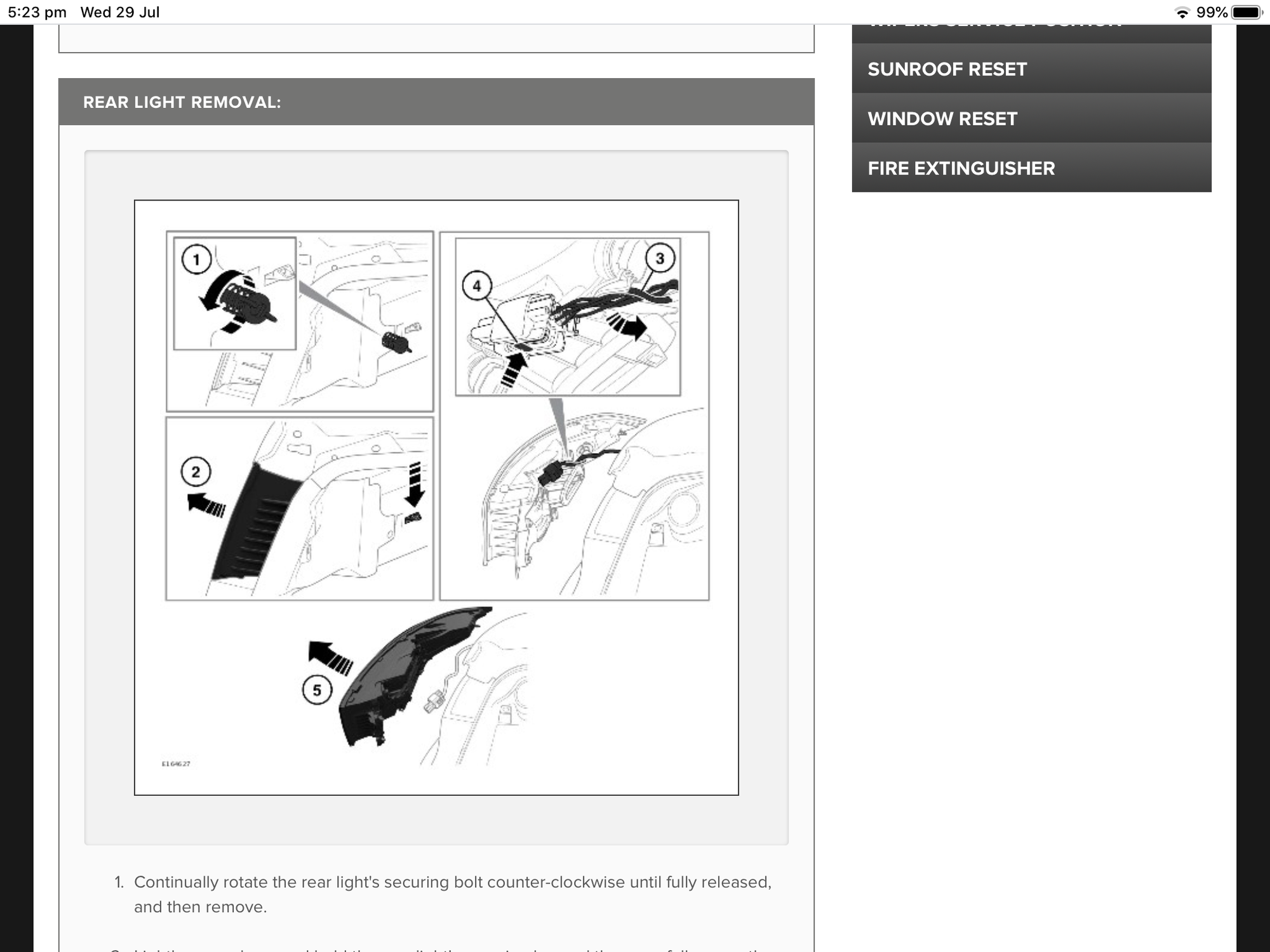

I haven’t needed to change one yet but a search shows that the light cluster needs to come out ......
Im sure someone else will chime who may have replaced one.

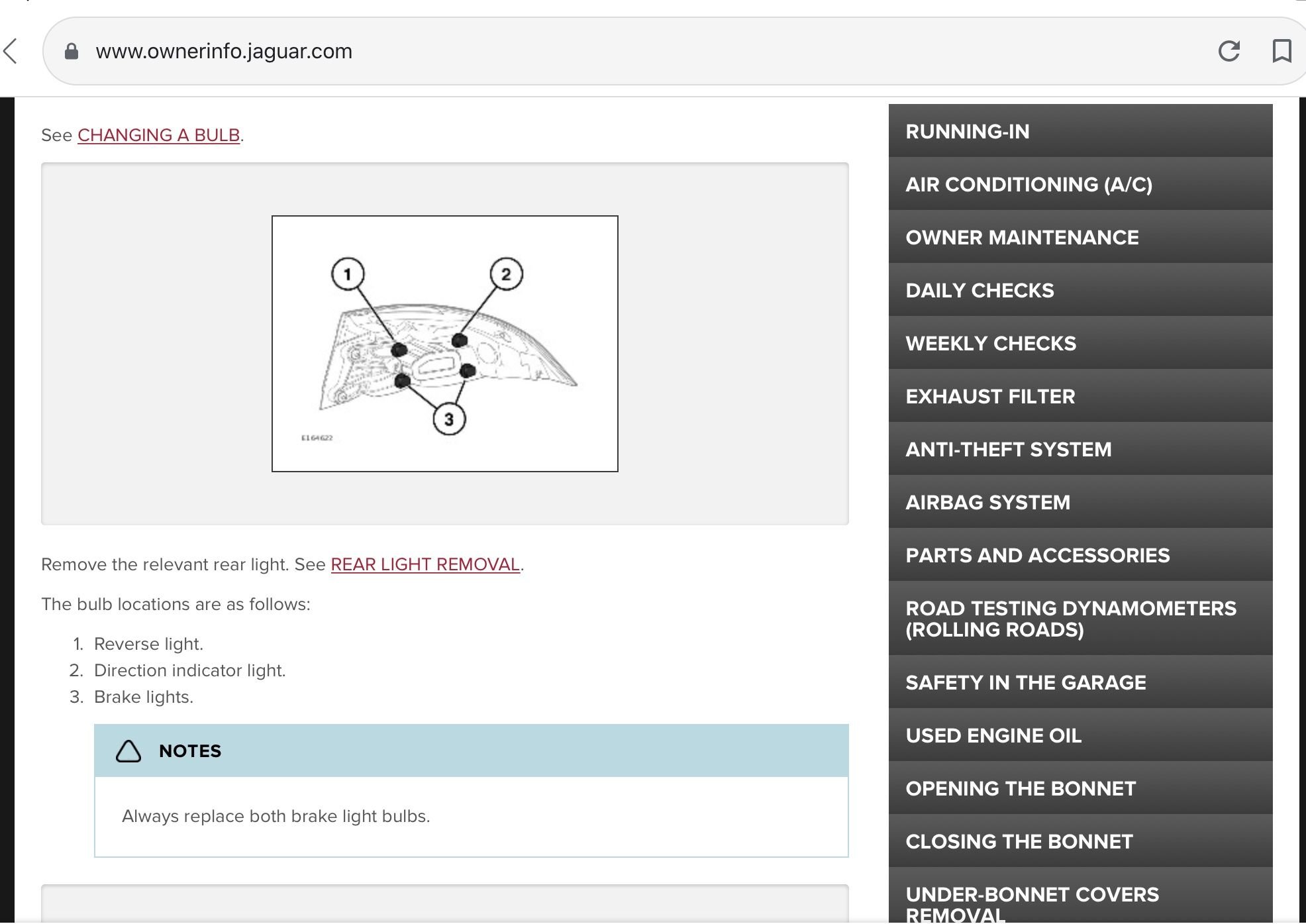

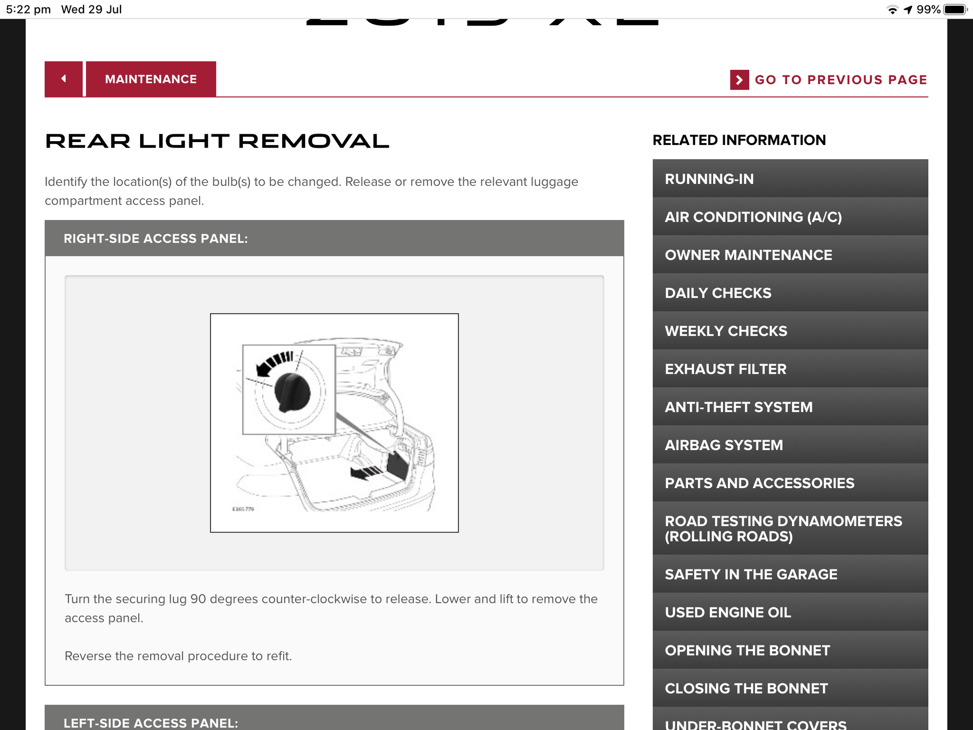

From: Austin
I swapped one of mine just over a month ago using the images/directions @Daf11e shared... less than $5 and under 30 minutes and a couple of minor swear words. It is weird taking the entire light assemblyoff, and an odd angle on the right side of the car with the fuse panel, but it's not that hard. You can do it!
