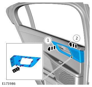

Hello, can someone tell me how to remove rear door panel?
Thank you.

REMOVAL
CAUTION:Use a suitable trim tool.
NOTES:
  • This procedure contains some variation in the illustration depending on the vehicle specification, but essential information is always correct.
  • This procedure contains illustrations showing certain components removed to provide extra clarity.

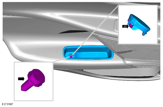

  1. Remove the rear door interior handle trim.
  2. Remove the bolt.

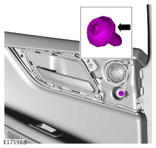

    • Remove the access cap.
    • Remove the bolt.
    • Remove the rear door stowage compartment trim.

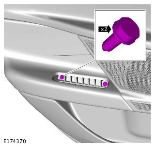

  3. Remove the 2 center bolts.

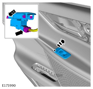

    • Remove the rear door window switch.
    • Disconnect the electrical connector.

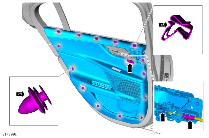

    • Release the 9 plastic clips.
    • Release the 5 clips at the top of the door trim panel.
    • Release the door trim panel inner handle cable.
    • Remove the rear door trim panel.
    • Remove and discard the 9 plastic clips.
