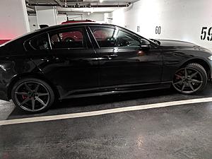

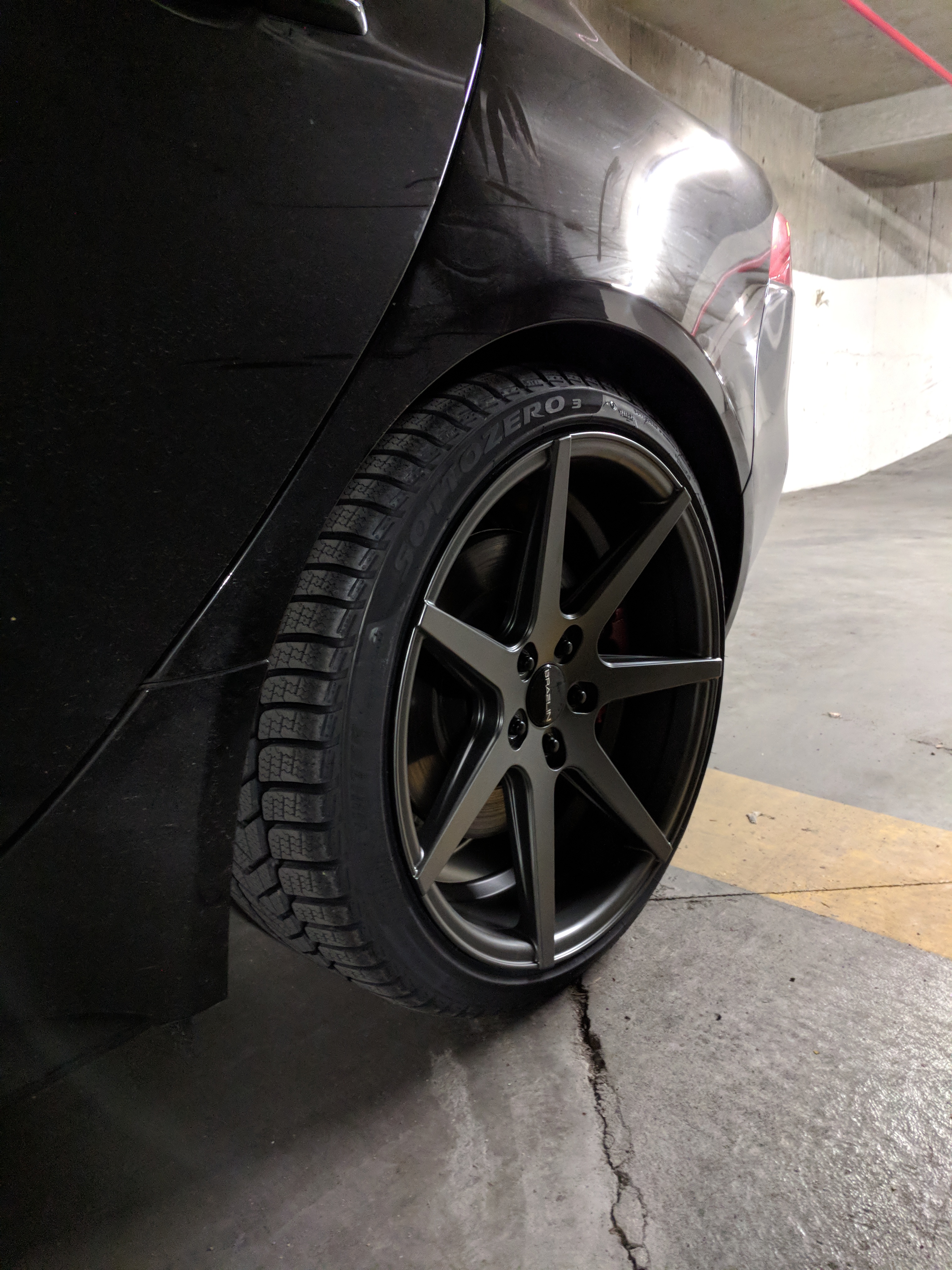

Old Dec 29, 2017 | 12:07 PM
avinaash's Avatar
Joined: May 2017
Posts: 35
Likes: 8
From: vancouver bc
finally found and got some 19" installed
went with braelin rims- gun metal grey in 19" offset and pirelli winter sottozero 3 tires
i am quite happy with them and love the ride with the ticker rubber.
