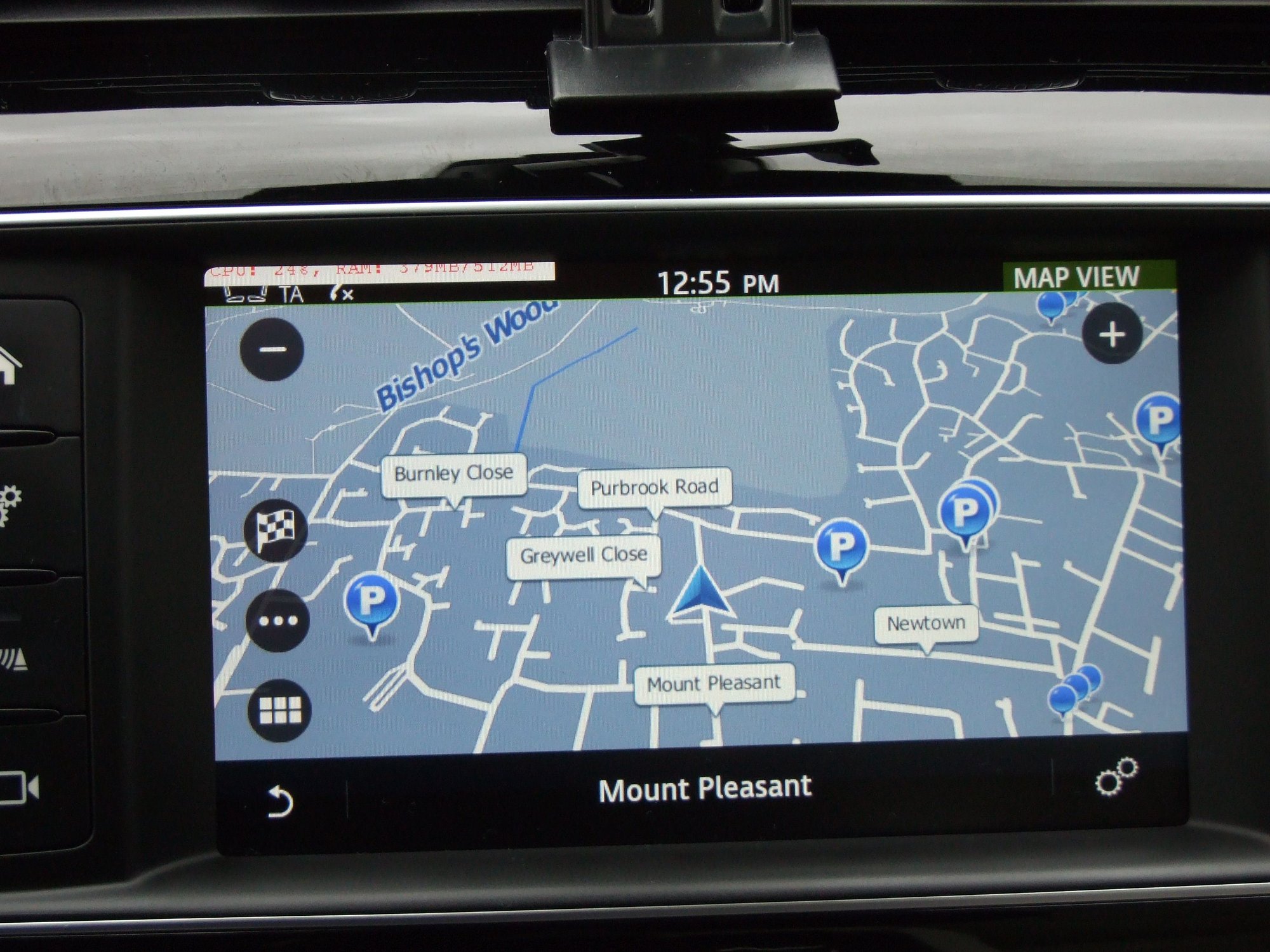

Hi, I am new to the forum. So hello to everyone. I have a late 2016 Jaguar XE 2.0L automatic diesel with 65,000 miles on the clock.
Just recently a long narrow window with a white background and scrolling red text appeared in the top left corner of the touch screen.
The text is continually being updated with: CPU usage, Memory usage and Available memory. I am not sure if this information is from the car CPU or the entertainment centre. Possibly the GPS system.
I don't know why this has suddenly appeared and cannot think of anything I did to cause it to appear. I have a ANCEL LD700 OBD2 hand scanner, which includes additional Jaguar service modules.
Both the OBD2 and Jaguar vehicle scans show no error codes. I have tried removing/replacing the GPS map SD card. Disconnecting the battery, twice. Once for 15 minutes and the second time for 35 minutes, but the message window is still there.
The car is running great. It is just that I find the message window annoying, especially as it partially obstructs the heated seats, phone and other icons which reside in this area of the screen.
My question is, has anyone experienced this problem and if so how did you solve it. Any help on this would be appreciated.

Can you post a photo of the screen please

Post
Here is the screenshot you requested. I have purposely made it large so you can read the text which appears in the white window.
The text is displaying the CPU load and Memory information. And is updated in real time.
Once the ignition is switched ON. The window is permanent and displays in all screen options.

That's an interesting defect, have not seen it on a car through the shop in my time with JLR. Does the car have anything aftermarket in the infotainment system, such as a bluetooth/carplay add-on? I would assume you have a corruption in the infotainment module or screen if not. The screen is just a "dumb" display on this vehicle, not it's own module, so it should just be displaying the information it's getting from the IMC. That is not part of the normal engineering screens or any data we can access with SDD usually.
