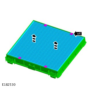

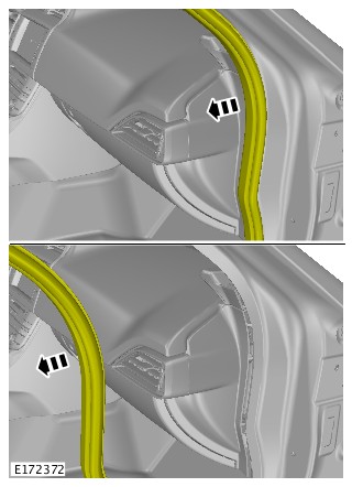

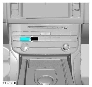

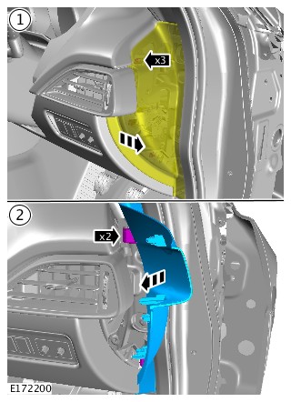

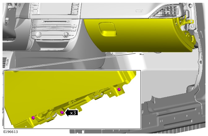

REMOVAL
  1. WARNING:Make sure that the blower motor speed is in the minimum position. Failure to follow this instruction may result in personal injury.
    CAUTION:Failure to carry out this step correctly, can result in damage to the recirculation motor/flap.
    1. Refer to:Control Components (412-01 Climate Control, Description and Operation).
    1. Switch ignition on.
    1. Press the recirculation button for three seconds to set the climate control system into to recirculation mode.
  2. Refer to:Glove Compartment (501-12 Instrument Panel and Console, Removal and Installation).
    PUBLISHED: 25-AUG-2016
    2017.0 XE (X760), 501-12
    INSTRUMENT PANEL AND CONSOLE
    GLOVE COMPARTMENT (G1842187)
    REMOVAL AND INSTALLATION
    • 76.52.03
    • GLOVE BOX - RENEW
    • ALL DERIVATIVES
    • 0.20
    • USED WITHINS
    REMOVAL
    INSTALLATION
    1. To install, reverse the removal procedure.
INSTALLATION
