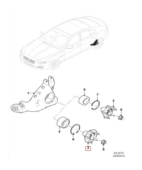

Useful to know this isn't an isolated incident. The diagram from the Parts Catalogue shows why this is an expensive repair.
The studs are likely to be the standard splined pattern which are pressed or driven in from the rear.
There clearly isn't sufficient space between the back of the hub and the hub carrier to drive out a broken stud and fit a replacement so the hub must first be removed from the carrier.
