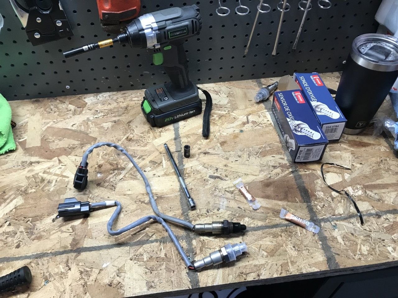

Default update to the P0062 HCC bank 2 sensor3
Total of 3 sensors on each bank. Total 6
Location is just under the drivers seat. You will need to purchase left and right, they have different connectors.
Tools required. 8mm socket to take the sheild off and a 22 mm 02 crow foot wrench and 30min of your time

Very easy job !! ending 94 (right) and 92 (left).
You might just want to pull them off and clean them with Carb cleaner or just as easy to replace. !
