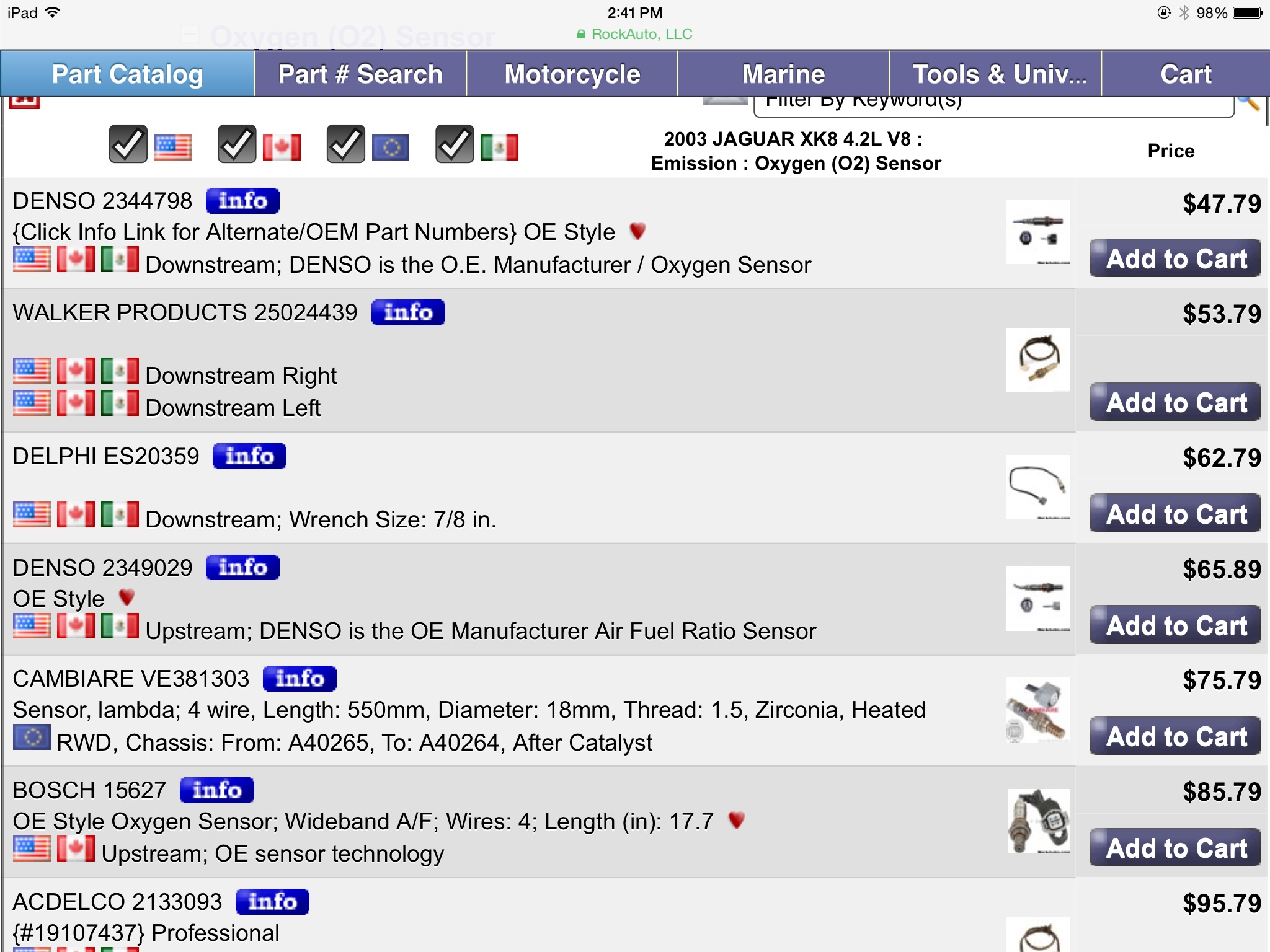

Here's what Rock Auto lists, any one better than the other?

In my opinion, there is not much difference between the lowest priced and the highest priced. No one ever publishes such things as mean time between failure.
If it works, it works and will probably will continue to work.
