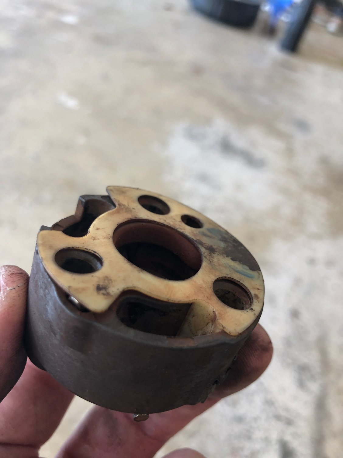

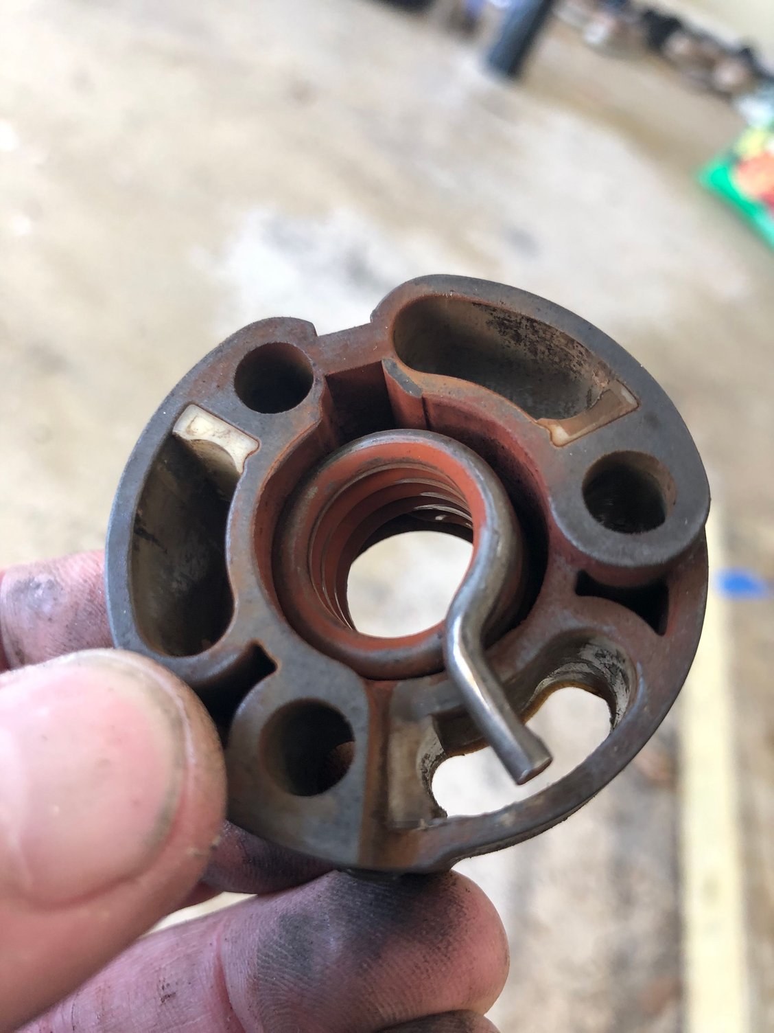

I just wanted to post up a pic of my engine mounts after 145k. I was recently hearing a lot more odd noises and feeling way too much road than normal. I replaced my mounts, which you can see were completely shot, and she is smooth again! Much quieter and since I finally replaced the SC coupler with a solid one, she shuts down without the dreaded clunk again. This time the coupler spring was still intact but it was ready to die any day. This was my 4th coupler over 145k miles so far.
