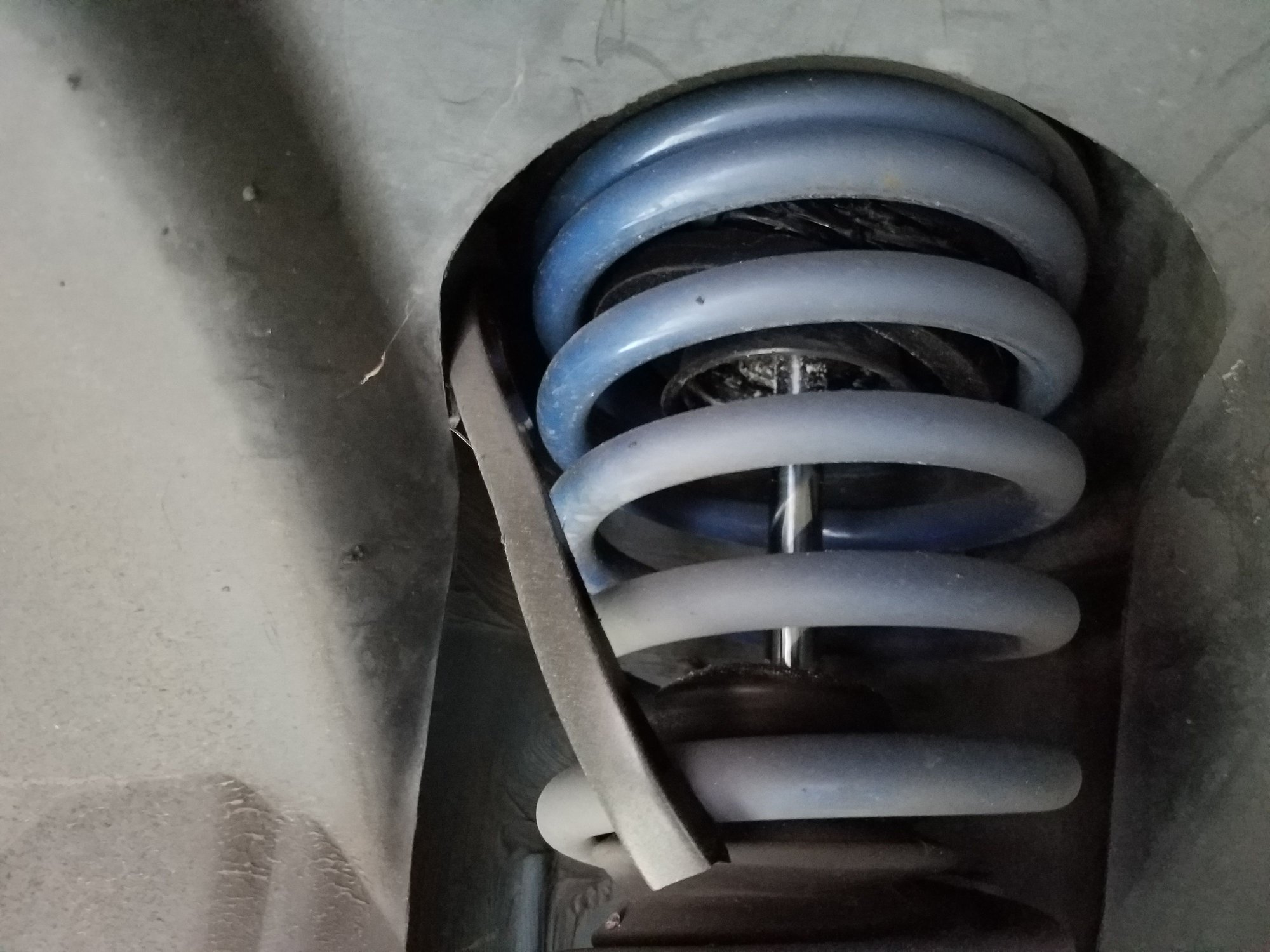

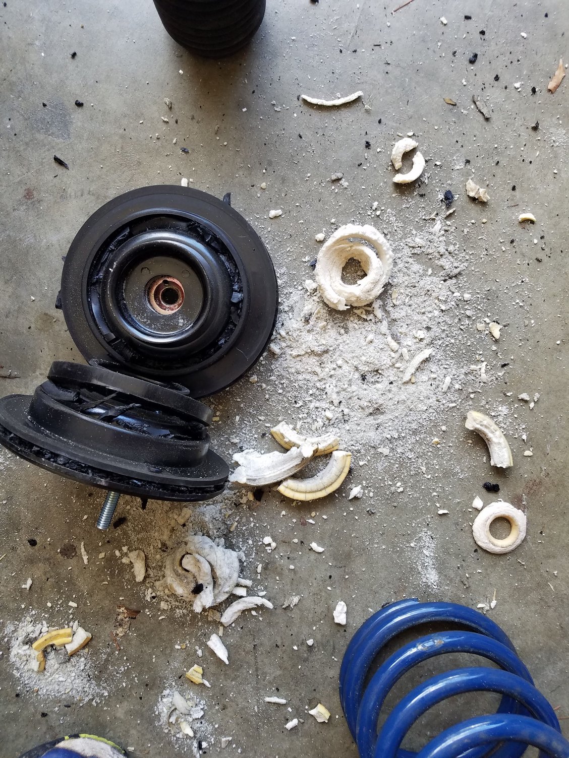

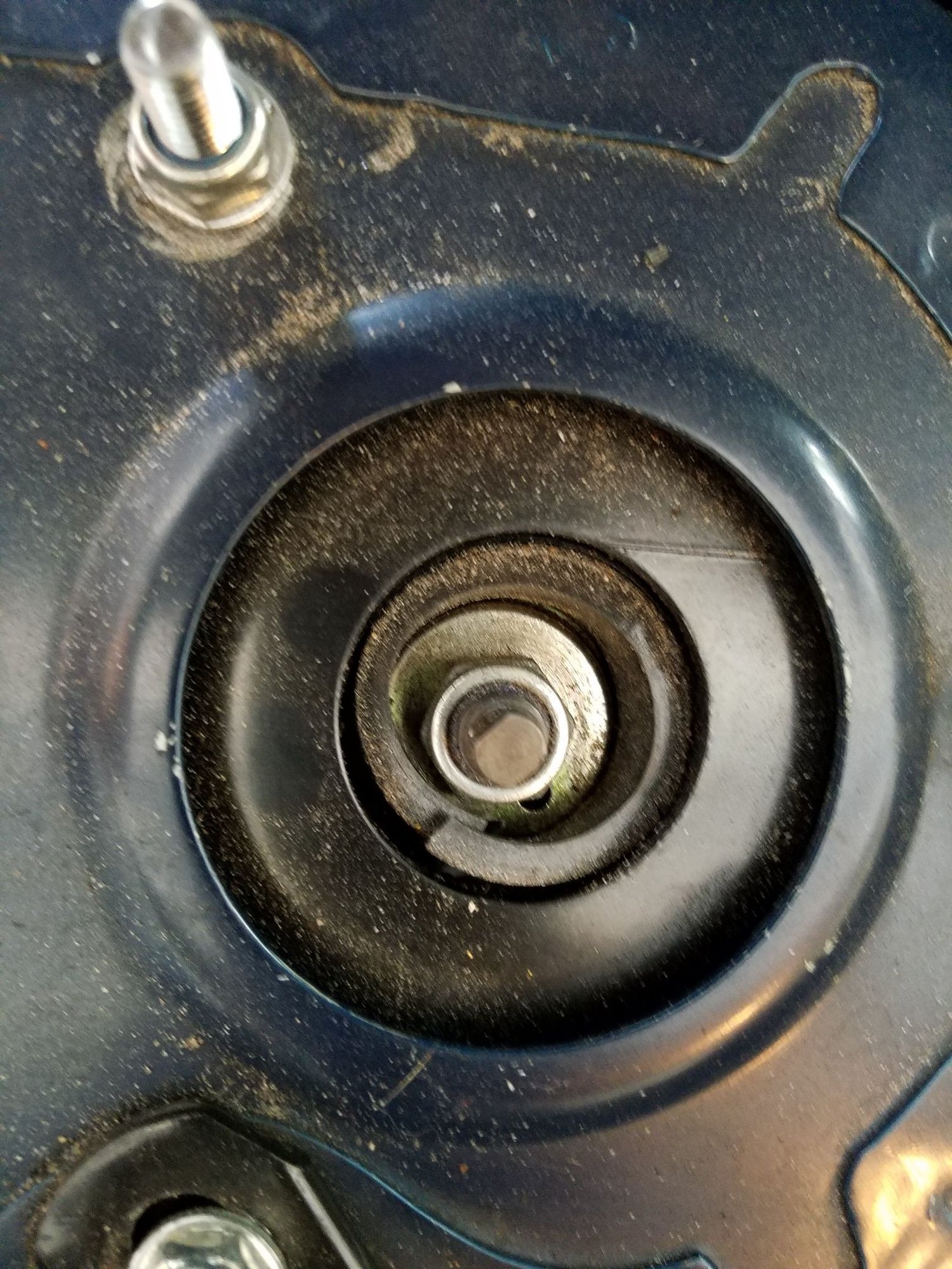

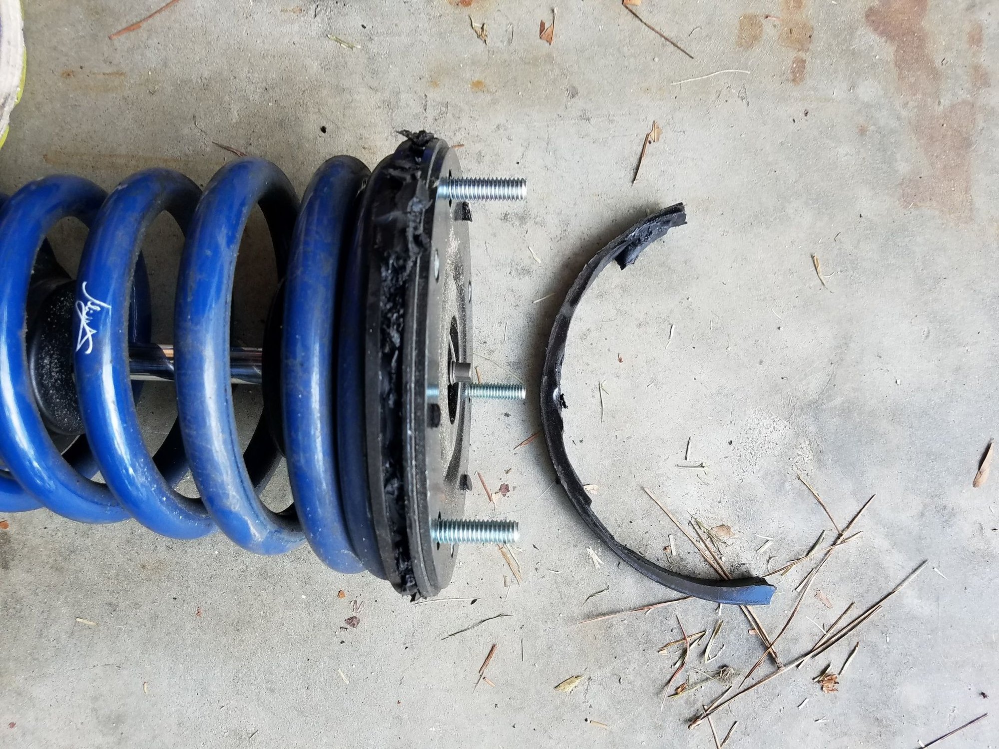

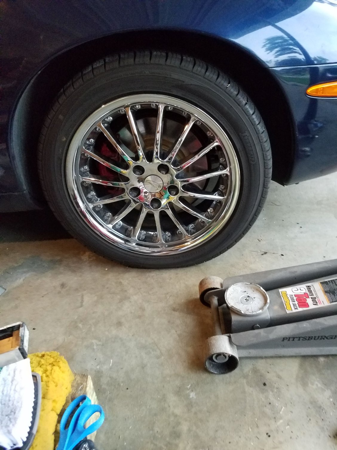

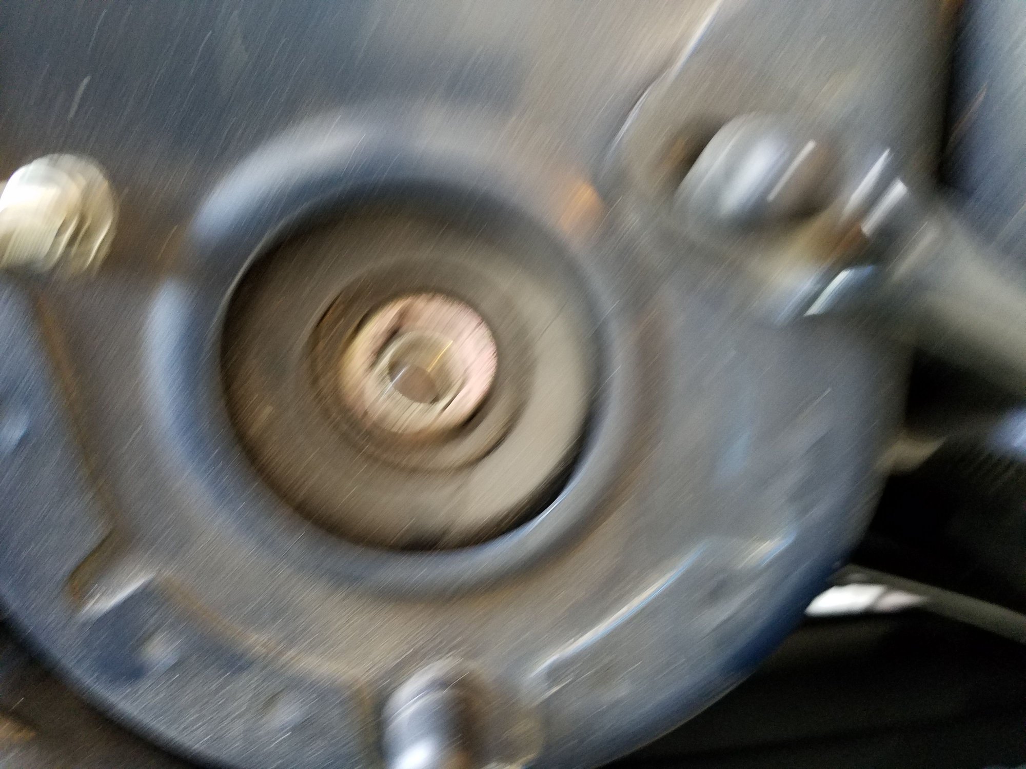

Well, haven't been driving the Mistress too much under the current situation but took her out a few times last week - no issues - ran like a charm. yesterday took her out, ran great, came home parked in the drive to unload the house pony, then pulled her into the garage. This morning, I notice a fairly large rubber-type material on the ground where the passenger side front tire would have been. Looks like the Welsh poly's finally bit the dust. Pulled her out of the garage and the passenger front tire is up into the wheel well and pretty close to rubbing the wheel well liner. Looked at the mount from the top and can see some cracks but it doesn't seem to be too bad. In any case - will be ordering new mounts to replace again.
Oct 2013 replaced original upper mounts (~110K miles on them) with OEM mounts
July 2018, those mounts failed at about 50k miles of use and replaced with Welsh Poly's
Aug 2020 - Welsh Poly's failed car at 186265 miles (just under 30k miles). Decisions, decisions - may just go back to OEM

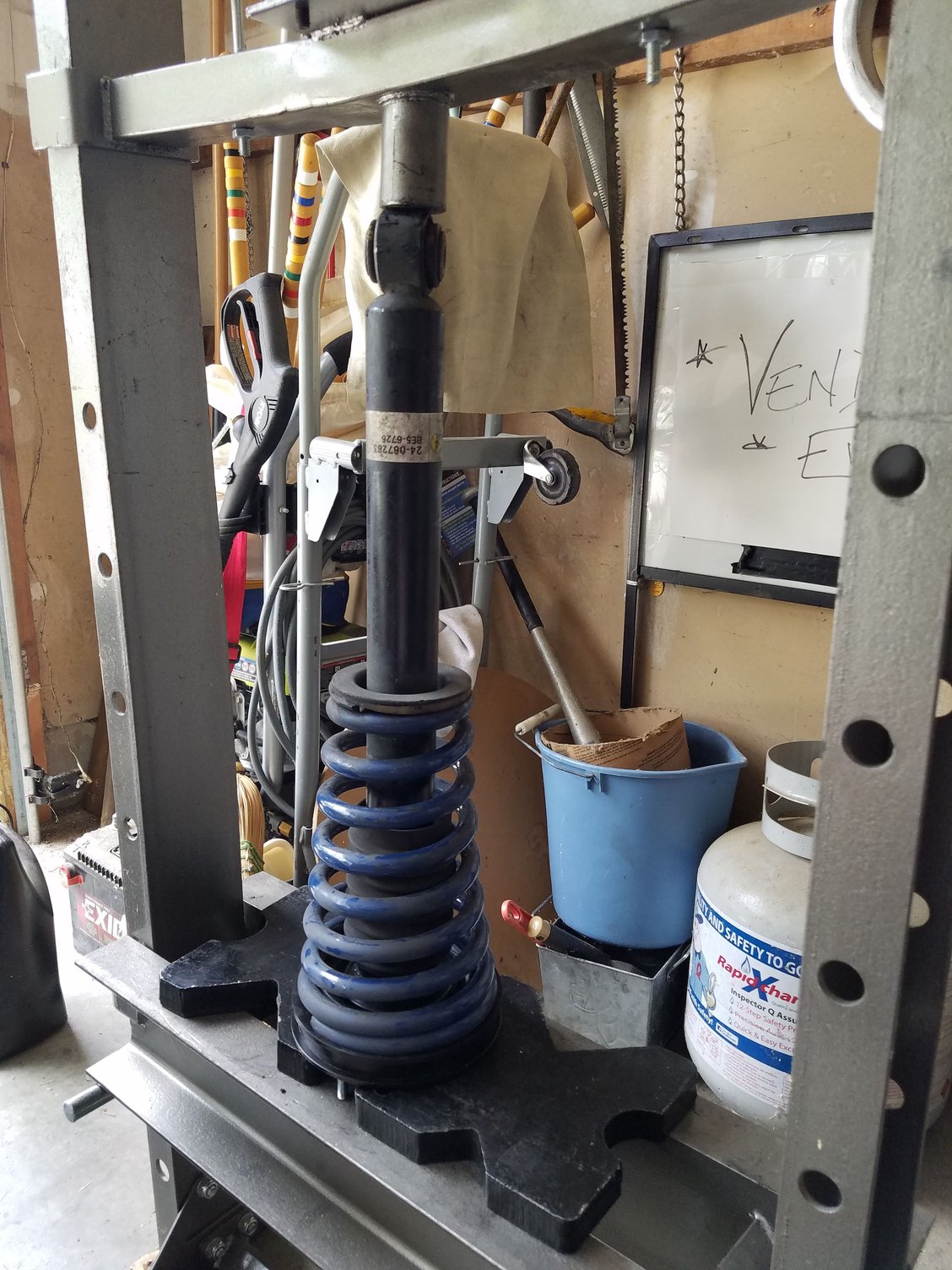

RJ - no doubt - just doing short term until OEM's arrive - too nice of a day to not drop the top and drive. Don't mind having to redo - only 2 hours time.
Who needs a spring compressor - 20ton press works just fine!!! and bump stops were powder - so had to run up the road to get a set

Originally Posted by sklimii
That looks TERRIBLY dangerous...!
