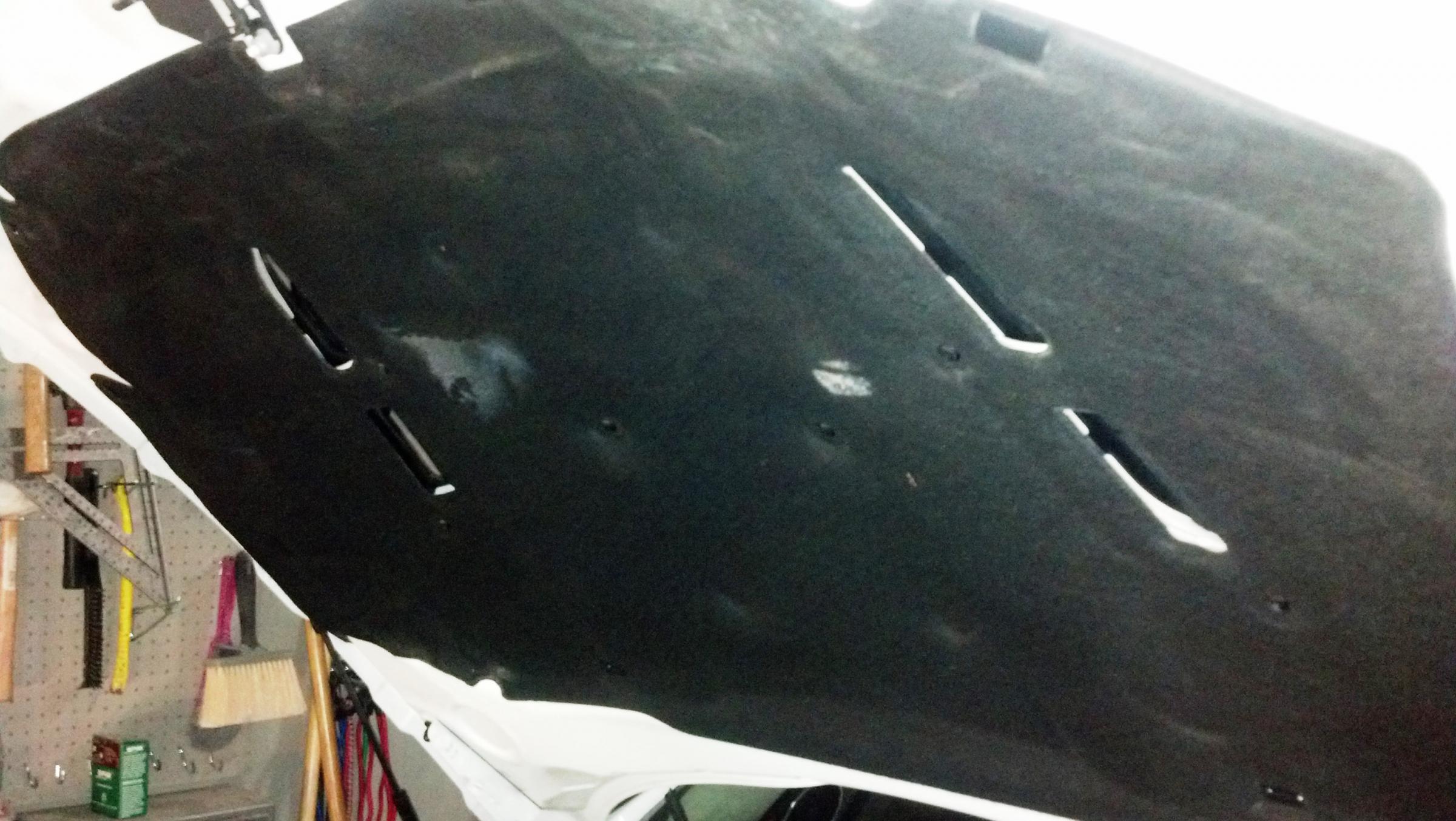

I have a 2009 XF SC and I am considering converting my front end. I know a few members have done this with insurance claims. If I were to buy, outside of the obvious, hood, and bumper cover. I know I can get the inserts to the hood but what about the hood liner? I found them for $134 but can I use my existing liner? Can any XFR members take some pics of there hood liner?

I'd guess the liner is different but hopefully someone will respond. If the vents are functional it would have to be different but you could probably use your stock liner and cut slits in it. Here are the costs I was given which are cheaper than normal dealer costs.

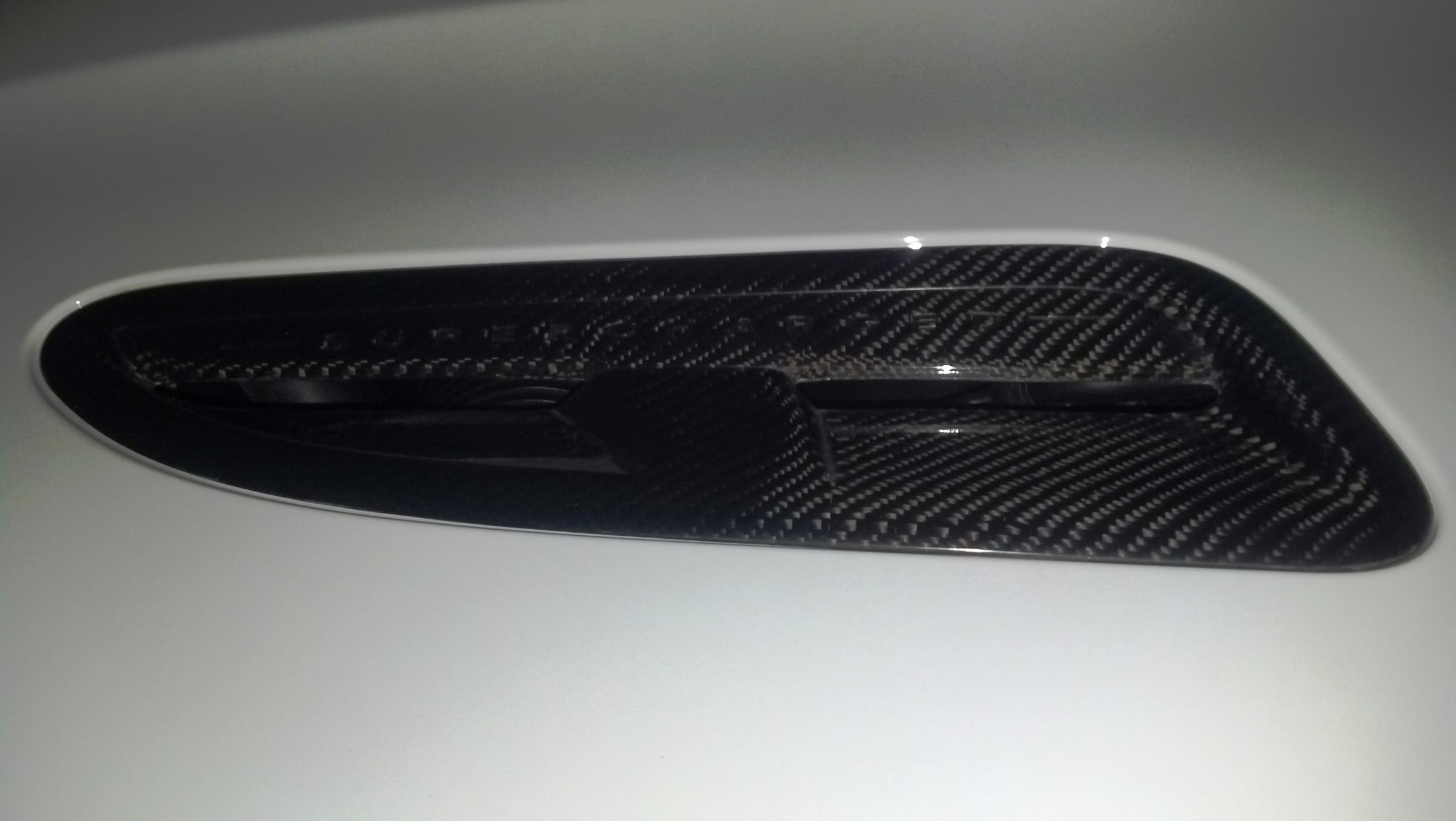

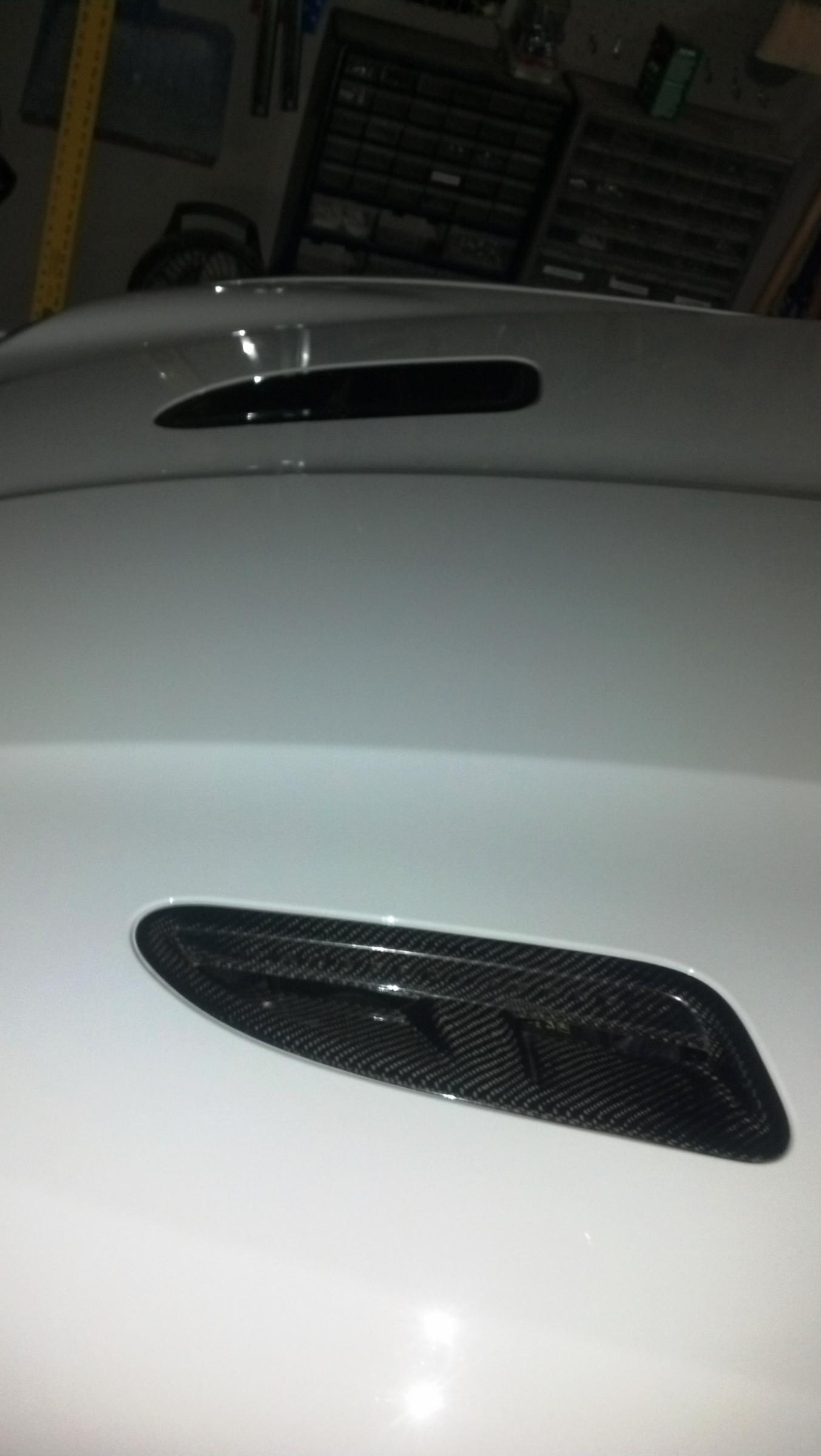

The hood louvers are functional, and the hood liner is cut out around them. A few plastic fasteners hold the hood liner to the hood near the cutouts. I popped my original hood louvers in and out several times to experiment with painting them, and I never had any problems. I eventually replaced them with the Mina Gallery carbon fiber louvers, though, which simply adhere to the hood.
