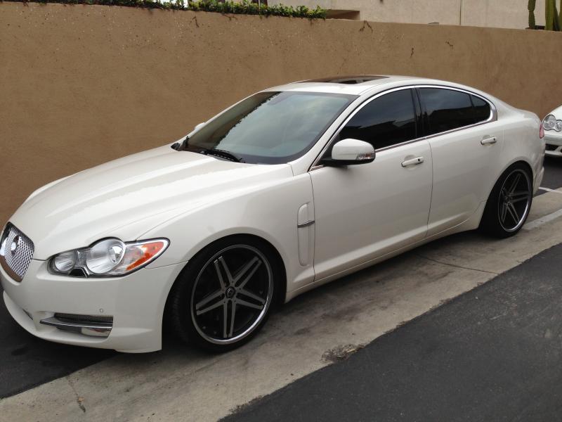

so just to be clear, you guys are saying the xfr front will fit just fine on the 09 super? that would be sick

Yup, it does. See my pictures.
