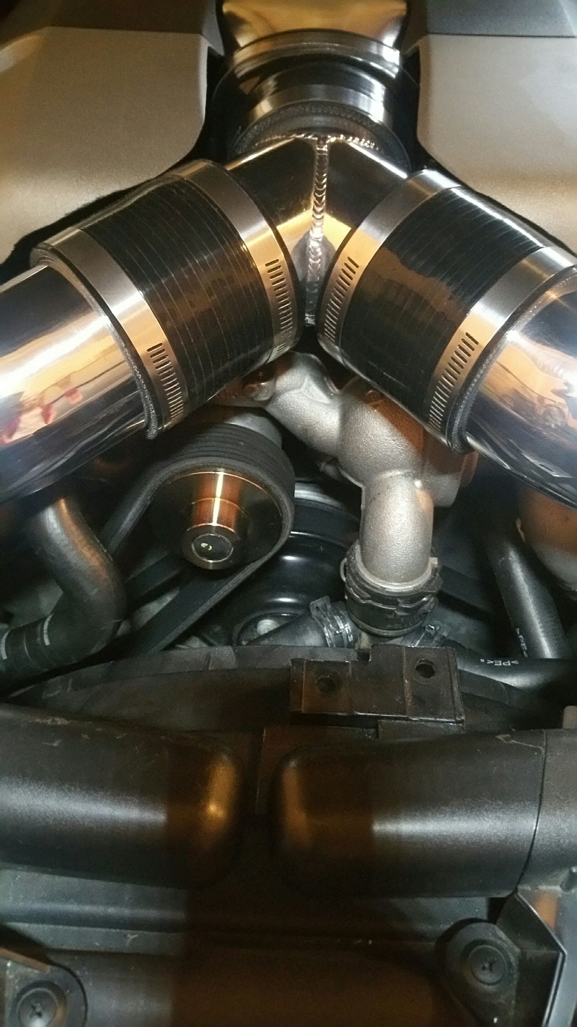

I finally decided to pick up a supercharger pulley for my XF from Powerhouse. I emailed the owner a few times and he has always been very responsive and knowledgeable. The 4.2L SC has two options for upper pulleys (1.5lb ~ 6% or 2.5-3lb ~10%). I went with the smaller pulley (2.5-3lb ~10%) so I could try to eek out a bit more hp. The only downside is that the smaller pulley requires the supercharger snout to be sanded/machined down.
Step 1: Remove Pulley

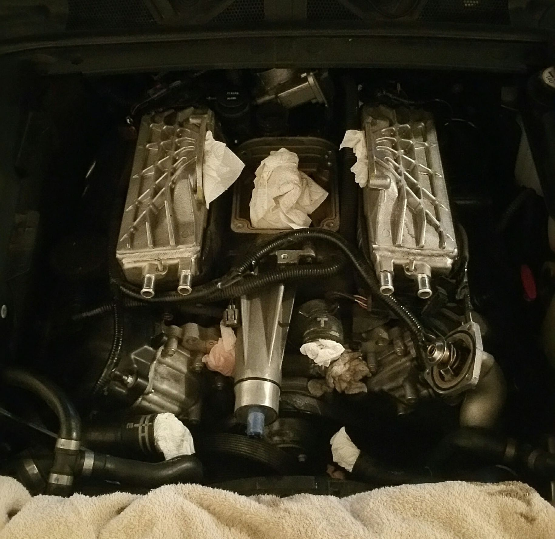

I covered the engine bay with towels and cut the old pulley off with a angle grinder. Powerhouse sends instructions describing how to cut so you don't cut into the snout. Last year I swapped pulley's for a local SC 5L so I had my old pulley off after about 15 minutes.
Step 2: Sand SC Snout
This is where things get a little nerve wracking. First off you need to mark how far back you need to sand to. I used a zip tie which worked out pretty well. I had to swap on a new one a few times after bumping it during sanding. I have a few power/air tools for sanding and I could only get access to the top of the snout. The instructions state that removing the supercharger isn't a big deal so I started down that route. I quickly realized that this is no easy task due to the limited room back behind the supercharger (horrible). 3 broken vacuum lines later (brittle to the touch) I decided to call it a night.
The next day I drained the coolant and removed all the coolant lines around the snout. This provided much more access to the snout. I have a Milwaukee Bandfile which worked extremely well. The only difficult part is knowing when to stop. Powerhouse doesn't send a die to test fit (others do) which helps you verify you cut enough material off. I think that is a huge mistake. I'd easily pay $50+ for that. I have a micrometer so I was measuring non stop. The diameter needs to be reduced from 60mm down to 54mm. Measuring from the shaft to the snout needs to be 17mm all the way around. The new pulley is 55mm inside so tolerances are tight.
Step 3: Install Pulley
I popped the pulley in my oven set at 550F. I left it in there while I ate lunch and had a beer (requirement) ~30 min. Using my oven mitts I grabbed the pulley and ran out to the car to slide it on the shaft. It slid on fine and didn't appear to bind. It cools fast so you need to: #1 make sure there is no binding and #2 make sure the end of the pulley is even with the end of the shaft. If the pulley binds remove it. Well after it started to cool it started to bind up. Metal shrinks as it cools so I guess I had a slight high spot that grabbed when it cooled. At this point a few swear words popped out. I let the pulley fully cool because there was no removing it. I sprayed some WD40 behind the pulley at the high spot and I was able to get the pulley to spin with a vice grips and a rag wrapped around the front of the pulley to prevent any damage. I worked it back and forth and I feel like I won the lottery because I was able to work it through that high spot.
Step 4: Reinstall Everything
I had to fix the vacuum lines which was fairly easy. I had some 1/8" plastic vacuum line from my other car projects so I removed all the brittle line and swapped in some new line. You do not need to buy new lines from Jaguar ($50). Go buy about 1-2 feet of 1/8" line from the store ($5) and cut it to fit and swap over the boots. Everything else went back together without any issues. Start up was nerve wracking because I didn't want to hear a metal scraping sound due to that pulley and that high spot. I figured it could have issues under load. However, it started up and sounded completely normal at idle.
Step 5: Butt Dyno
Woah, this thing moves now! It's neck snapping with the new pulley. There is no doubt that the pulley makes a significant change. It really kicks you into the seat now. It is mostly low/mid range power with this pulley as it is well documented that the M112 looses steam up top due to heat. I'm VERY happy with the results. My MPG has taken a hit but that is only because I have been making wide open throttle (WOT) runs every time I drive it. The supercharger really screams at WOT now.
Future mods: Supercharger porting appears to be hit or miss with the M112, especially the new revision in the XF. There is a lower pulley option available for the 4.2L SC to push the boost up further but there are clearance issues with the oil filter housing. EuroToys appears to sell the lower pulley with a modified oil filter housing but it's $1,200. As far as a dyno tune, I may look into that but I know the S-type R guys haven't had much luck in that area. I'm not sure if the S-type R also had smaller intercoolers like the early XJ/XK cars. Powerhouse sells upgraded intercoolers for the early XJ/XK and the owner stated the XF didn't need it because it came with a larger intercooler already. I would like to take some temp measurements and determine how hot the air is getting coming out of the SC. The larger intercooler pump others have been swapping in is an easy/cheap swap so I may go that route.
Thoughts:
If you don't have much experience working on cars. Get the 1.5lb pulley which does not require sanding. The snout sanding is a massive pain in the ***.
