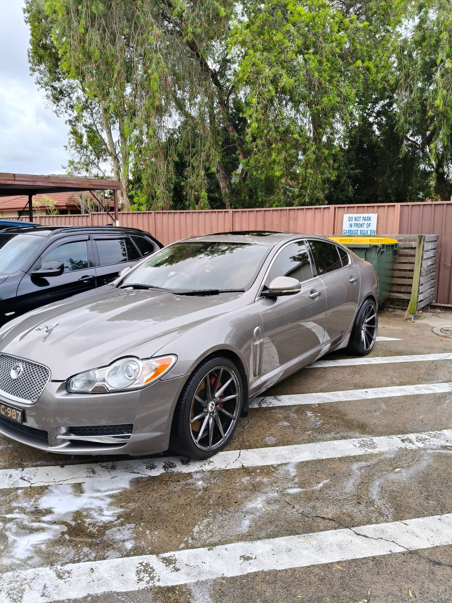

Hi and thanks for taking the time to read. I have a 2009 xf n/a V8. I am currently having no response from the start button I have had the gear selector and starter module sent away and reassembled to make sure it is all working correctly however I am still having no response from the start button when I unlock and open the door the radio and lights everything goes come on as normal but my cluster is dead and the start button is not responsive at all. I have disconnected the battery and left it for an hour and reconnected when I do this the start button flashes as normal when it senses the key but still does not respond when pressed. The only issue I've had with this in the past was sometimes the start button would take a few presses before you would engage and start never have I had it that the ignition does not even bring up the dash if anyone can please advise or help this would be greatly appreciated
