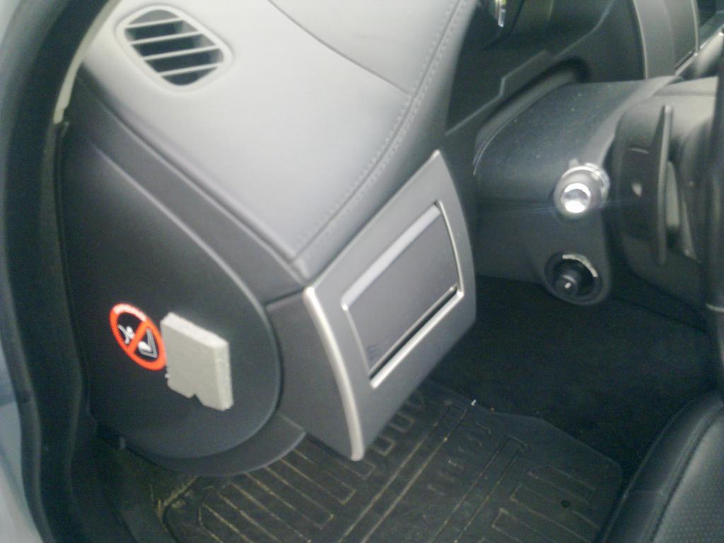

Originally Posted by philhef
Anyone else having this issue?
My 2010 XF door panels were buzzing near A pillars. I was able to fix it by 10mm thick foam matterss:
Attached Thumbnails 2010 door panel buzzing with stereo speakers-29082013939.jpg
