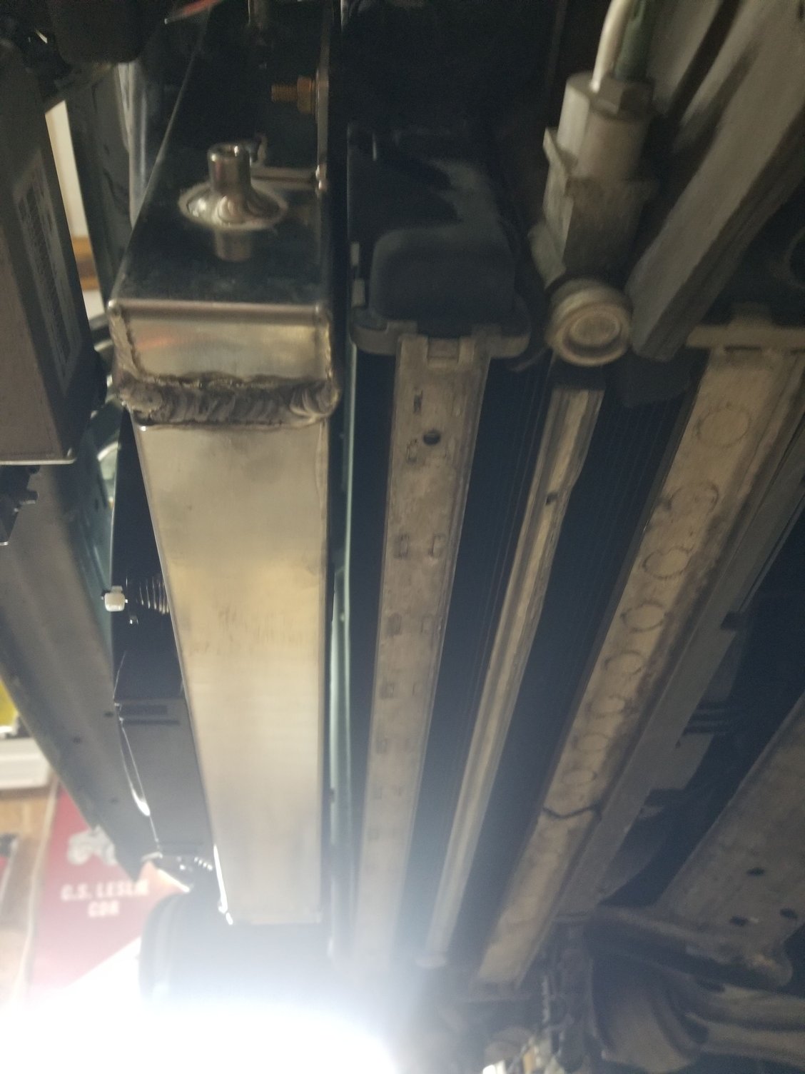

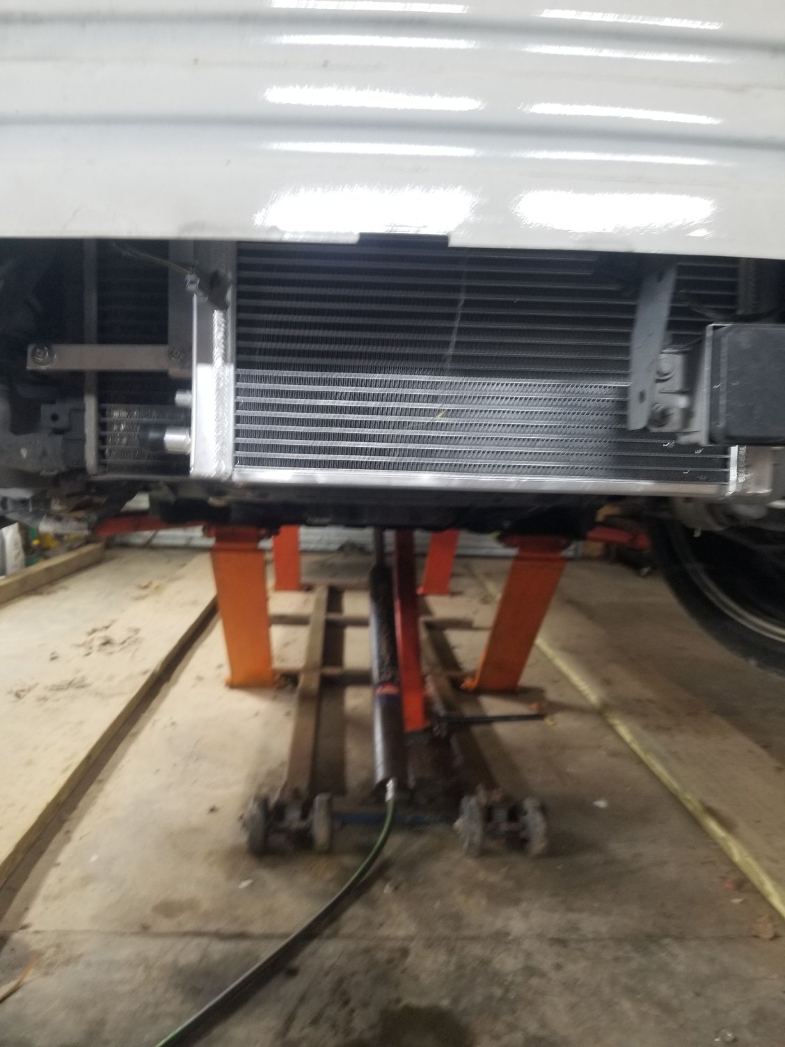

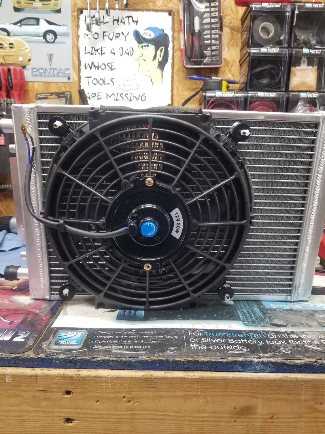

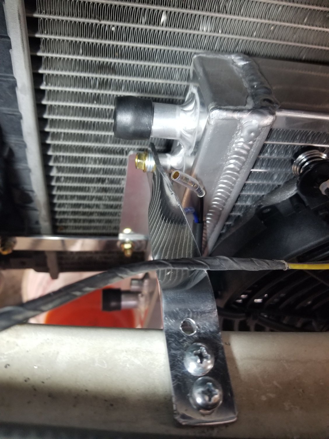

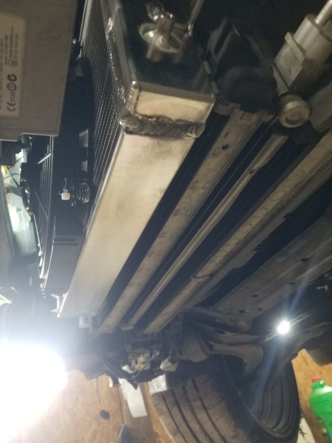

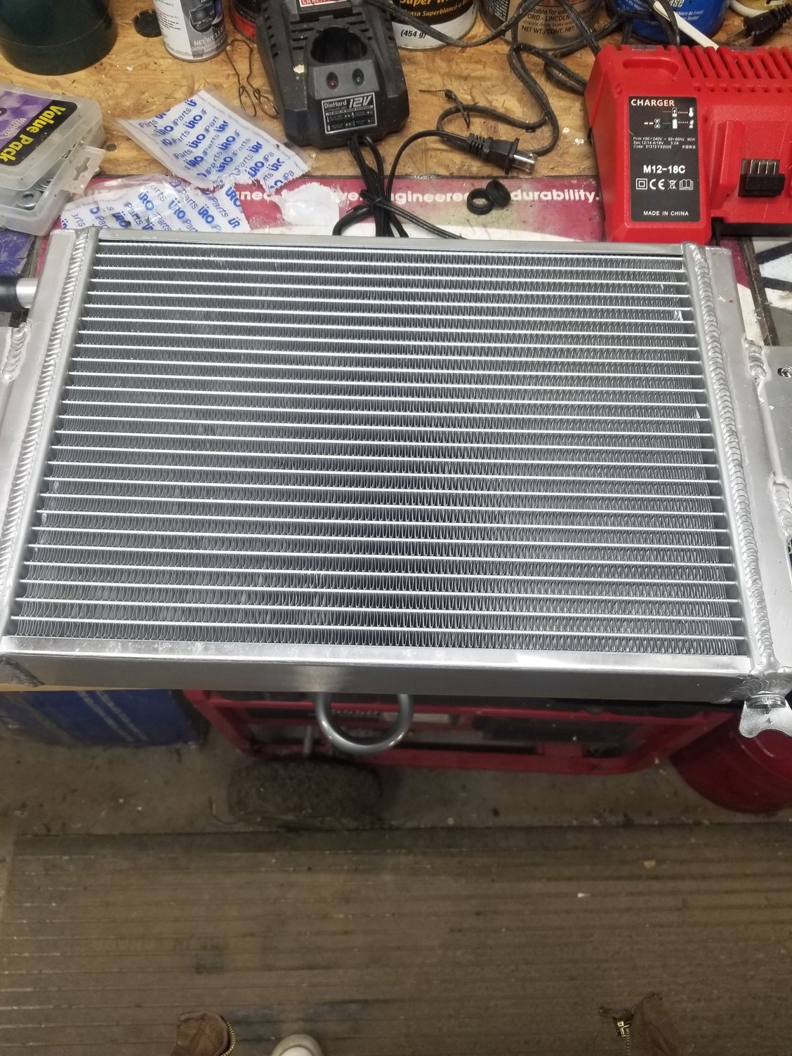

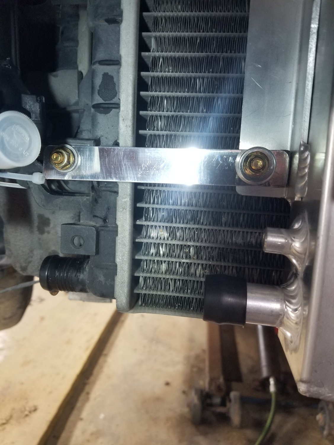

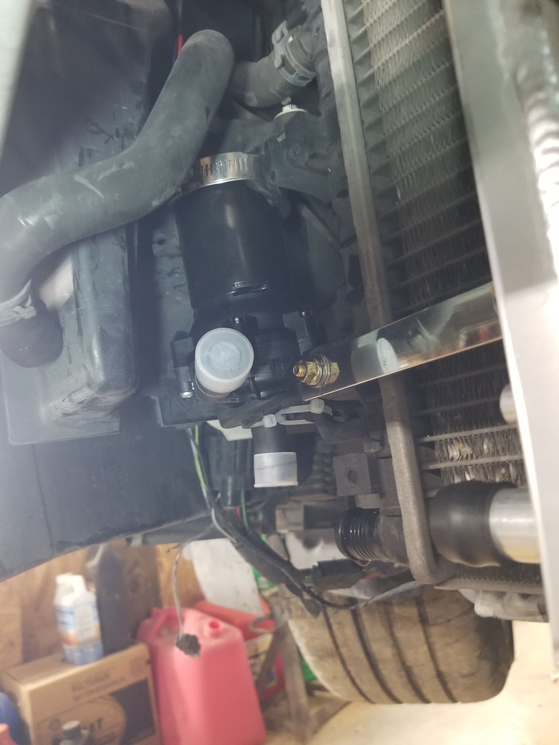

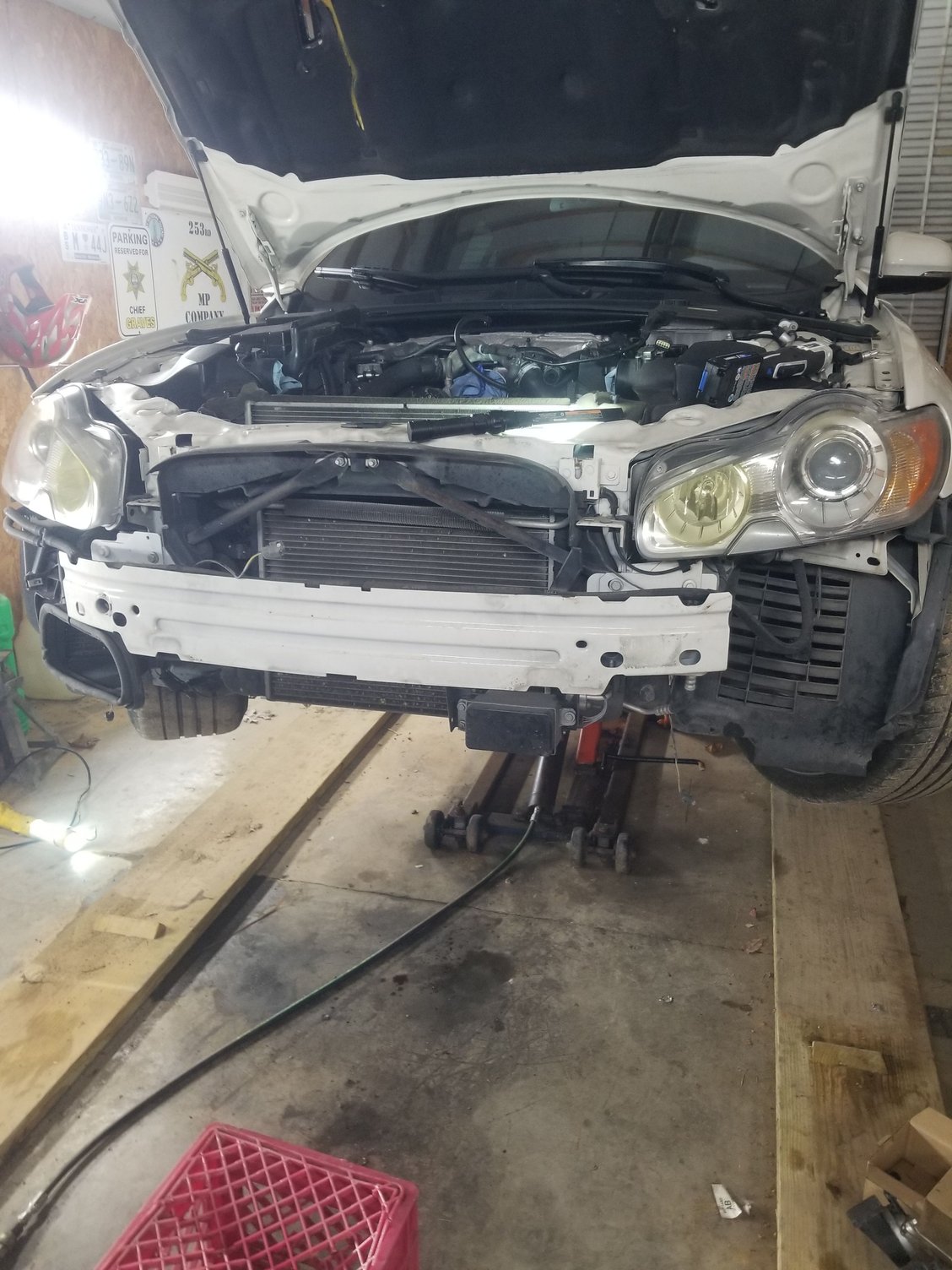

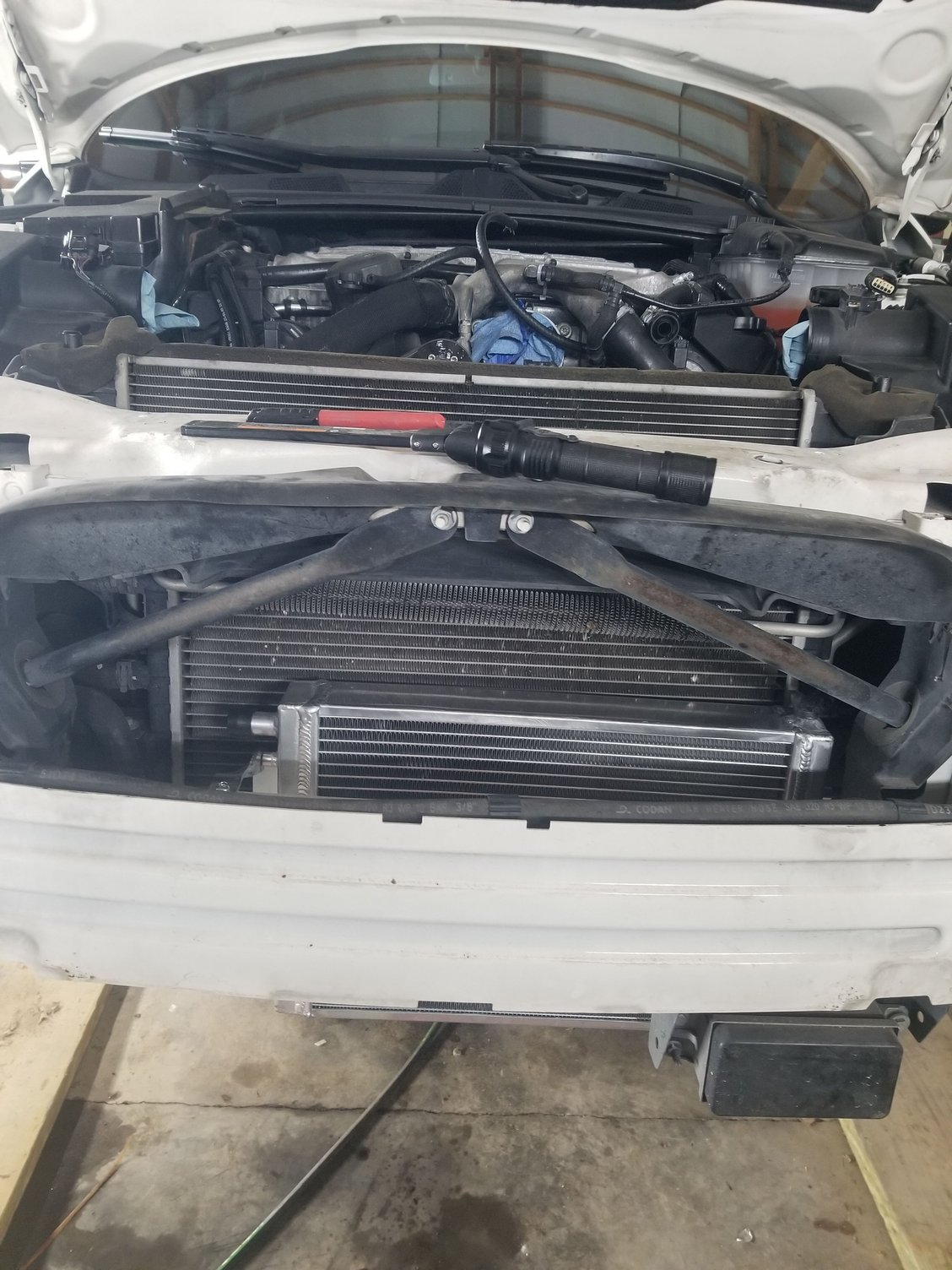

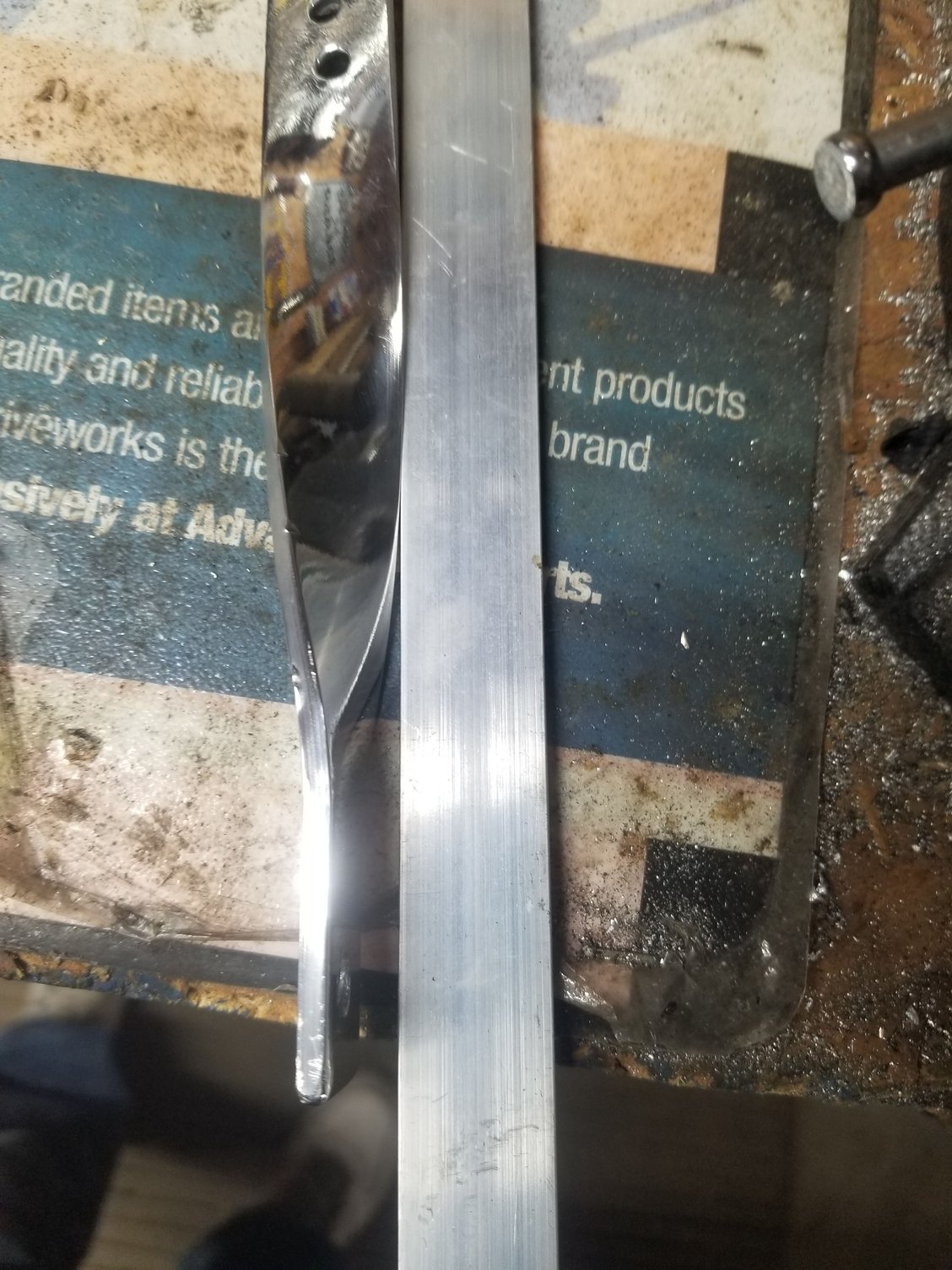

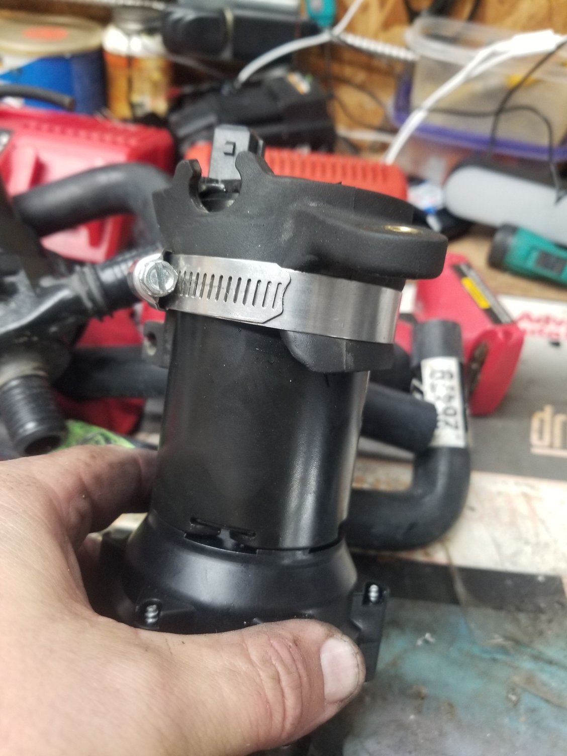

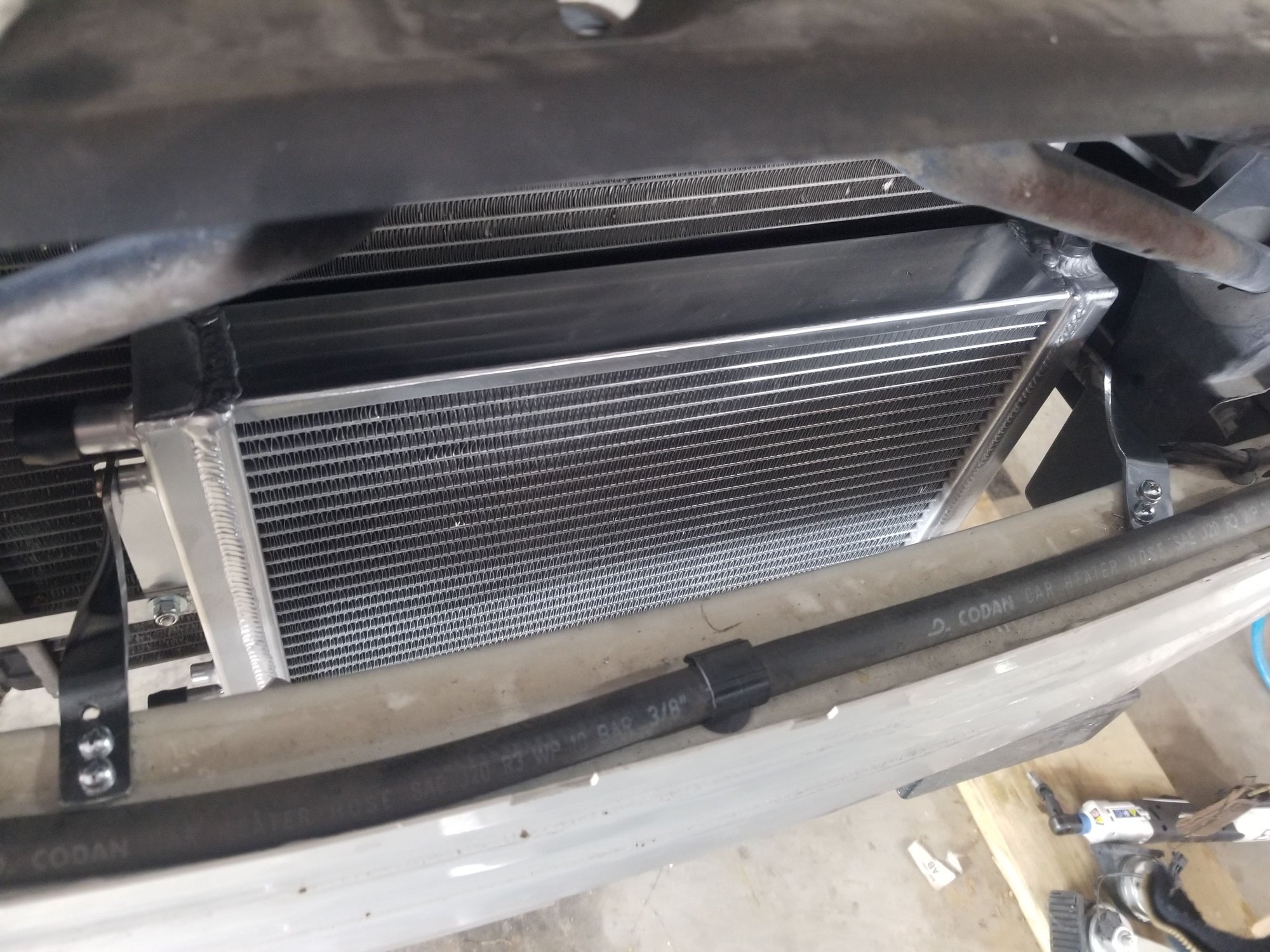

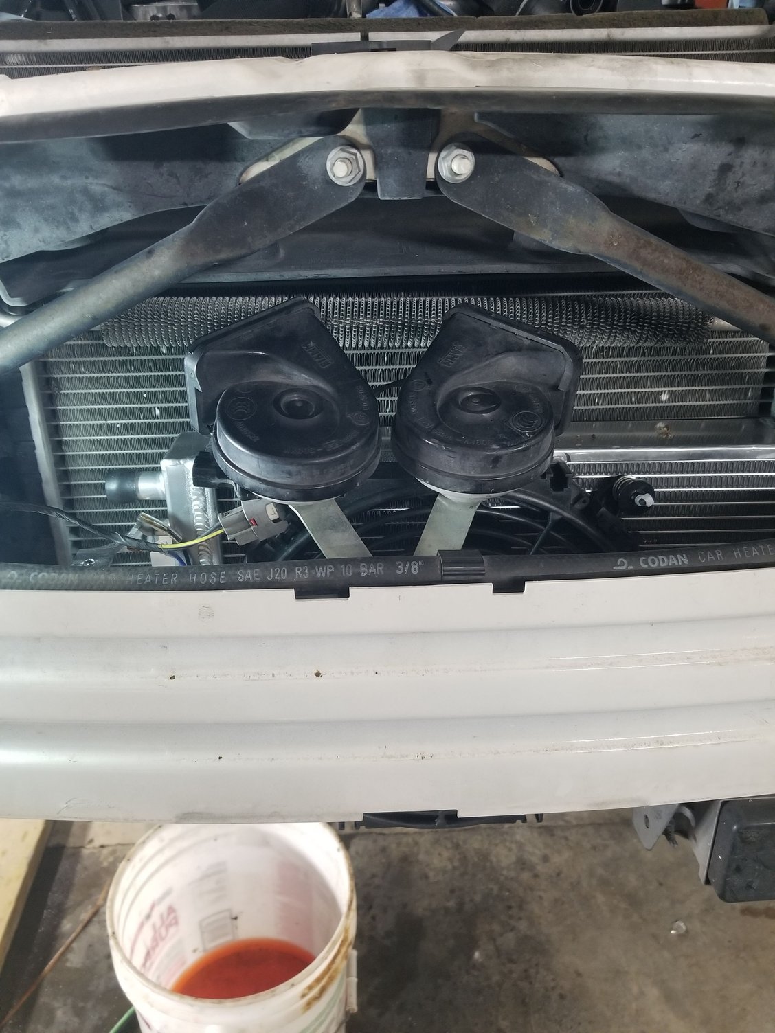

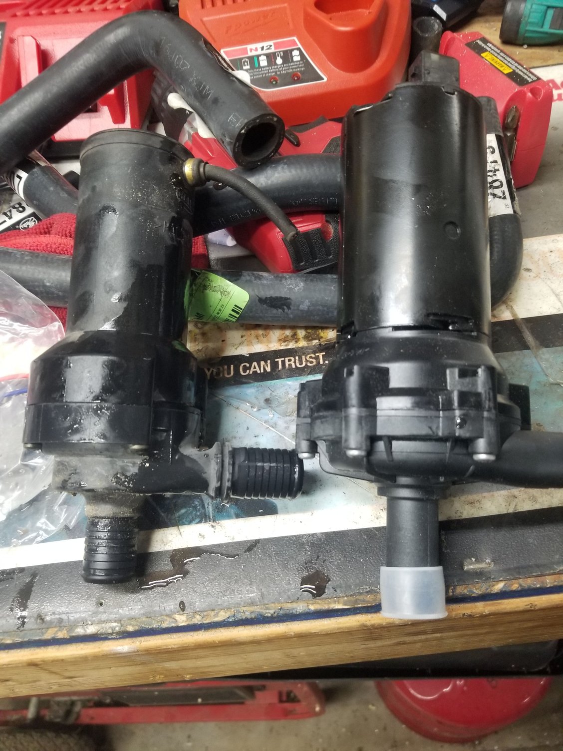

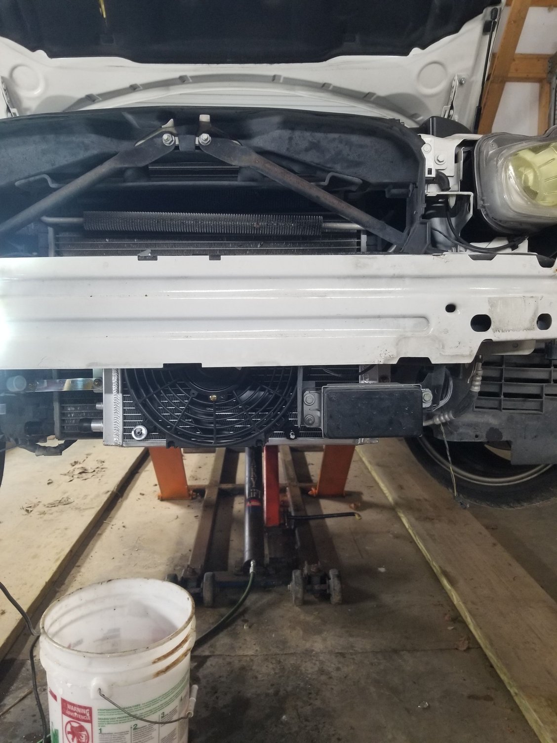

Sorry it took me a bit to reply. You are correct my aux cooler is an add on. I priced the bigger factory aux radiator and frankly was ashamed they want that much for one. I think mine was about $330-$350 and then $70 for an aux fan and thermostat. My intake temps are awesome even on 90 degree days at the drag track. I will.include pics.
The aux radiator
Removed front cover
Used aluminum.stock and polished to make mounts
Rmoved horns and relocated
Fan assembly
New pump
Modified the rubber mount cut it then used a clamp to resecurr it to the new one worked great
Horns fit great here and cant be seen from front
Used a few of the shrink wrap hose clamps.
Old Apr 25, 2022 | 11:15 AM
GoFaster's Avatar
Joined: Oct 2021
Posts: 135
Likes: 81
From: USA Tennessee
I mounted the aux radiator upside down and used the drain as an air bleed valve. I use one single wire tie at the bottom.of the pump to ensure it remained secure enough to hold the weight. I also went to the local parts store and bought several 3/4 pre-bent hoses of various design. Made the deal with the manager to bring back any unused hoses. I think I cut 2 of them so all the installation is pre-bent and looks factory with no crimped hoses due to radius turns. Took the untouched hoses back so it roughly cost me.17 dollars to complete the plumbing.
