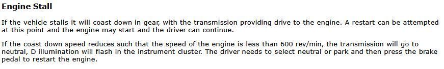

Communication with the 8HP transmission is all via CAN, so there may be diagnostic trouble codes stored that are Network codes which begin with the letter U. Generic OBDII scan tools can only read the Powertrain codes (P-prefix). You need need a scan tool capable of also reading the U-prefix, B-prefix (Body) and C-prefix (Chassis) codes.
The TCM relies on the engine torque and speed signals from the ECM in order to orchestrate gear shifts, so it seems possible that the P0236 code could reflect a problem with engine torque or speed plausibility, which could theoretically cause the transmission to shift to Neutral. Here's a snip from page 17 of the document I have attached:
