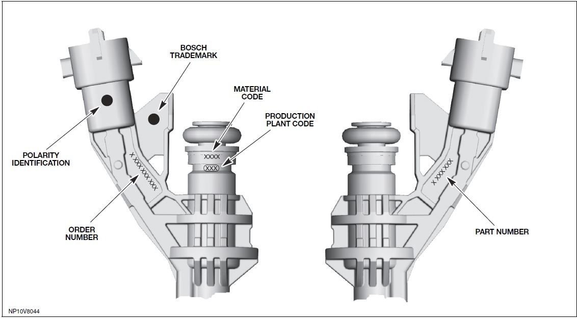

Up to you but you have all the signs of injector failure. Was the smoke white and you had quite a bit of it?
I would plan on replacing the injectors on that side of the engine. Do all 4 of them. The coils are up to you and not a common failure but certainly would be a good idea in general. In my experience it will be injectors and since your in there and for not much more cost I would replace the plugs too.
Now this is another BIG issue you need to be aware of? Tons of counterfeit injectors and many other parts as well out there!
I spent a miserable 2 weeks swapping injectors, checking for spark, running compression tests, verifying fuel pressures. I finally listened to my tuner AND a Jaguar dealer mechanic and put my OEM injectors back in after having them ultrasonically cleaned and flowed.
Here are a couple of picture that hopefully will guide you when buying injectors. Note that my fake ones came in Bosch boxes (Bosch is the OEM supplier to Jaguar and I always try to bypass the dealer and go directly to who actually made the parts-if possible). I also find the Bosch part number in addition to the Jaguar part number.
It's so common here is a picture that Hella (Hella now owns Bosch) put out to help identify "real" Bosch injectors. It's a stylized H so it's more of a symbol than a letter.
Here are my OEM injector markings.
Here is how my fake injectors were marked. Not much difference but when you start looking you can see what is what!
Note the difference in that the zero's are printed more round and the OEM has more square looking zero's. The 939 number has the ellipse line touching the numbers. The OEM has a rounded rectangular box around the 939 and the line does not touch the numbers anywhere.

Thanks for this. I am struggling a little though to understand how all 4 on one side would fail together, any further insight?
