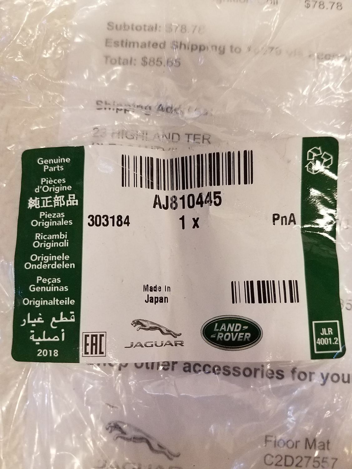

Jul 24, 2024 | 09:18 PM

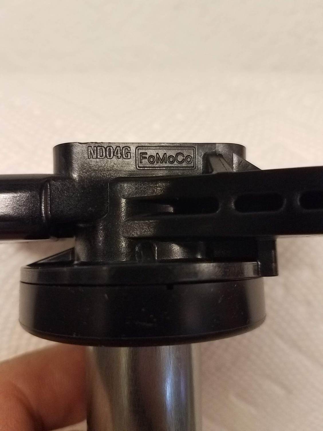

My OEM AJ810445 Coils came in Jaguar labeled bags and say "Made in Japan". The coils themselves have a FoMoCo logo molded in.

Jul 24, 2024 | 10:31 PM
Quote: My OEM AJ810445 Coils came in Jaguar labeled bags and say "Made in Japan". The coils themselves have a FoMoCo logo molded in.
that is them. Good job on sourcing. My originals had fomoco also

Have fo mo co on one . All the other ones is Denso

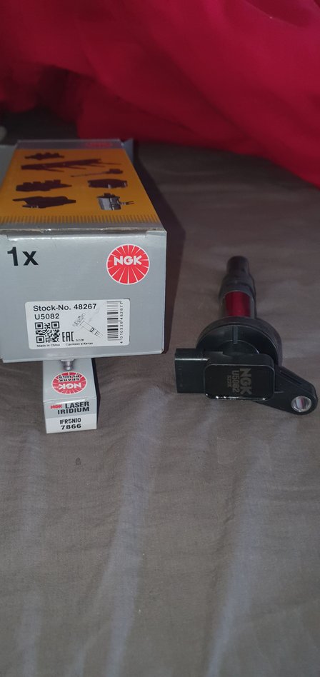

Thes have been tested to be the most consistant .
for the 4.2Na snd 3.5 NA
Reply 0
Jul 25, 2024 | 02:00 AM
Those Ngk have a tiny advantage when installing. The foot and the head is a tiny bit shorter . Useful on cyl 2 and 6

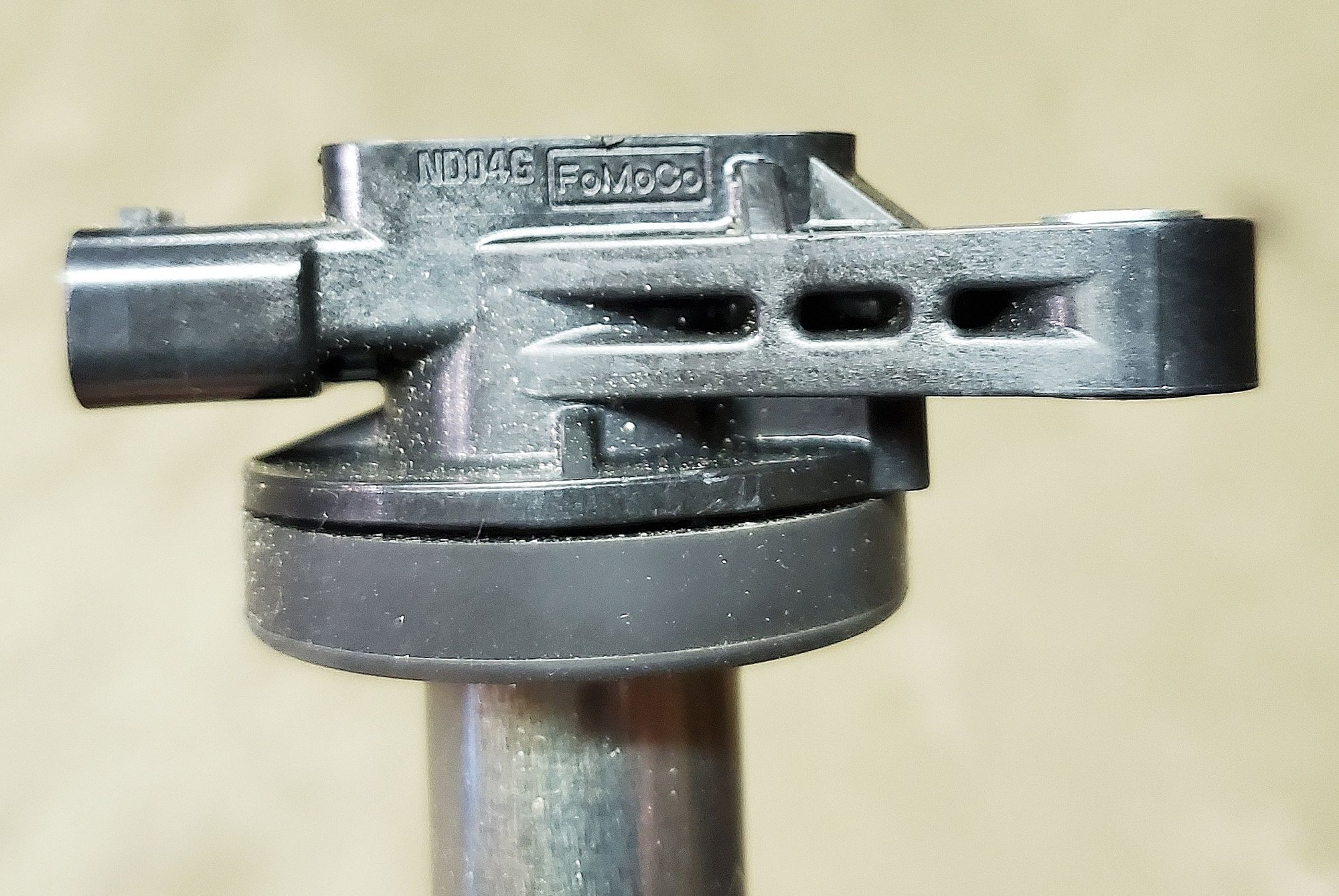

Jul 27, 2024 | 04:57 PM

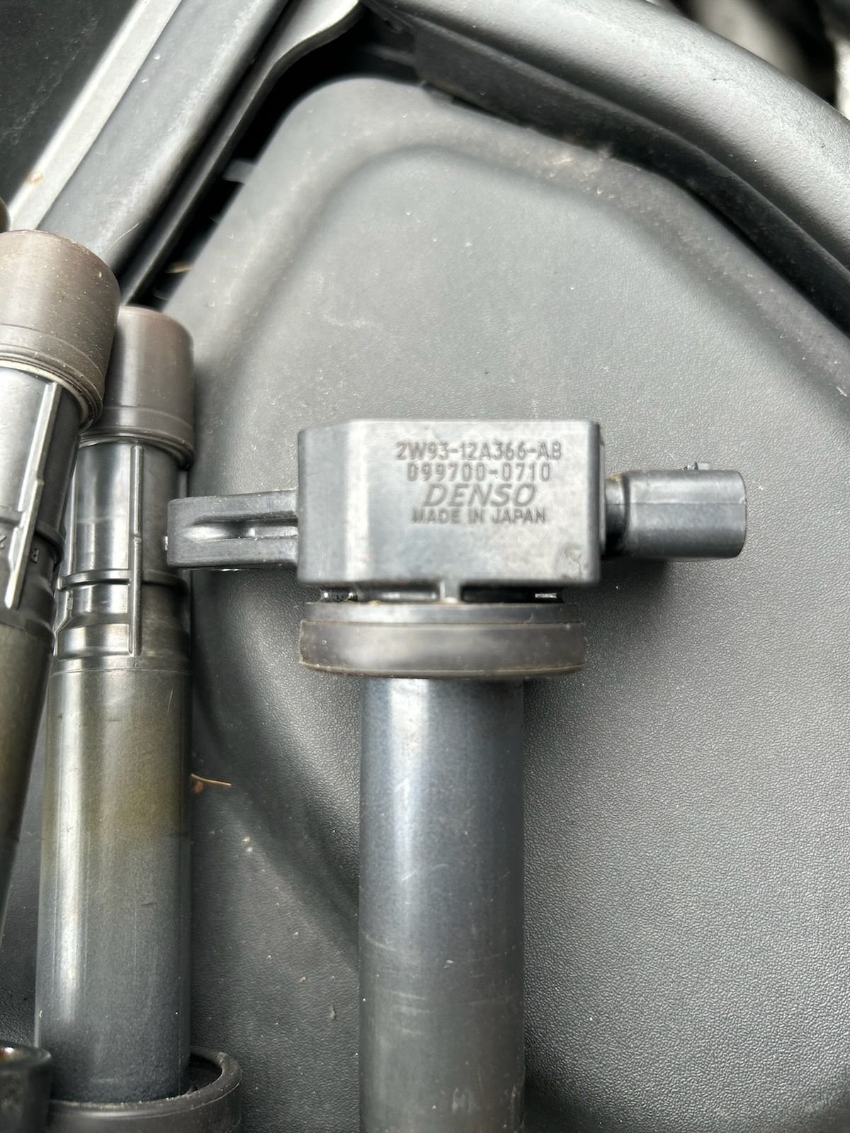

Here is a coil from an 18,000 mile 2004 XJ8.
Reply 2

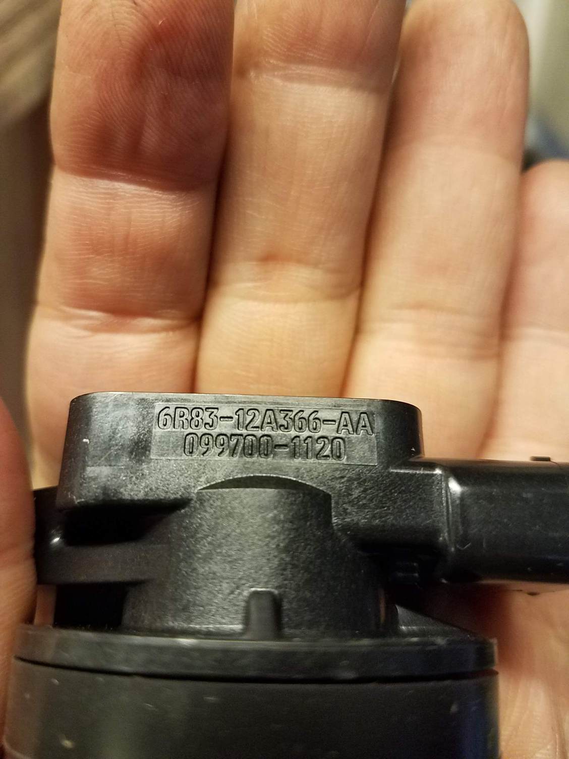

Regarding the ignition coils, the originals were definitely made in Japan by Denso. I have removed a lot of them. The replacements marked FoMoCo were made in Japan by Airtex, a Ford OEM. I have used a lot of them to replace original Densos. These Airtex/Ford Motor Company coils were packaged in Jaguar boxes or bags and sold by dealers during a period when the Denso coils were unavailable. Here's the same coil in an Airtex box:
I do not know if Jaguar has returned to offering Denso coils now that they are once again available. The new Denso coils I have purchased more recently are made in China:
