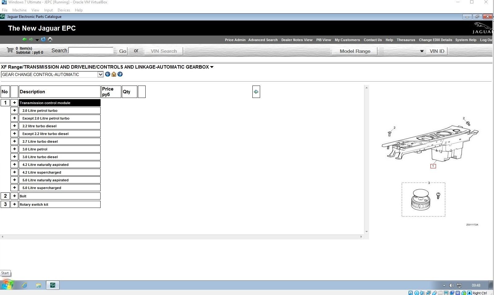

Hi I am new at this. Can anybody give me their take on being able to use a RHD gear selector module on a LHD. Is it as simple as just using the old bezel frame from the LHD module?

Unfortunately JEPC (the Parts Catalogue) shows it going to be more complicated than that:

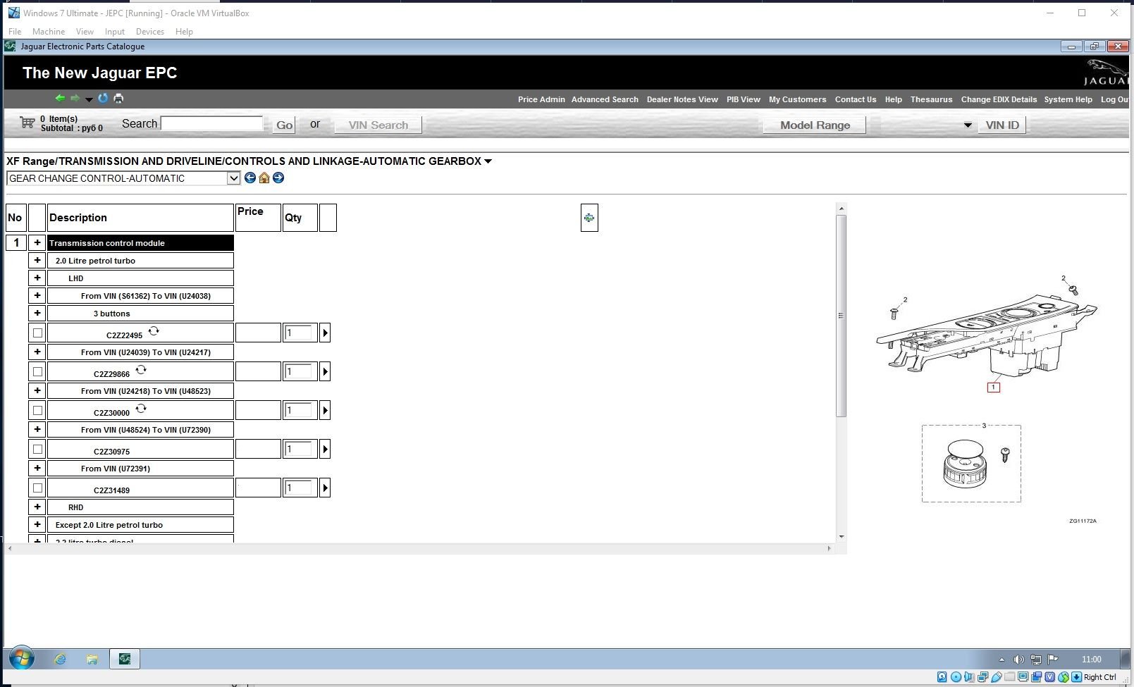

As you can see, there's different modules for each engine option. Beneath each of these are separate ones listed for LHD and RHD. If you identify the engine, I can drill down the list to find the module P/N.

2.0 Turbo petrol

There's a P/N change at VIN U72391:
