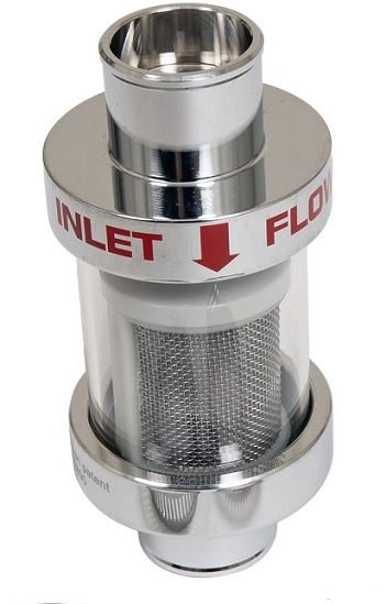

One idea? I have seen this on over the road trucks and several hot rods? They run an in-line coolant filter.
Something like this and a simple search will show you dozens of kits so they are somewhat common too.
This one is mounted in-line so any rubber hose that has room would work. These are in the $60-$130 range depending on how fancy they are. With the clear body you would have an indication of how full the filter is too.
Interesting I’ll have to check it out, thank you! There’s definitely some bigger flakes but seems to be mostly really really tiny sparkles
