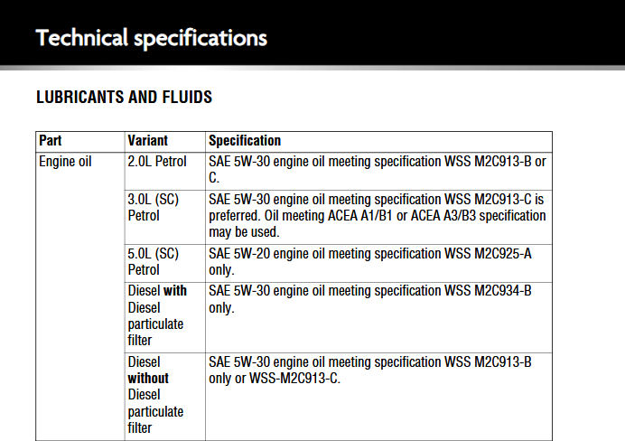

I am about to change the oil in my car for the first time. It has been going to be dealership so far. The cap says recommended oil is 5w-20, however the owner's manual says 5w-30. I live in Florida. Any ideas on which one is accurate or more appropriate?

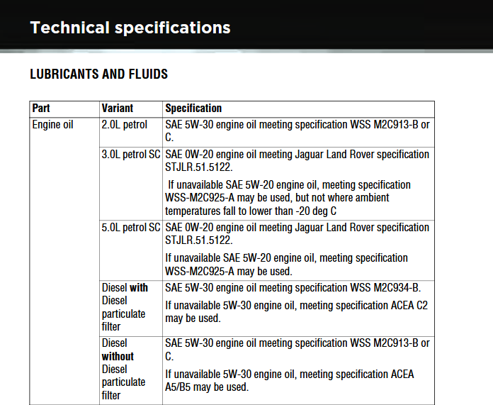

I checked on the Topix website and the first edition owners manuals do indeed show 5w30 as being the recommended oil. However the second edition of the manual states 5w20 so I presume the manufacturer changed the spec as more knowledge was gained on the engine.

Yep, 5W-30 was the original spec for the AJ126 V6 when it came out in 2012 but about a year later JLR changed it to 5W-20 then a year or so after that they changed it to 0W-20. My Oct 2014 built V6 engine has 0W-20 on the oil filler cap.
Any and all of these specs will be perfectly OK for your 2013 XF, and being in Florida I would lean towards the higher viscosity 5W-30 seeing as the latest 0W-20 is really meant to cater for very cold start up temps. Lots of debate as to why JLR went with lower and lower viscosity but the two main reasons appear to be slightly better fuel economy and reduced emissions of the dreaded CO2 (per CAFE and Euro regs) and improved lubrication of the timing chains and related components at initial start up.
Whichever way you go you want an oil which meets ILSAC GF 6A.
