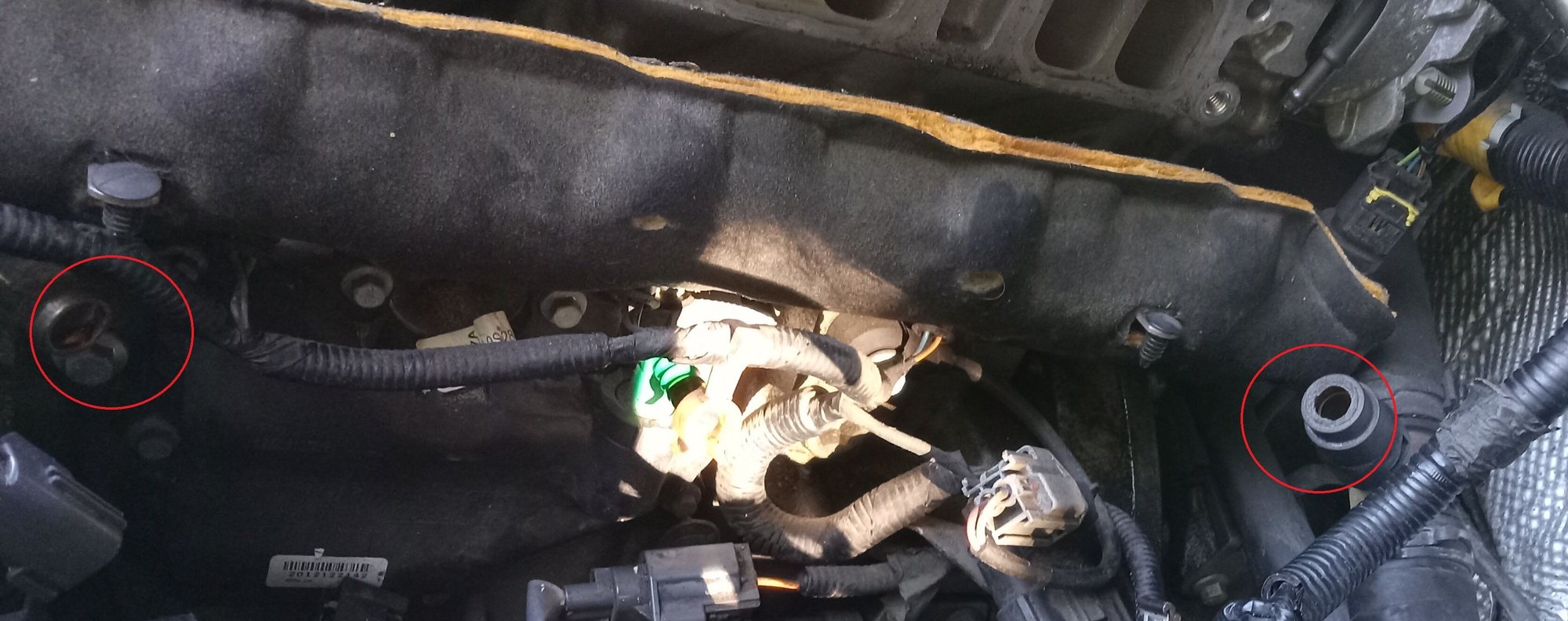

I've searched the forums and a lot of other places, but I cannot find what I need to know.
'13 XF base (2.0L turbo gas). Coolant line that runs under the intake manifold, into a larger coolant line. I am having a HELL of a time just trying to find 1) what it's called and 2) Getting one.
The line is missing in this photo, but you can see where it goes. The broken end traverses to the front of the engine, onto a metal barb that appears to go into the head.
Anyone can tell me what it is I need to get? I was able to find the whole run, USED, which I'm not really liking but man, it's ALL I can find!

This is the part number for the hose you need. JDE36330

Another question, referencing the same photo...
The plastic line that goes from the intake to the green colored barb, it broke. I can't seem to identify either the line or what it plugs into. Any help on this one? It's a quick disconnect on the intake and just pushes over the green barb.
Also, there's a stem on the LEFT, (firewall side), of the intake that seems to take a line, but I cannot find any line that isn't accounted for and do not recall taking one out of there. I've got one vacuum near the top on that same side plugged into a line that goes to the turbo, but the one I'm talking about is coming from under where it splits from one into four paths and looks like it may be a quick disconnect type. Any help with this?
Oil Separator XR858490
Not 100% about your description but the "quick disconnect" on the firewall end of the intake manifold does not have anything attached to it. But it may have a use on vehicles from markets that I am not familiar with.
