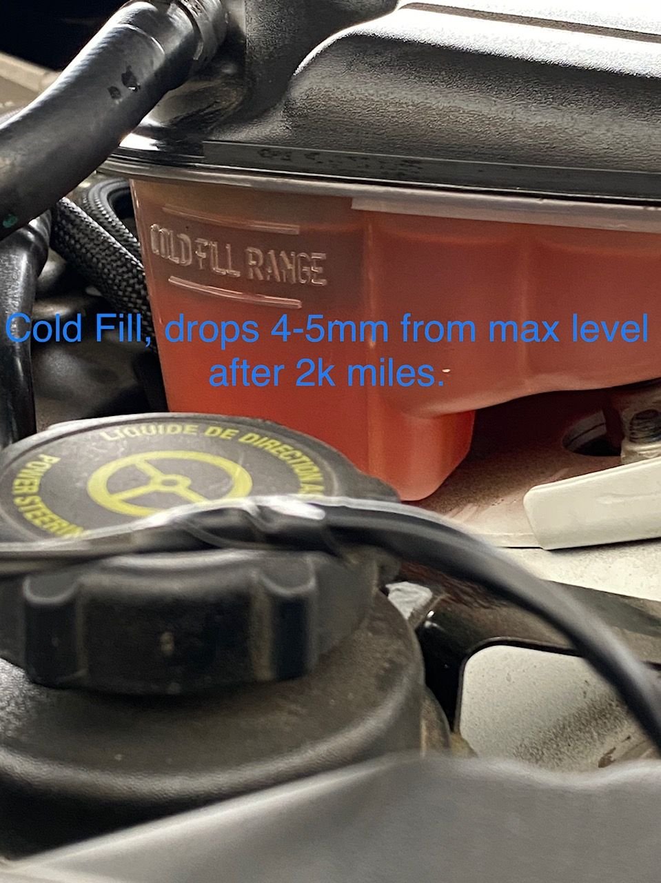

Now it seems to be dropping from MAX after 2k miles about 4-5mm.

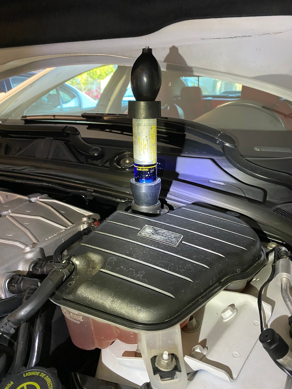

Brought a combustion gas tester. Sucked some coolant out, hooked up my scan tool and monitored the coolant temp with the cap off until it reached 95 C and pumped the tool for a couple of minutes until the coolant temp reached 100c (212 F) then shut the car off.
Didn’t change color.

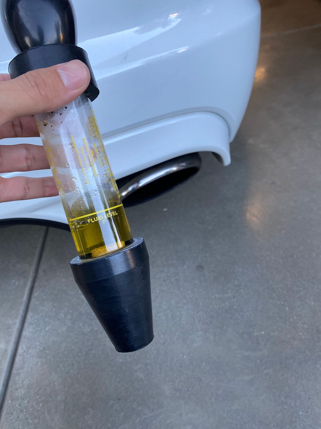

I also tested the fluid after monitoring it for 20 minutes on the exhaust directly and it turned color instantly.

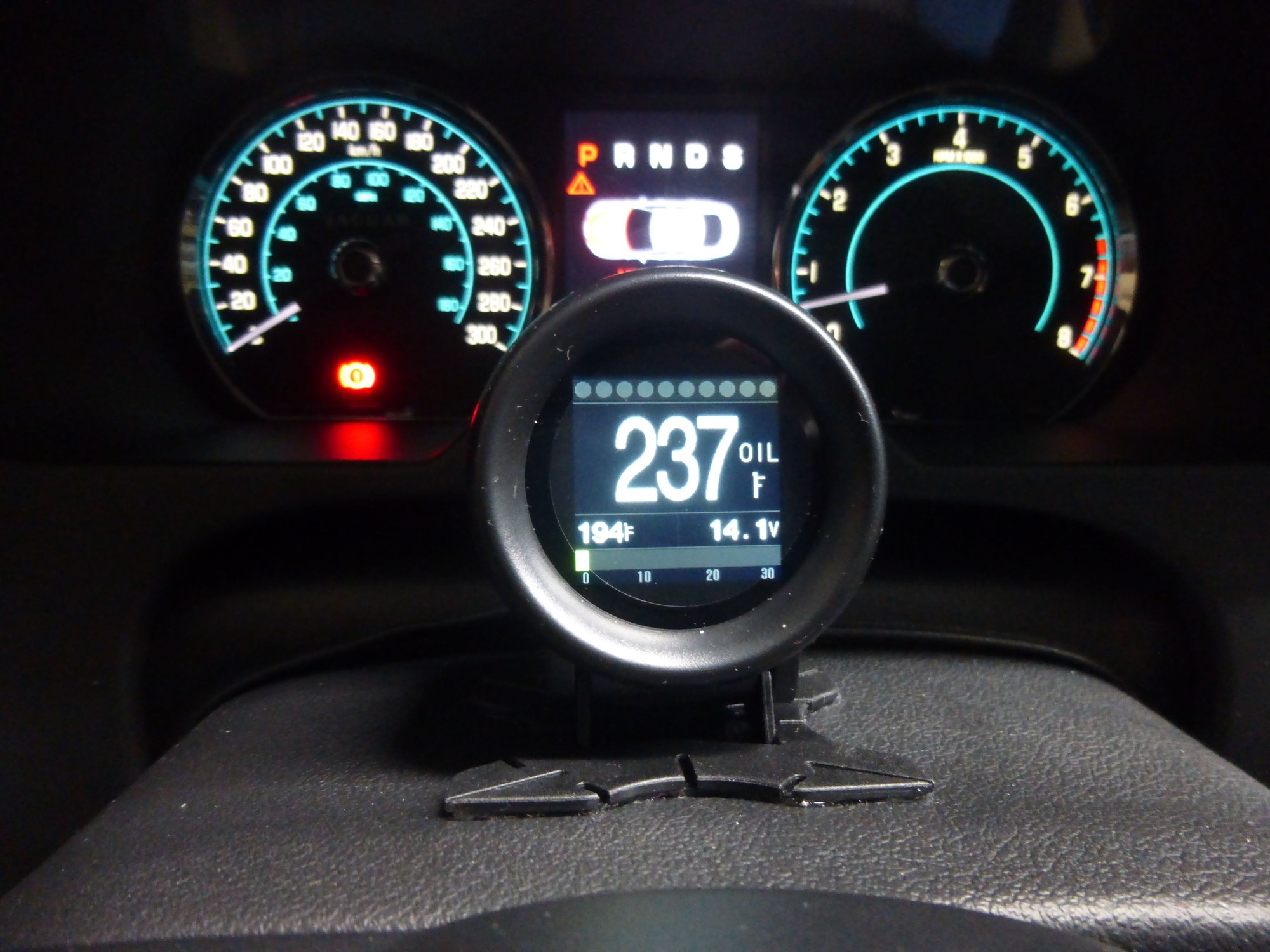

I have a cheap permanent reader to monitor eng oil temp, eng coolant temp and alternator voltage.
Typically I have seen between 194F-202F for coolant temp and 225F-245F for eng oil temp during the hot weather. Generally the higher temperatures appear at slower speeds and the lower temperatures at speeds up 150kph
This shows what I monitor.
