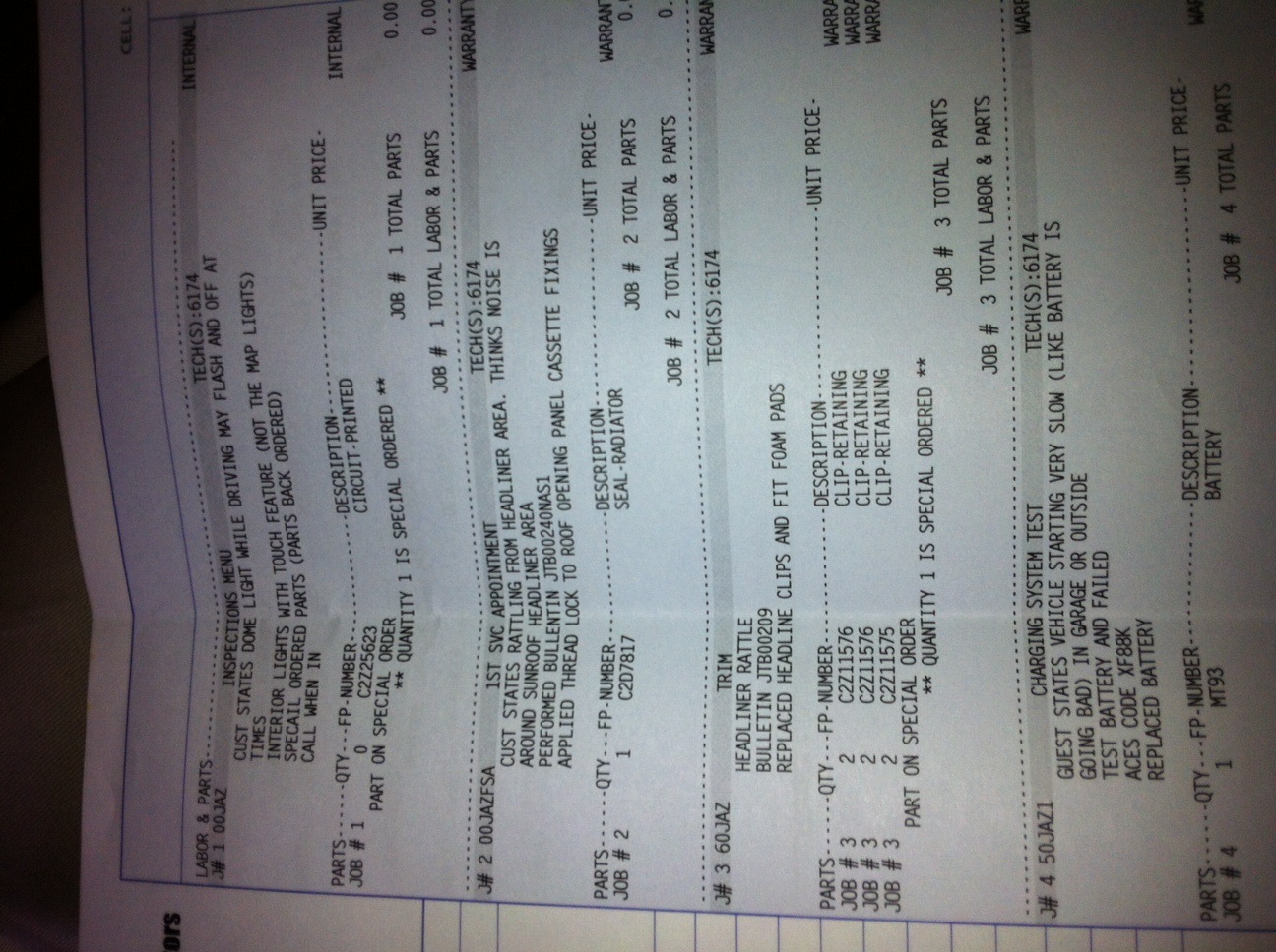

Here you go.
In case the picture is unclear:
Bulletin JTB00240NAS1
Thread locker to certain fasteners
Bulletin JTB00209
Install 4 revised clips with foam pads, part number C2Z11576
Install 2 revised clips with foam pads, part number C2Z11575

Old Mar 4, 2013 | 06:00 PM
  #31
uclabrruin1989's Avatar
Joined: Aug 2012
Posts: 252
Likes: 82
Originally Posted by 10 XF Premium
Here you go.
Bulletin JTB00209
THANKS a lot. i called the dealer and will be dropping it off to get it fixed. thank you

one day in and problem fixed. they refer to it as a "sunroof seal". the reference numbers are different than what 10 XF Premium posted above i was told, i suppose because i have a 2012 Portfolio. they had the parts in stock and it took less than 2 hours for them to call me and let me know it was done. creaking noise 100% gone. they'd obviously dealt with this issue before. keeping my fingers crossed it stays fixed
looks like Technical Bulletins JTB00209 and JTB00240NAS1 and parts C2D7817-foam block plus C2Z11576-headliner clip x 2.
thanks for the help guys, makes a world of difference.
