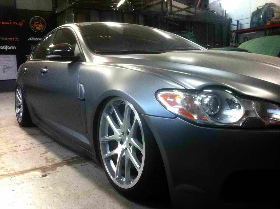

Hey guys does anyone know what kind of resistance I need to cheat the CATS of my XF SV8? Been reading anywhere from 5-6 ohms. Anyone with success with this method?
