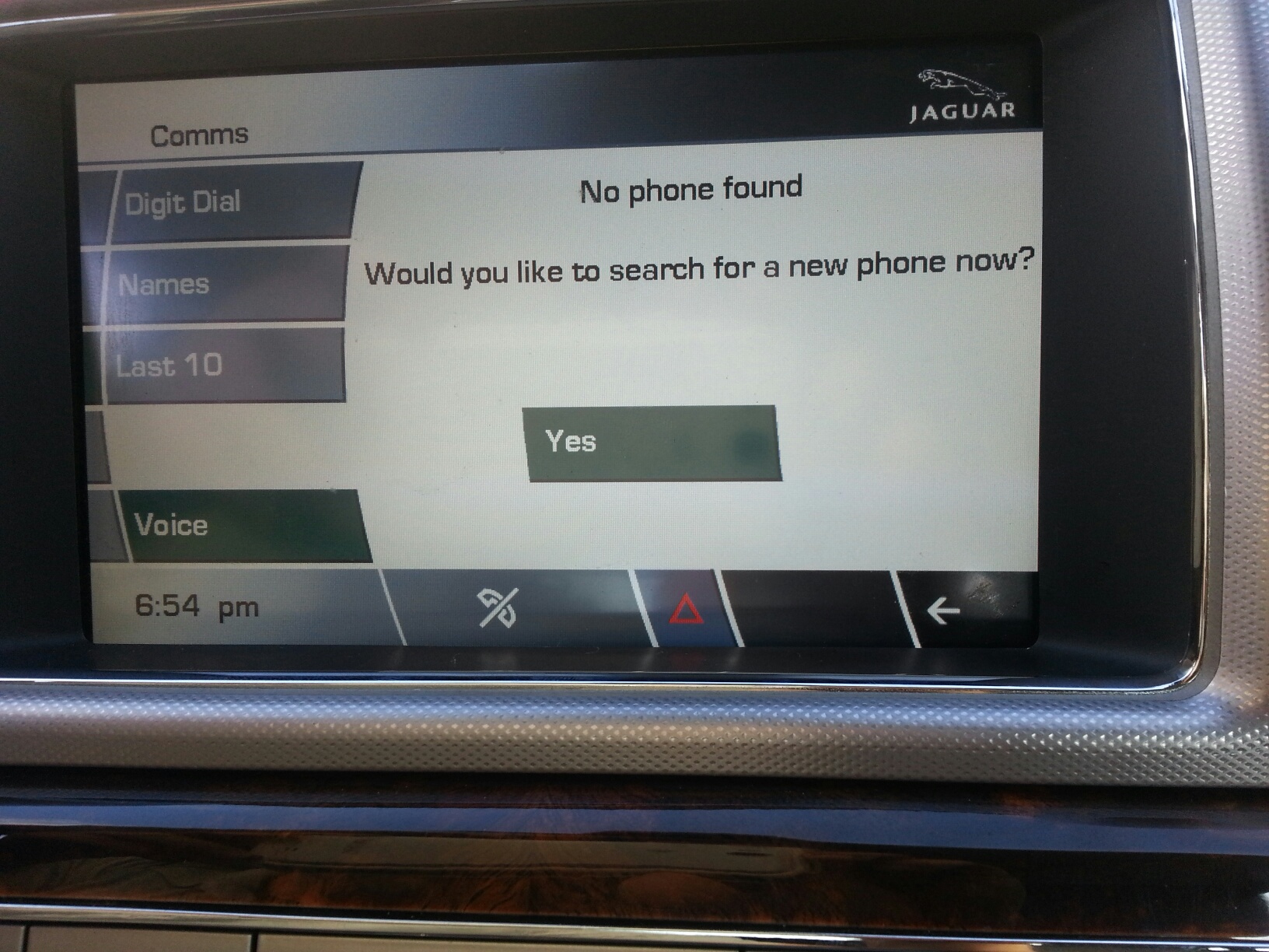

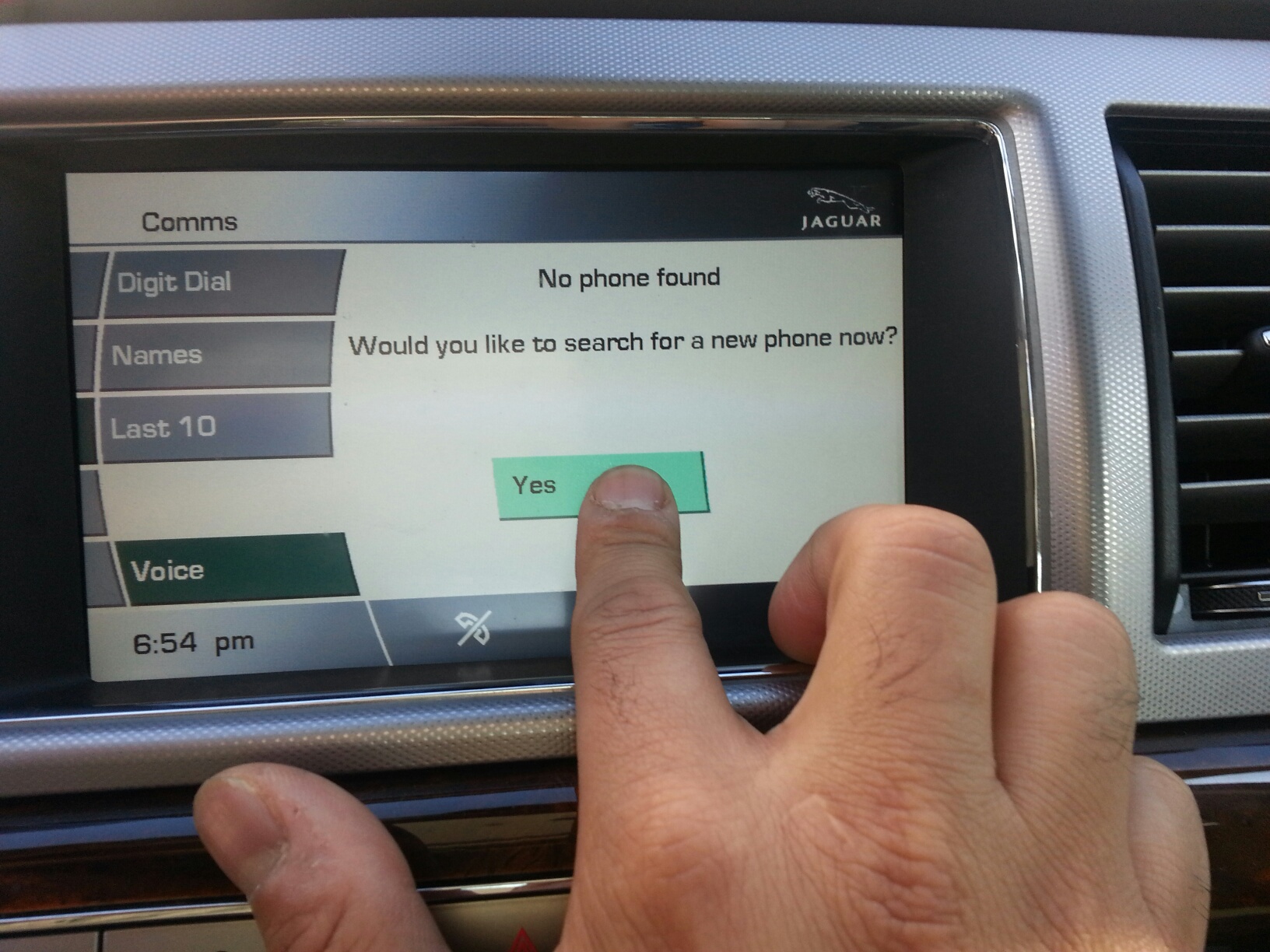

I don't see any old phones paired....
so this is how it looks
under comms- it says no phones found. then it asks"would you like to search for new phone now?"
then there is a dark green "YES" and when i press this nothing happens.
see pic
Attached Thumbnails Bluetooth issues 2011-20130623_185140_resized_1.jpg   Bluetooth issues 2011-20130623_185129_resized_1.jpg

Other than being sure that your phone is a compatible phone, I'm out of suggestions other than a trip the the repair shop.
