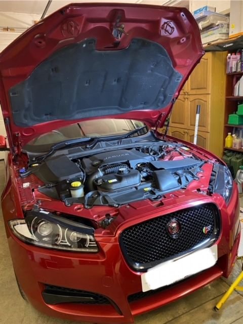

All The cable had popped out of the retaining arm in the latch. Now I have the bonnet raised I am convinced that regrettably there is no other way to have got the bonnet released. What I would add for anybody following in my sorry footsteps, the bonnet could be salvaged if you can't find a replacement at a reasonable price. You will need a replacement retaining clasp assembly (not sure the right term, its secured to the bonnet with two screws).
You need to remove an oversized section from the outer skin to allow access to the inner skin then cut around the clasp (but within the two securing screws).
I made a template by tracing round the "retaining catch assembly" on the replacement bonnet then carefully hacked out the appropriate section of the upper skin.
this is the resultant hole
in close-up you can see the back side of the "retaining catch assembly". if you can cut within the outer retaining studs you will be able to replace the assembly with a replacement
I needed to open up the hole in the outer skin to get my tool in to cut the latch free
The retaining catch is now free from the bonnet
et voila. I managed to get a replacement bonnet for 90GBP but if you want to repair the damaged bonnet you could. Remove the old, hacked catch assembly (two screws) then fibreglass a patch to the inside of the top edge. source and fit a new catch assembly.

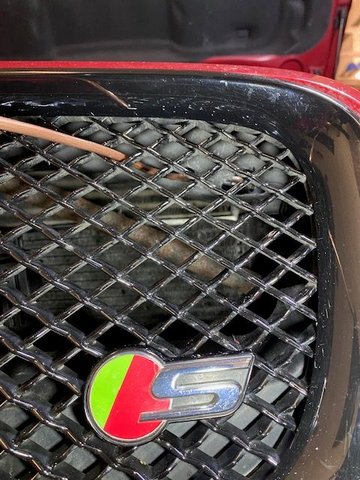

I got in through the grill with the latch issue as I had a spare grill which came with the car when I bought it. I had to then drill through the plastic inside the grill to access the bottom of the latch. Obviously now had to take the full bumper off to replace the grill. No easy way out of this problem.
Old Jun 6, 2022 | 02:16 PM

Thumbs up
And hey presto it’s off, just need to get it back together now with the new black grill fitted

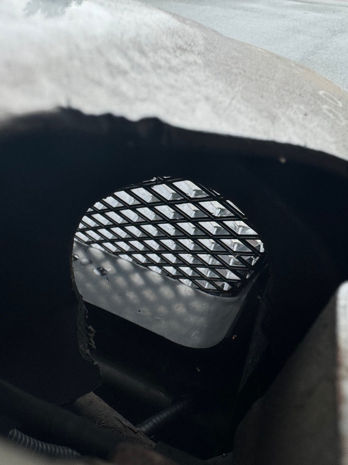

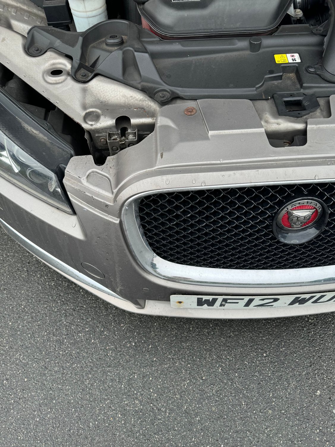

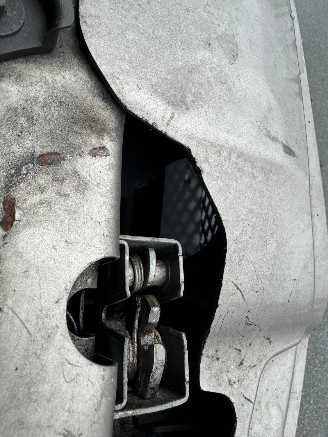

Hi,
I drilled a 50mm hole near to the latch so I could get in with a screwdriver and manually unlatch as the cable had come out. I’ve attached some pics for you to see the access hole I drilled.
hope this helps.

Many thanks for posting the extra pictures which are really helpful. I hope I can pull-off the same trick on the near-side!
