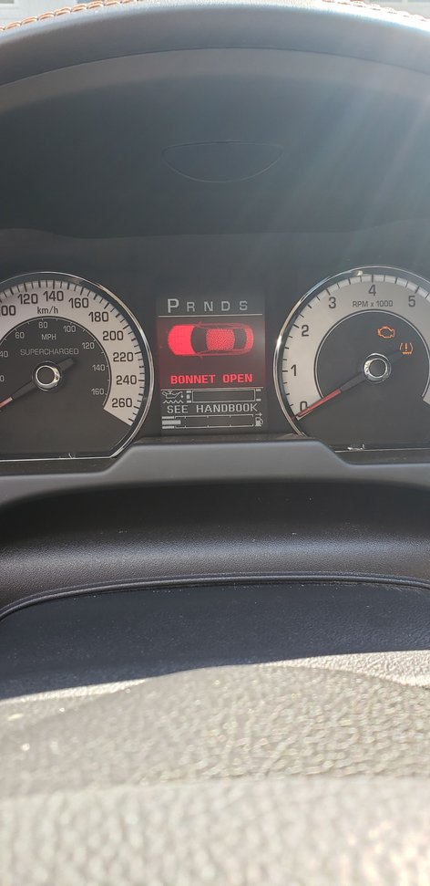

- Possible engine oil burning. after Lexus put fresh oil in, 1 week later I got an "add 1 litre of oil" message
Possibly they didn't fill it fully, top up monitor and check. The XFR has zero reputation for burning oil.
I feel I must beg to differ here - to an extent. I lost enough oil in a service interval that it got low enough to spin bearings, and there were no obvious big leaks. I still have no proof, but my suspicion is my worn chain timing guides caused metal in the oil, maaaybe wearing piston rings or similar to cause blow-by and burning off? Either way, there's a few stories of dead XFR engines due to oil starvation, and assuming these engines weren't leaking enough the owners noticed, the reputation is not quite zero.
@Turtlepower it's entirely possible the dealer didn't put enough oil in, so top it up, make sure it's good, and keep an eye on the level. If it drops - make sure you have no leaks, these should be pretty apparent on the block.

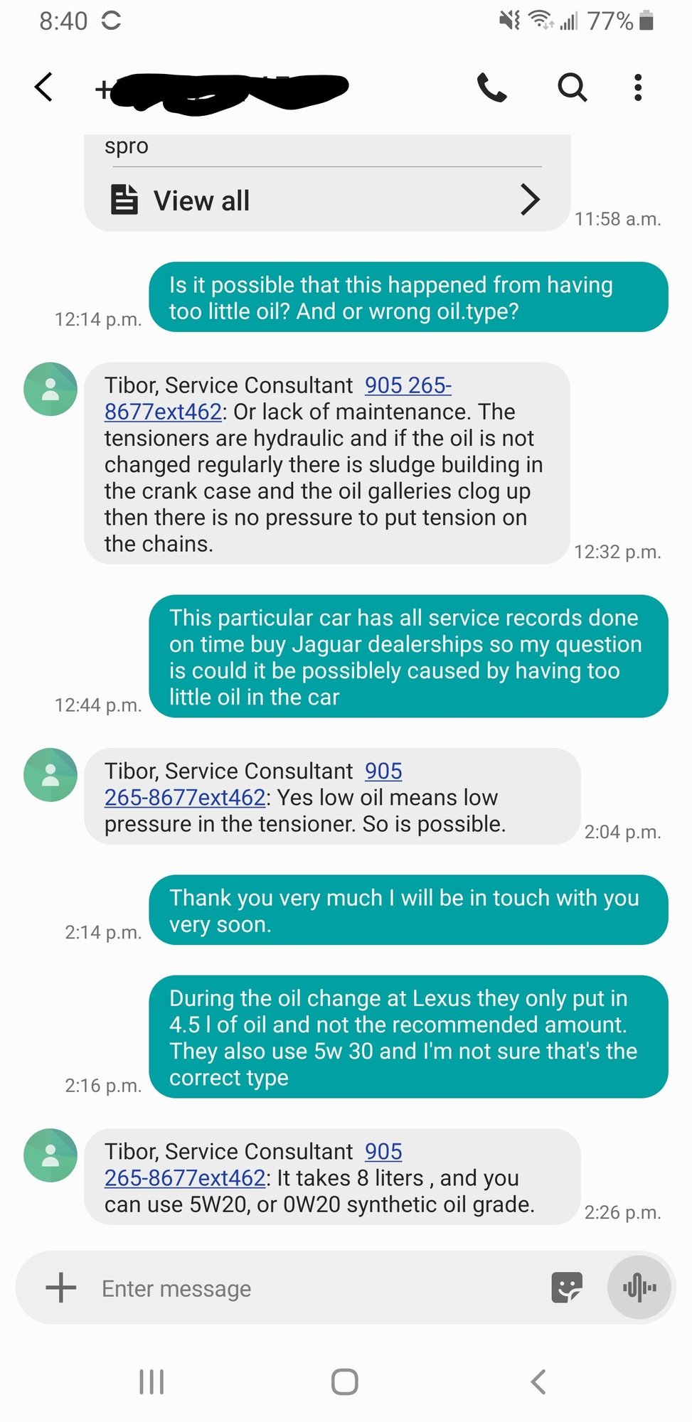

3) Lexus did a fresh oil change before delivery to me. The reason why I thought the oil was burning was because I found out they only put 4-5 L of oil in, and not the recommended 8. AND they put 5W30. So its very possible the timing chain was damaged because of their negligence yet again ( half the amount of oil, wrong oil type)

They didn't put "only half" the recommended amount of oil in if you claim they put 4-5 litres in.
The correct fill volume for the XFR is 7.25 litres so 4-5 litres is a bit more than "half".
In your first post you said you got the dash message "add 1 litre of oil" which suggests they put maybe 6 to 6.25 litres in, not 4-5.
I am making this point because if it comes to legal action (and I suspect it will) you need to be accurate and not exaggerate.
However using 5W-30 is a big no-no in this engine, it needs 0W-20 or 5W-20.
Also you need to check exactly what spec, grade and type of oil they used, the XFR takes a very precise specification and any old spec just ain't good enough.
I reckon if you can prove they used the wrong grade and spec oil and under-filled it by at least one litre you have a good chance of forcing them to completely fix all engine related problems free of charge, just don't gild the lily!
Edit - forgot to add - one of the purported reasons JLR changed the oil spec on the AJ133SC some time around 2013 from 5W-20 to 0W-20 was because of excessive timing chain wear. The theory is that the slightly heavier (at cold start) 5W-20 took a bit too long to reach the timing chains and tensioners resulting in excessive wear, so the solution was to go to a thinner (when cold) oil, 0W-20.
If true then 5W-30 oil is even worse and you could argue that it at least contributed to if not caused the excessive timing chain wear.

- A service consultant at jaguar said it takes 8 litres of oil via text.
- The service consultant at Lexus verbally said they used only 4ish, and needed to top off when I brought it in. Hence me saying half - based on the information presented to me.
- I have pictures showing the initial warning of add 1 Litre. Followed by me waiting the recommended 10 minutes on even surface to get a more accurate reading, and it said " see handbook" with an even lower level of oil on the bar - Hence less than 1L for sure- and by how much? I don't know.
- Also proof of them using 5w30 is shown on the service record when I took it in, and they said the topped off with 5w30... safely assuming they are using the same oil they changed it with.
