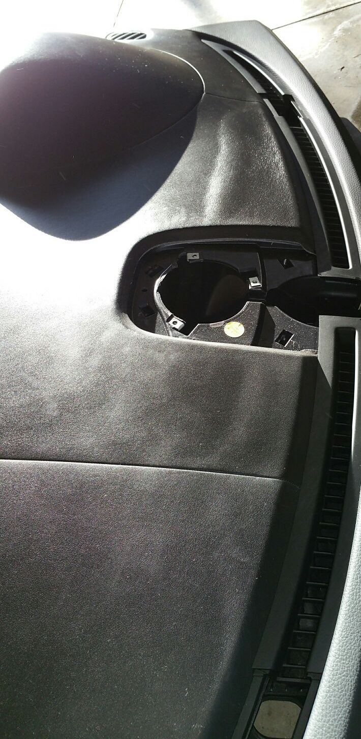

I finally got some time to pull the dash out of my XF. I plan on attempting to lift the leather up and re-apply it. If it doesn't seem to be working I'll pay a upholstery shop to do it. The removal wasn't too bad. It took me a little over an hour. I snapped pictures of every step/bolt so the install wouldn't be difficult.

Hey…..the second pic shows the strip next to the windshield and the surface looks exactly like a "bonded leather" instead of the soft-design that is bubbling on your dash. In other words it looks like it does not match the dash proper but more like the leather on your steering wheel….right ?? Mine is just the opposite ……that strip next to the glass is a match for the soft-design leather of the dash and window sills but not the steering wheel. My dash was replaced but the leather was replaced with bonded and not soft…….so it matches the sterling wheel. Actually I like it better in that it is padded better and feels and looks more like leather instead of the soft design that looked like a vinyl copy.

I need to clean the leather up a bit. It's a bit glossy which is giving it the vinyl look.

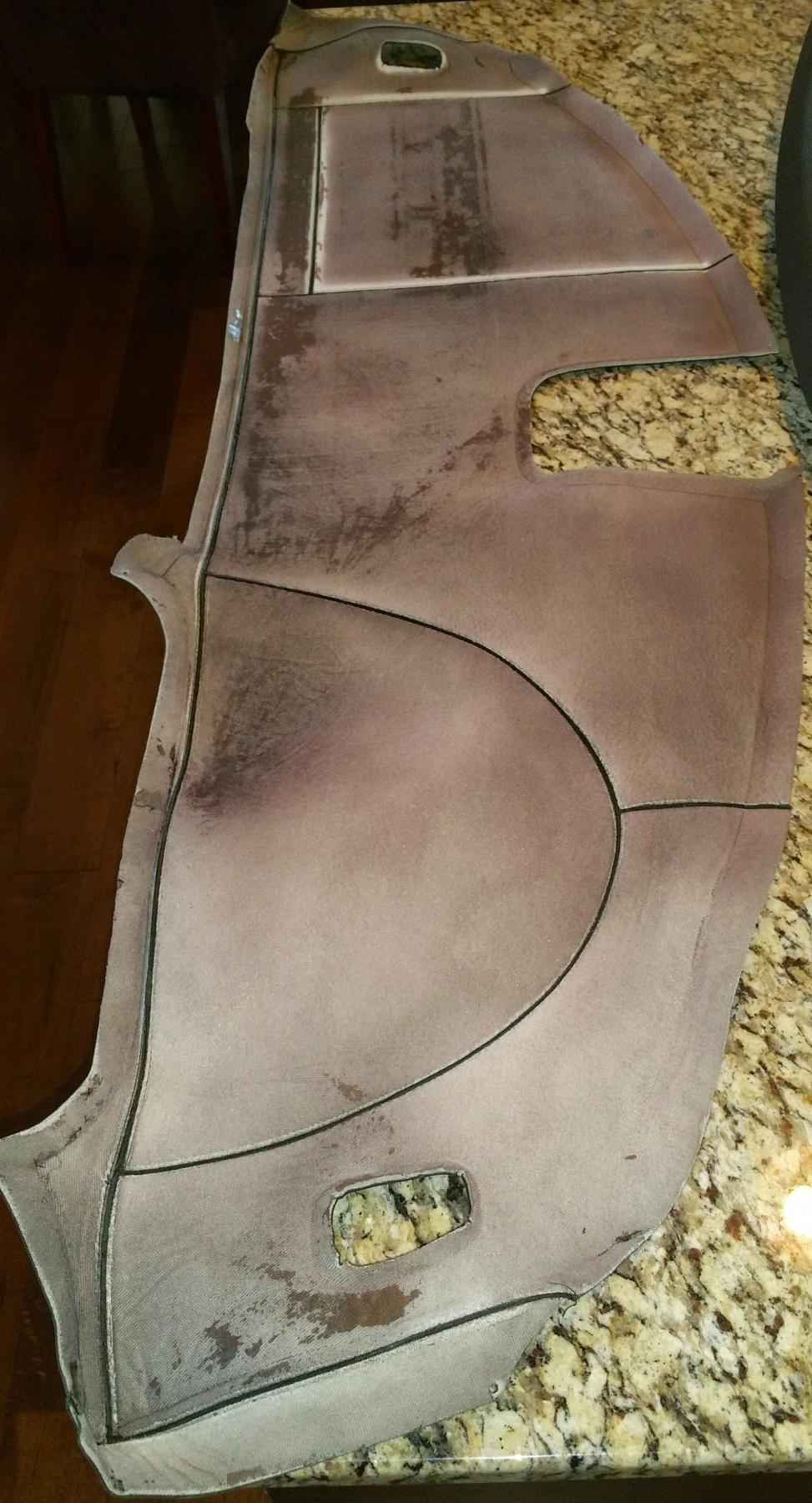

I received a $240 quote to remove and re-adhere the leather. I thought it was a little high so I pulled the leather off on my own. It's kind of a pain to get the leather/foam off the dash. The leather has a foam backing and both came off together. It probably took less time to remove the dash from the car than it did to peal the leather off the dash. You have to be careful not to stretch the leather or tear any of the seams.
I attempted to use some 3M spray adhesive to put it back together but it wasn't holding it down like I wanted so I pulled it off and cleaned all the glue residue off with mineral spirits. I'm going to bring it to the upholstery shop. I'm thinking the install cost will be cheaper now that they don't have to remove the leather from the dash. Hopefully I can give a update in a day or two when the leather is back on the dash and the dash is back in the car.
I could put together a how-to for removing the dash if people are interested. I took a picture of every single bolt/connector that I removed so I wouldn't forget any steps during re-install.
Attached Thumbnails bubbling dashboard on my XF-dashremoval04.jpg   bubbling dashboard on my XF-dashremoval05.jpg

Any reason why you took the whole leather cover off and not just pull pack the areas that failed and reglue?
I didn't want to have to do it again in a year or two. Chances are it would continue lifting over time in the other areas.

So that strip up against the windshield is plastic that looks like leather !!??

Man with the quality of the few pictures you posted I say yes! Please post your removal instructions.
This looks like another Jaguar repair that can range from thousands to a few hundred dollars depending on how much the owner is willing to do.
It does not look all that bad to remove the dash cover and take it to a upholstery shop.
Since you removed the foam from the leather cover will you replace the foam or just glue the leather back on the dash pad?
It is either vinyl or bonded leather.

The foam was not removed from the leather. The foam and leather are still firmly glued together and I don't see them ever coming apart. After a lot of research I found out that you can't use a rattle can spray adhesive. You need to use a high temp contact cement that usually isn't sold locally. If I end up doing the job myself I'd go with this kit: http://www.yourautotrim.com/1gadapwehhrc1.html I'll more than likely have a shop do the work though. I'm not confident I could get it on without having ripples or imperfections.
