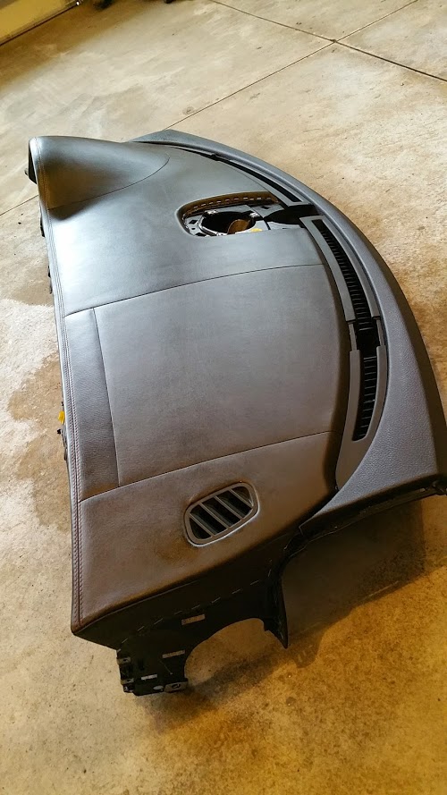

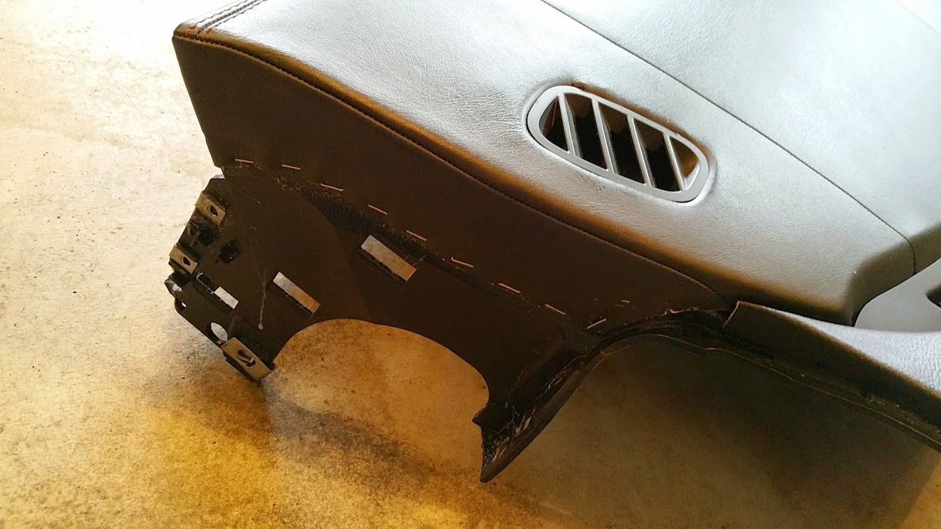

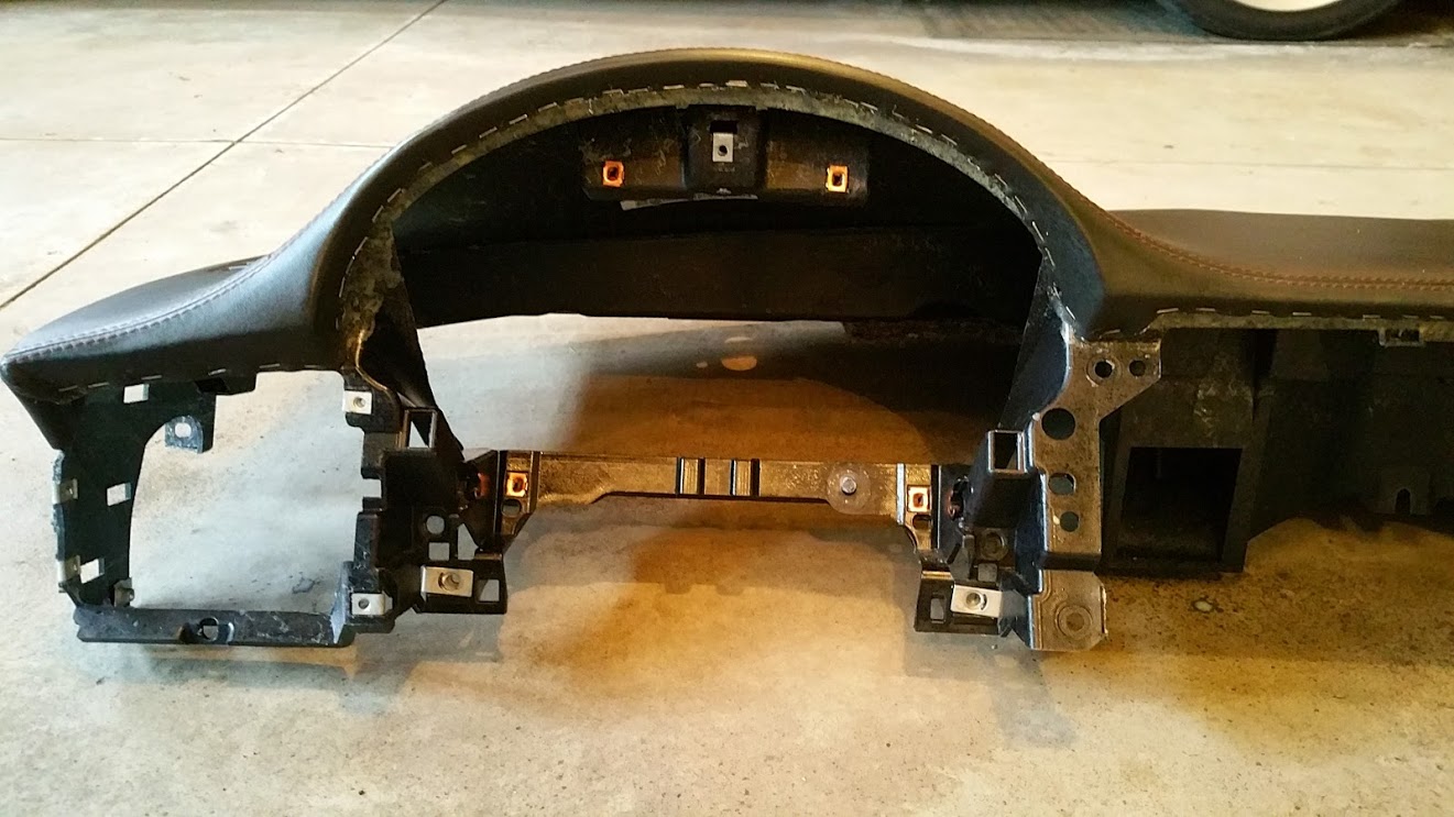

I found a upholstery shop that glued the leather back down for me. They charged me $120. I'm pretty happy with the results. It isn't 100% perfect but it's damn close. I had a seam start to pull apart above the cluster to the left (not pictured) so the upholstery guy put some glue in that area to keep it together and left a tiny bit of glue on the leather in that area. That kind of pisses me off but I'm working on getting that off. The seam issue is so small you'd never notice it unless I pointed it out. He shot staples in it all around the edges. I had to remove a few of the staples because they were visible after the covers were installed. I did get the dash reinstalled yesterday and it looks like everything is working so I must have done something right.
I asked how much it would be to re-cover the dash with new leather and he said it's somewhat difficult to get leather hides that are perfectly uniform. It would probably cost about $1500. At that point we might as well buy the new dash from Jaguar for $2500. The dash pealing up issue is pretty common in the industry right now based on the upholstery guy. They do some type of heat/vacuum press to stick the leather/foam to the dash. It isn't an adhesive.
I'll get a finished install picture later.

Ok….the fourth picture shows the lower right corner with the soft grain leather and the strip along the windshield that is definitely bonded leather….right !! I asked about this before and got no answer……it looks like two different finishes. Now after they replaced my dash I got just the opposite results. Go figure !!
