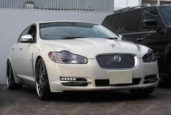

The LED BUMPER lights are also sold by IJDMTOYS. You can fine them under running lights..
