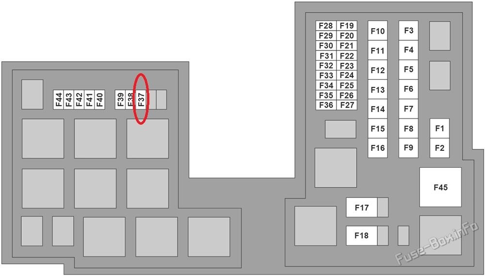

Fuse box under the hood. Remove fuse number 37. This powers the ignition system and without it the engine can't run.
Here is the fuse box;
Here is the fuse number layout with F37 circled.
This shows the V-6 version so I "think" I got it right?
Very strange problem that I have never heard of so report back if possible on what caused it?

I have pulled some fuses and then disconnected the battery. First I pulled the fuel pump fuse, then the ECU fuses.
It has rained the last few days, and the sunroof drain on the right side appears to have become plugged again. I cleaned it in the summer and thought I had it clear, but there was a puddle of water above the drain when I opened the sunroof. I took off the kickpanel in the footwell and blew air into some of the connectors and got a mist of water out, and the carpet is wet; so I'm suspecting water is where it shouldn't be and has taken down a network.
