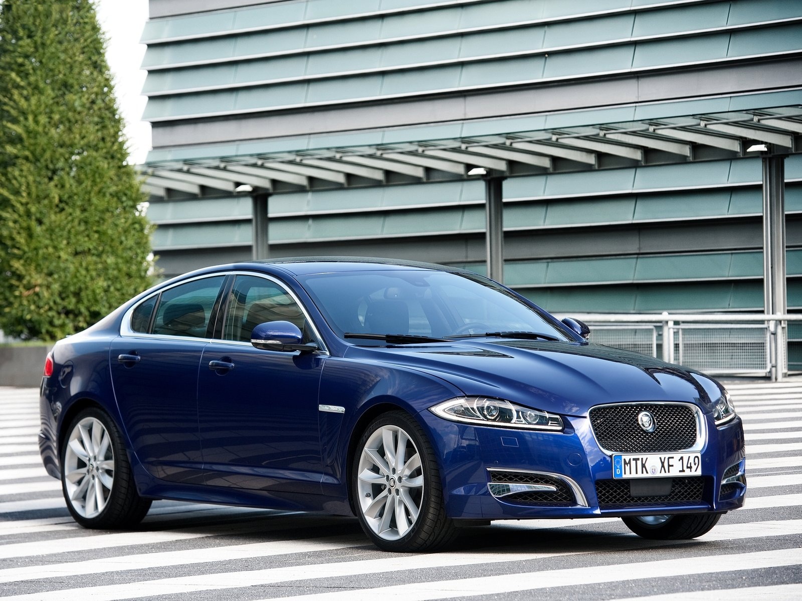

From: Empire State
Originally Posted by Dgianno
Thanks everyone for the responses. I neglected to give further detail.
Are you talking about the turn signals or the side markers?
The turn signals are clear, side markers aren't. Which is due to different regulations in UK vs US.
UK XF
US XF
If you want clear corner lamps, just purchase those lights on ebayuk
2011 JAGUAR XF O/S DRIVERS SIDE HEADLAMP HEADLIGHT XENON LED COMPLETE | eBay
