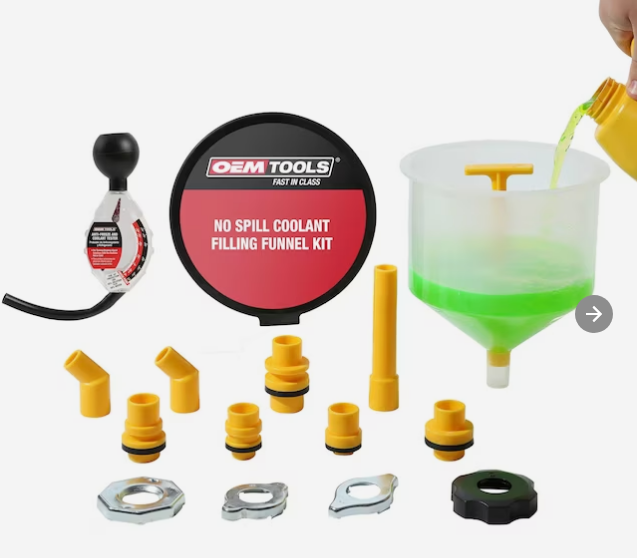

pick one of these up and do the bleeding process ,plenty of videos how to do it ,you may have hot air pockets, ill be posting a video how to

If you have run long journeys it's unlikely to be air in the system, I have swapped lots of these engines (5.0) and they self-bleed pretty well, causing fluid level to drop if anything. Also in my experience the first sign of a failing head gasket is that the heater stops working.

Just a suggestion, to rule it out,I had to run mine for 20mins to get the air out
