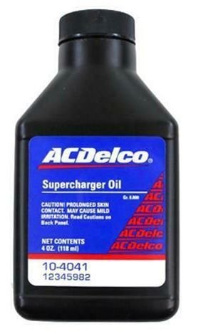

Wow! If the dealer claims the SC uses engine oil they are completely clueless about SC's in general and even more clueless about Jaguar SC's. 100% the SC has and uses separate oil and there is NO connection between the oil in the engine and the oil in the SC! You will quickly ruin your SC if you fill it with engine oil.
Again as I posted above use the correct AC Delco SC oil. It's cheap and available nearly anywhere. Get it changed as it does need it.
You need to listen to your engine on shut down to see if it has the snout noise. Turn the radio off and open the drivers door with the engine at idle. Now shut off the engine and listen. It will be obvious if you have that noise. If you want to be 100% sure then remove the SC belt and do the same thing. With no belt the SC can't make any noise. No this won't hurt anything either.
If you had all those parts replaced in the past I can't say if they need to be replaced again or not. $5800 is a massive bill so it's up to you. Do you have any paperwork so you can see how long ago this stuff was replaced? If it was 2019 that was 5+ years ago.
Yes the Symposer is just an add on device and no harm if it's not removed and no harm if it's removed. Again up to you. I removed mine but since I do all my own work it did not cost much to do.
I will go back to them and tell them about this. Kinda surprising they don't know this info (makes me think the service advisor just said something without confirming). Thank you for the picture!
