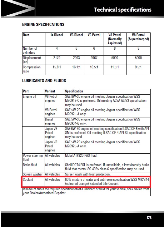

Just checking for my 2011 XFR 5.0 SC. IS this the proper coolant number WSS M97B44 ?

There's a phrase I never use on the forum .....

All modern Jag petrol engines use the same spec of coolant.
