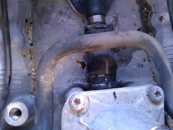

Okay, so I searched and re-searched through the threads and found a $14 hose (throttle body coolant return line) that may be the problem and it's here.
Today, however, marks the third day I'll be trying to figure how to get access to the throttle body bolts and the other various connections at the top rear of the engine necessary to be removed to access the rear two S/C bolts. There must be some secret to this as others have successfully pulled all this stuff off in order to pull the S/C and access the suspect hose.
If you might know that secret, I'd like to be among the friend with which you share. Pretty please.

It only took three days of fiddling to get to the culprit hose, and, yes, it was a leak in the hose as expected.
And then a day and a half of reassembly to the point where everything was reconnected and refilled, but now I have a misfire on three cylinders and a MAS/IAT error code. Trying now to figure out what I did to generate the misfires.
