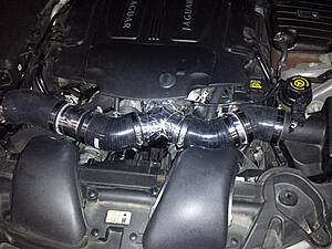

After I found that my air intake Y pipe had cracked around the throttle body join (engine + Texas heat, I'm guessing) and finding out just how much Jaguar wanted for a new one (don't ask) I decided to replace the air intake pipe with a custom one.
So, armed with:
  • A 3.0" Silicon Hose Coupler (eBay)
  • A 3.0" to 2 x 2.5" Aluminium Y Pipe (eBay)
  • A 30 degree bend 2.5" silicon elbow (Silicone 30)
  • 3 x 45 degree bend 2.5" silicon elbows (eBay)
  • A length of 2.5" diameter aluminium piping (eBay
  • Heat-reflective silver tape (eBay)
  • A couple of different sized threaded pipe take offs + rubber pipe lengths (Autozone)
This is what I came up with:
Custom air intake for 5.0 v8 Supercharged - made a big difference!-gzrnv1c.jpg
(Apologies for the poor quality cameraphone picture).
I'm staggered at the difference it made - the car seems to breathe a lot easier and pulls like a train. More induction noise too, which I see as a bonus
One thing I will say is that heat soak in this engine bay is really bad, which is firstly why the heat-reflective tape is so necessary, but also why I've stuck with the stock airboxes (with K&N filters).
Oh, and the 30 degree bend is the one on the far left-hand side of the photo.
I'll try and get some more details up if anyone is interested.

Nice job. I build/sell custom intakes for the 4.2L Supercharged XF. It's too bad the piping for the 5.0L engine is such a pain to route. Is there a breather line on the 5.0L that you had to tap into your intake piping (there is on the 4.2)?
In my opinion I'd ditch the tape and look into a way to coat the aluminum piping to reduce heat. A high temp ceramic paint might be an option. This is the first thing that popped up after a quick Google search: KBS Coatings 65303 KBS Coatings Xtreme Temperature Coating/Heat Resistant Coating - Free Shipping on All Orders @ JEGS

Wow, great minds think alike! I've already got the aluminum Y and straight pipes off eBay (cxracing), but haven't yet purchased the silicone connectors.
What did you use for a connector to connect the two recirculative breather hoses (not sure it's called that) to the intake piping?
I agree about heat soak. I've simply removed the engine cover to allow the heat to dissipate a bit better. Yes, our heat exchangers are ugly to look at, but I'd rather take ugly over heat soak

Just be careful because without any dyno numbers we are all guessing. Many mods on many different cars have proven to be of little to no value after actual measurement.
Yes, there's two - a small one that goes to the supercharger actuator and a bigger one that goes.....somewhere (I forget where now). I've tapped them into the silicon elbows with sealant (no welding required then) - you can see them on the engine side of each elbow closest to the Y pipe.
That is a fantastic idea, love it. It would look a lot tidier than the tape, which was functional rather than asthetic, but asthetics are important. I'll look into it

I've heard this too, although it must be said that there are sections of the stock pipe that are definitely a lot narrower than others. I assume these sections, along with the random plastic "L-shaped" additions to the pipe, are likely to be there to reduce induction noise, though I guess we won't know if this is at the expense of intake efficiency or power, though I'm willing to bet it is.

Possibly an aftermarket pre-supercharger chargecooler? Having said that, space at the front of the bay (where the intake is) is tight to say the least...
I used threaded pipe barbs off eBay. I can dig out the auction numbers if you're interested, though my measurements were a bit off and I needed new rubber hose from Autozone :P All came together well in the end though.

Be careful with tapping into the silicone couplers. It's hard to keep those leak free after a ton of heat cycles. A port welded on to the aluminum pipe is the best idea but it's likely too expensive and fitment might be an issue. Keep an eye on it.
I am still working on building intake scoops to help direct the air into the duct work from behind the grill. It's a common mod on BMW's and they have similar duct work that pulls air from up above just behind the grill. I think it would be a easy bolt on piece worth adding to any XF. Here is what they look like on a BMW:
I would agree about tapping silicone couplers. I'd suggest trimming an inch off one of the driver's side 30* couplers and using a longer piece of straight aluminum tubing to give you a place to put in your tap.

Another option is header wrap. I can speak from experience with turbocharged engines that wrapping the charge pipe in header wrap REALLY cuts down on heat transfer into the charge pipe. Obviously the intake doesn't contain charged air, but why allow it to absorb more heat than necessary. The benefit of using header wrap is you can wrap the entire intake to hide all the connectors. But always use titanium header wrap. Fiberglass wrap degrades too quickly.

Your parts list show you used 3" and 2.5" pipes and couplers. I measured my N/A 5.0 TB at 3.5" OD and the air box outlet at 3" OD. Is the Supercharged parts really smaller than the N/A parts?
Yes, you're totally right. Good spot! I can't edit the post now for some reason
