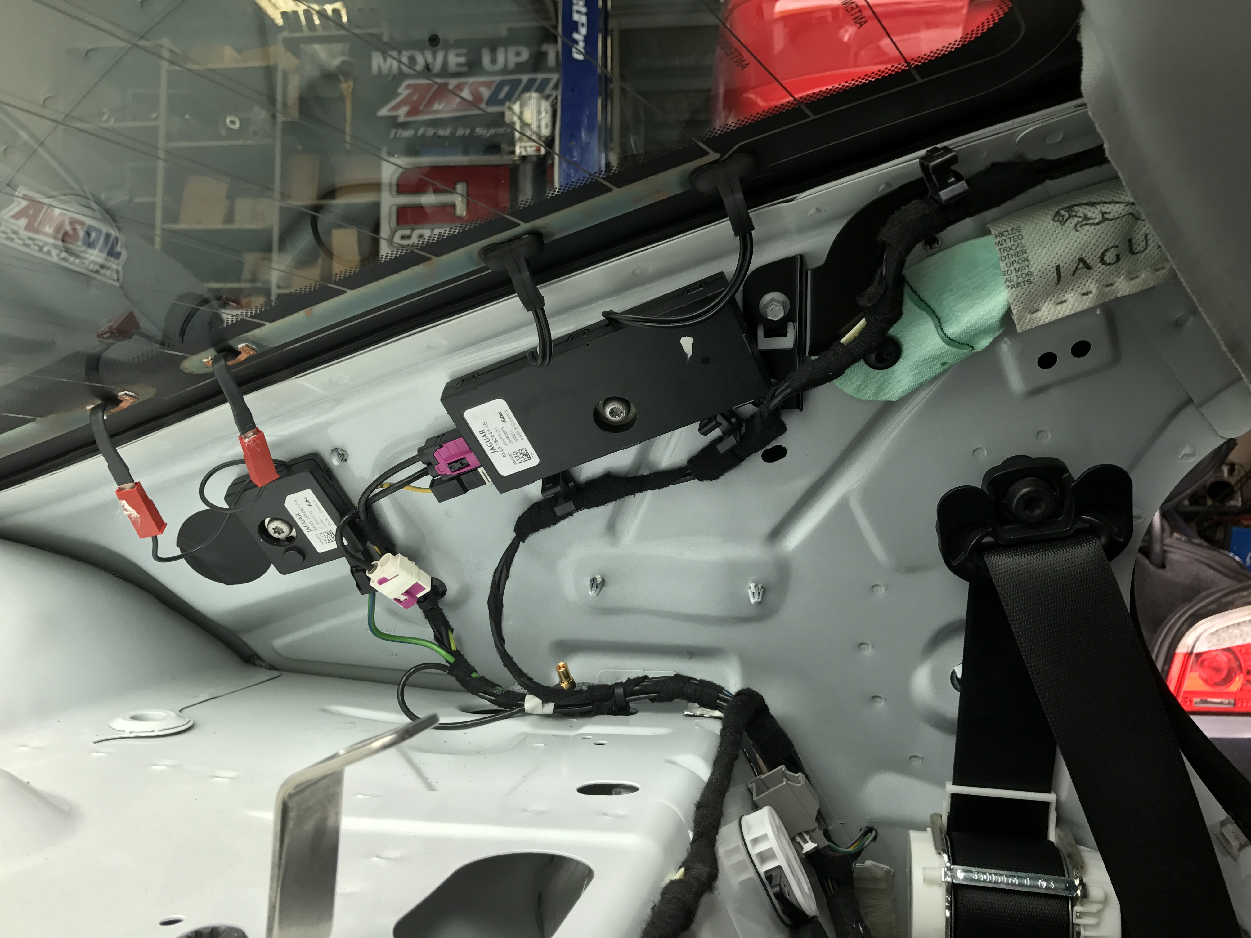

The factory DAB radio can be retrofitted however it is not plug & play, it will need some programming changes to enable it.
The wiring for the module may or may not be present, you would have to remove the left c-pillar trim to check if the antenna wiring is there...
I found on 2011MY the wiring was there, on 2014MY was missing, not sure about 2012MY.
Pre-wired in 2011MY
Not pre-wired in 2014MY
If you can pop off the trim panel and take a picture, I can tell if it's pre-wired or not...

Hi Many thanks for the speedy reply, I have inserted my left hand C pillar images
is this the correct wiring loom?
Old Jun 3, 2017 | 06:04 PM
Cambo's Avatar
Joined: Jan 2011
Posts: 8,637
Likes: 4,526
From: Sydney, Australia
Thanks for the pic!
OK so that is the same as the 2014MY I worked on before, the antenna wiring is missing. Not a big deal since I can make up the antenna wiring, have done this for a few cars now.
The usual location of the DAB module in these later cars is under the left front seat, which is a bit of a pain as you need to remove the seat to get access, and running the cables to there under the carpets also sucks. It is easier to mount the module in the boot instead, left hand side where the audio amplifier is located.
The components you need would be;
DAB module
DAB module power cable (tapped into the power source of the audio amplifier)
3-way MOST fibre optic splitter
Custom antenna cable
Combined FM & DAB antenna amplfier (replaces the black FM amplifier in your pic)
But the real challenge is that it won't work without some software changes, the CCF must be updated to enable the DAB functions. I don't have any contacts in Ireland who can do this, only in England or Scotland...
