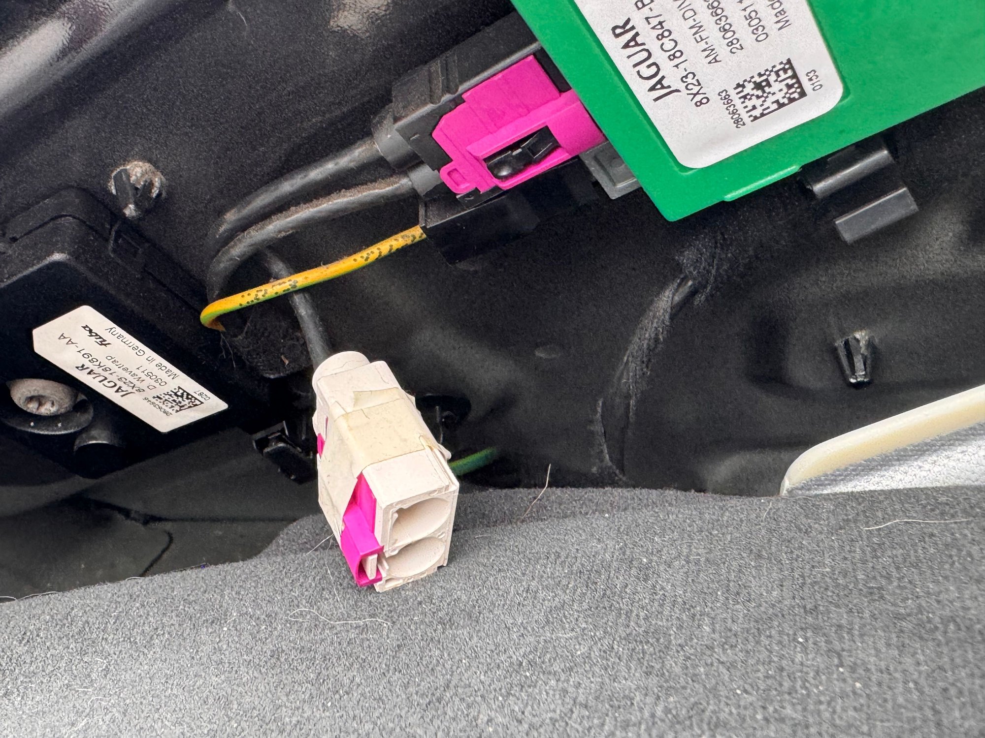

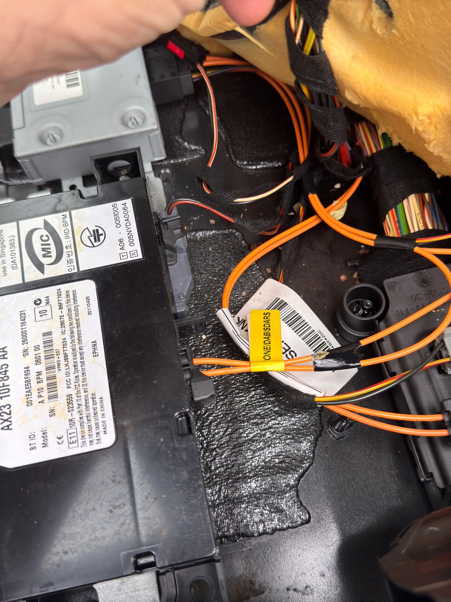

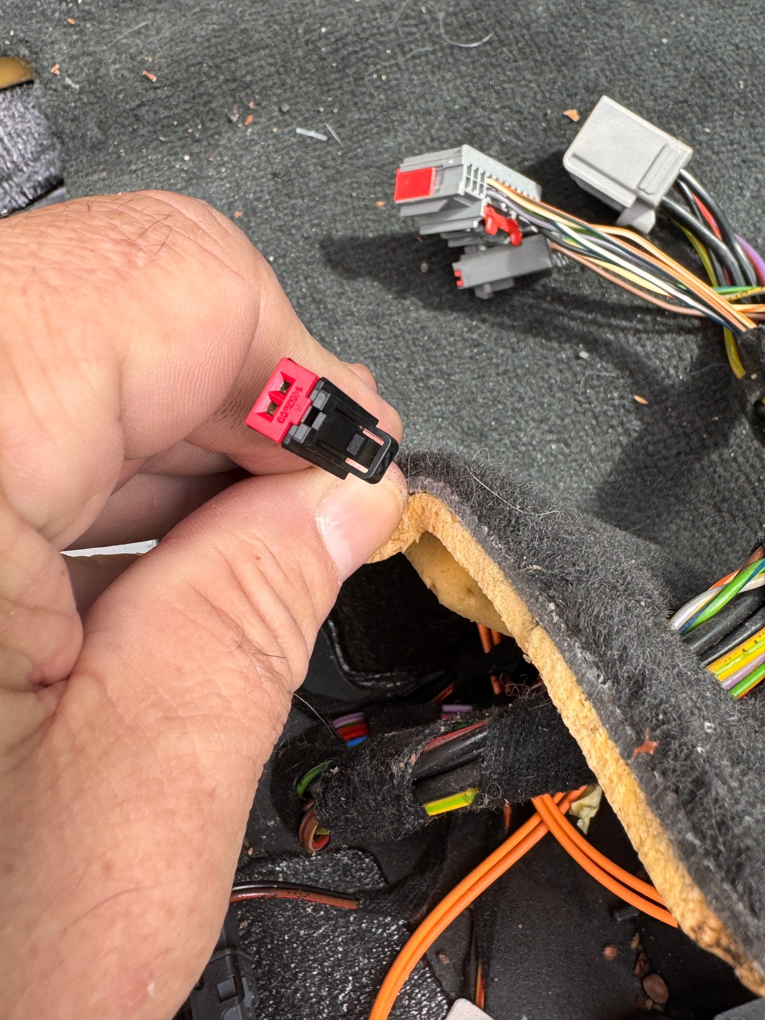

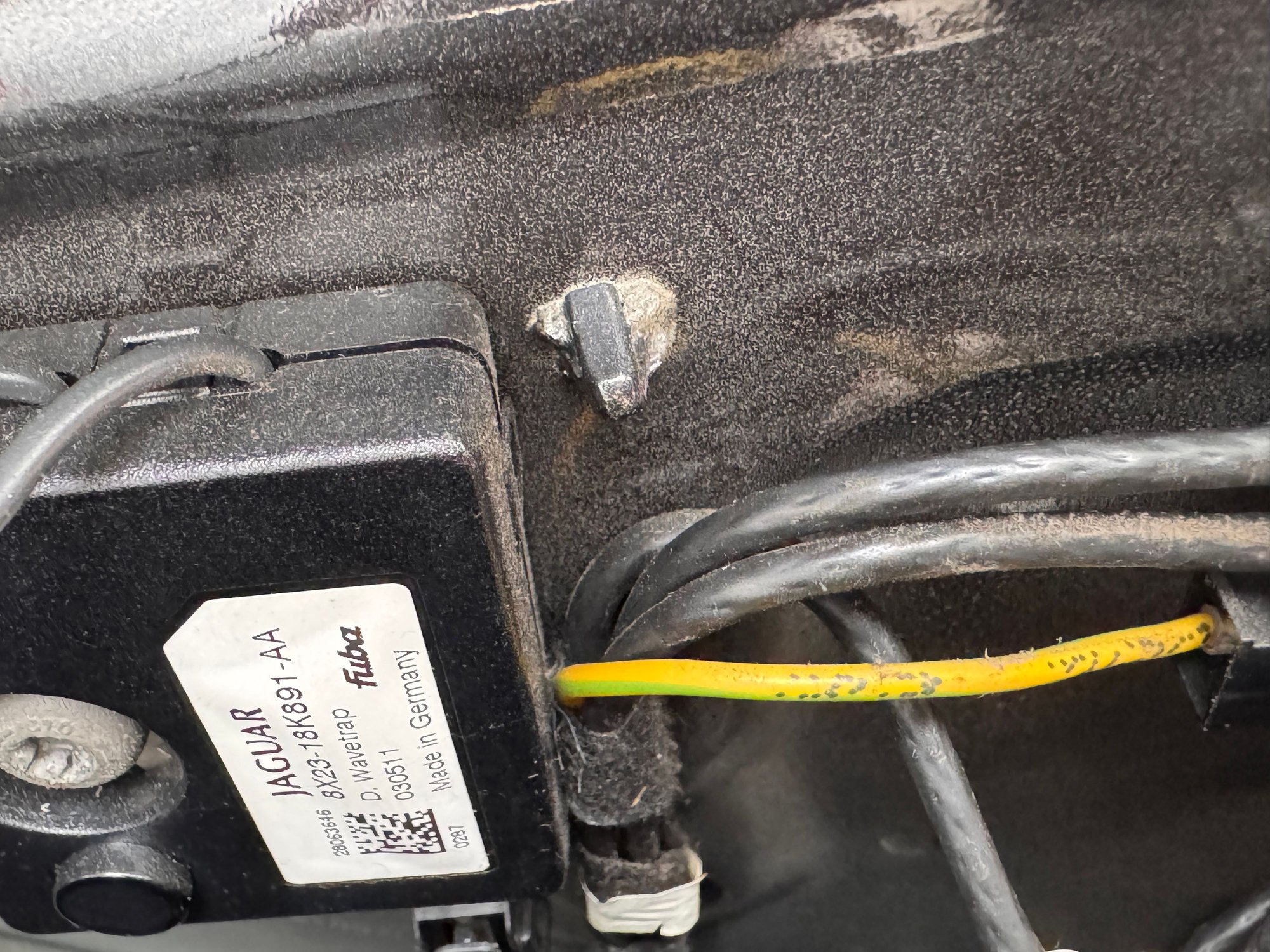

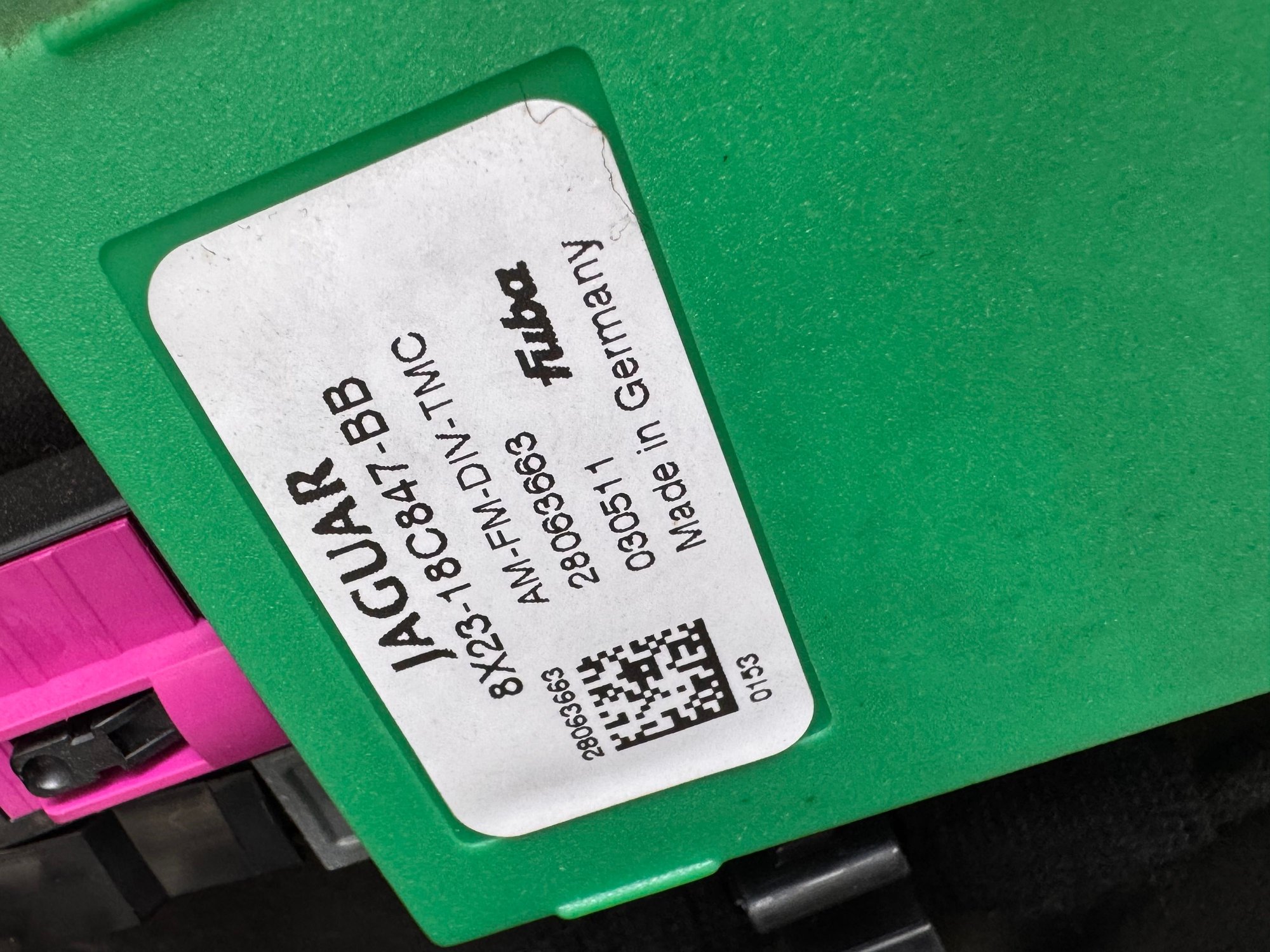

I came acoss you post about adding DAB, I have a 2011 xf preface lift that I,m looking to retro fit with DAB. I just need a shopping list. I really wanted to ask you about the pre wiring. looking at the picture below can you tell me if this will be straight forward or not

Originally Posted by Cambo
Welcome to the forum!
The factory DAB radio can be retrofitted however it is not plug & play, it will need some programming changes to enable it.
Attachment 147827
The wiring for the module may or may not be present, you would have to remove the left c-pillar trim to check if the antenna wiring is there...
I found on 2011MY the wiring was there, on 2014MY was missing, not sure about 2012MY.
Pre-wired in 2011MY
Attachment 147826
Not pre-wired in 2014MY
Attachment 147828
If you can pop off the trim panel and take a picture, I can tell if it's pre-wired or not...
