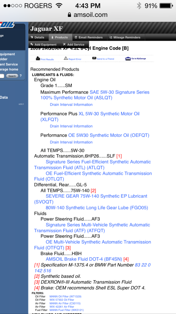

I just ordered some amsoil severe gear 75w140 for my rear diff. Multiple online sources say that 75w140 meets the m2c 192a spec, although I'm trying to get confirmation that the severe gear oil meets the spec as well (as opposed to the regular amsoil gear oil)
An amsoil rep emailed me saying that the severe gear meets the spec although the viscosity guidelines for the m2c 192a spec indictate that an 80w90 fluid is required, which makes no sense to me. Is anyone successfully running 75w140 amsoil severe gear in their rear diff?

Found this on the amsoil website. This alleviates my concern
